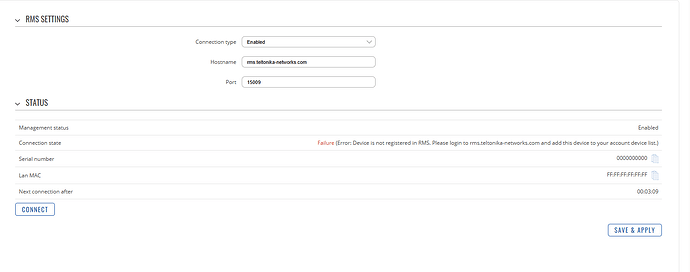

Have a device which suddenly disappeared from RMS.
When we finally accessed the device, it says under RMS, the device is not registered.
Also Serial Number is Zeros only, MAC address is displayed as FF:FF:FF:FF…
Resetting didn’t help.
Here’s how connection details look.

The issue has been resolved by downgrading the firmware to 7.02.5 and updating the information of the device, afterwards upgrading the firmware back to the latest.
