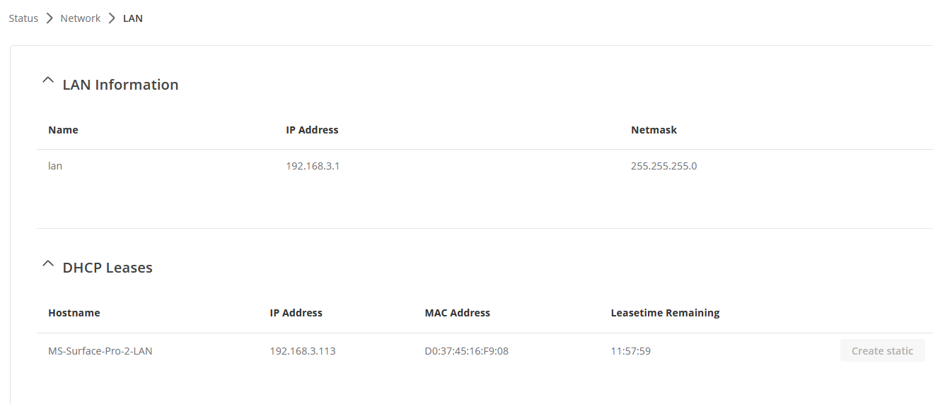

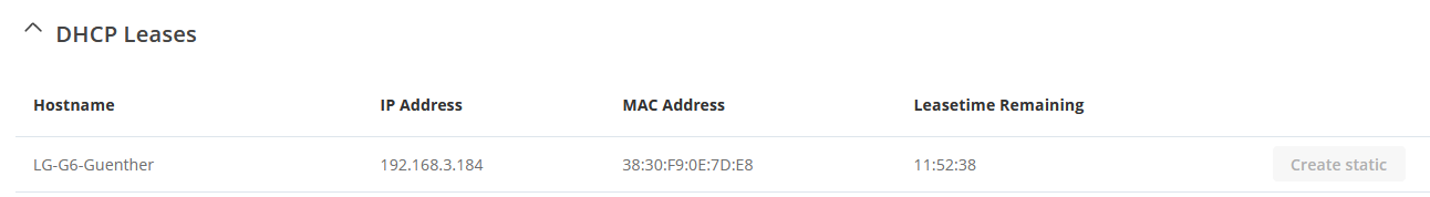

Now, for testing purposes, I deleted the entry in the RUT955 under the Network>DHCP menu, entered it again and then rebooted. Registering my mobile phone again on the RUT955 resulted in the same IP address (192.168.3.184 instead of 192.164.3.110) under DHCP Leases in the Status>Network>LAN menu. And now comes the strange thing. I have configured other devices in the RUT955 with IP-MAC binding and they work correctly.
In the next step, I configured the IP address 192.164.3.117 instead of the IP address 192.164.3.110 and rebooted again. The highlight: the IP address 192.168.3.184 is assigned again.
This leads to the conclusion that the MAC address of my mobile phone and the IP address 192.168.3.184 are somehow in a relationship, means the problem is probably induced by the MAC address itself.

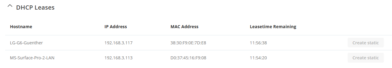

The latest status was the configuration that I had determined via SSH config host (IP=*.117). You can find the screenshot above.
I just connected my mobile phone to the router and received an event message via email that showed the correct IP address *.117.
Now I thought: well, the error has disappeared :=)).

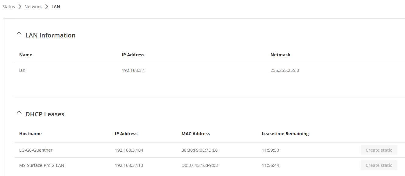

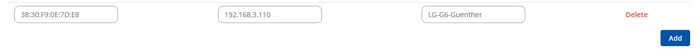

Full of hope, I then reconfigured the router for my mobile phone to the originally desired IP address *.110 and rebooted the router to get rid of all leases.
Hello Marijus,
thanks for this very practical extension of issue life time.
So I can add another screenshot of my latest configuration.
I hope you now can asses that there is something wrong with the Firmware!
