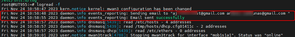

I have tried to replicate this issue on my RUT955 with v7.05 FW installed, but was unable to.
I have successfully received both emails.

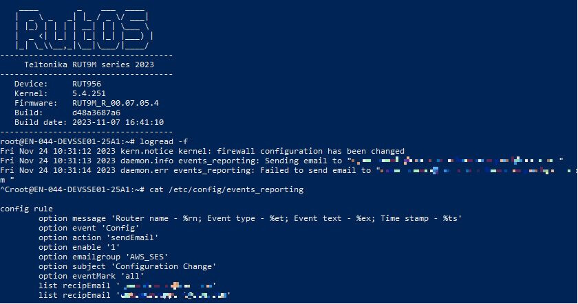

Could you please access your device via CLI/SSH (username ‘root’), execute the following command, and share the output here? Before sharing the output, please blur/hide your email addresses.
cat /etc/config/events_reporting
Hi AndzejJ
Thanks for getting back to me. Output below:
Kind regards
Chris
