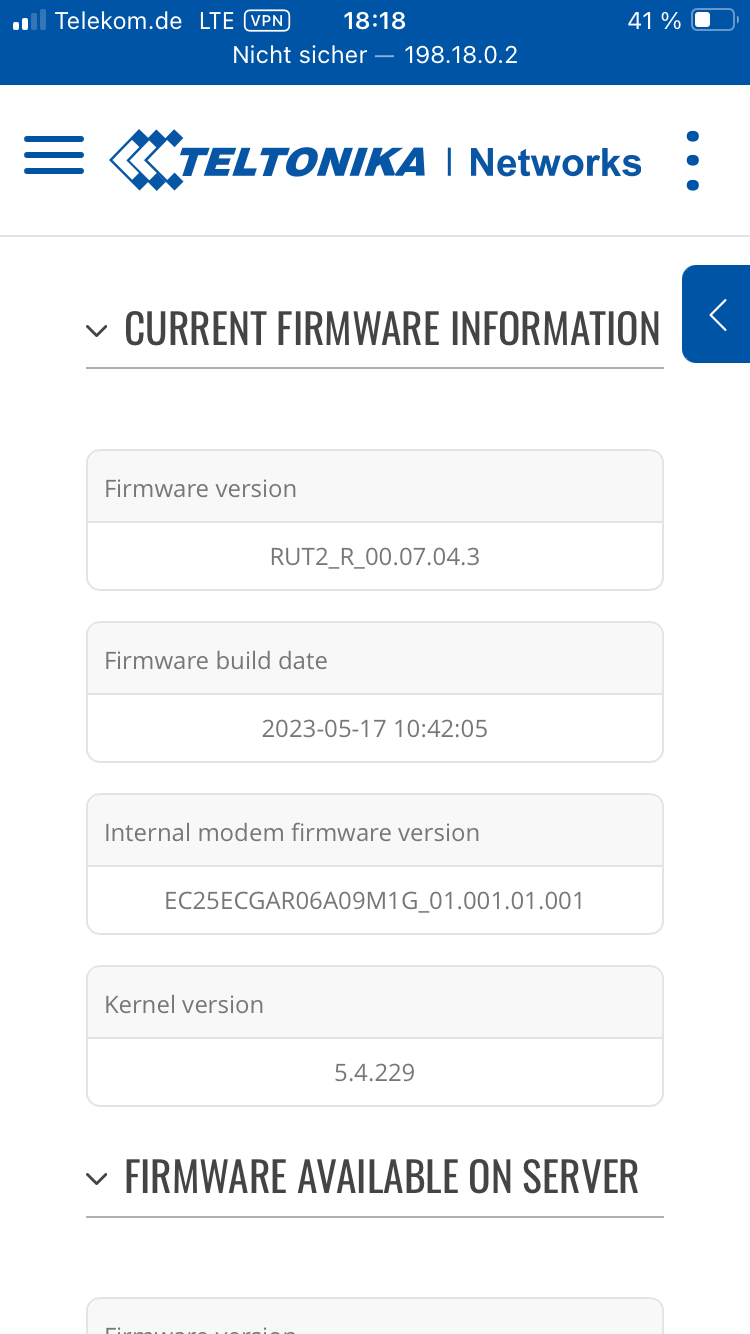

What firmware version do you have installed on your device?
Can you share a screenshot of your configurations?
Do you mean this configuration?
Hello Andzei, now with FW RUT2_R_00.07.06.6 but still same error.
