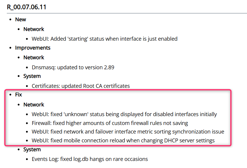

I’d rather say - go for latest firmware version for RUT950 (at the time of writing it’s 07.06.11) as it seems that Teltonika fixed something there?

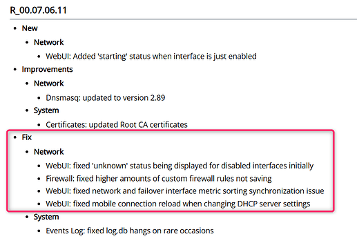

Bullet point #3 under ‘Fix - Network’?
Well, since I haven’t experienced any other issue with RUT9_R_00.07.06.10, and since I’ve already solved the failover bug my way, I’ll stick with this firmware as long as there’s nothing else to be fixed.
I’ve wasted enough time tracking bugs by myself
Thanks for the heads up though.
