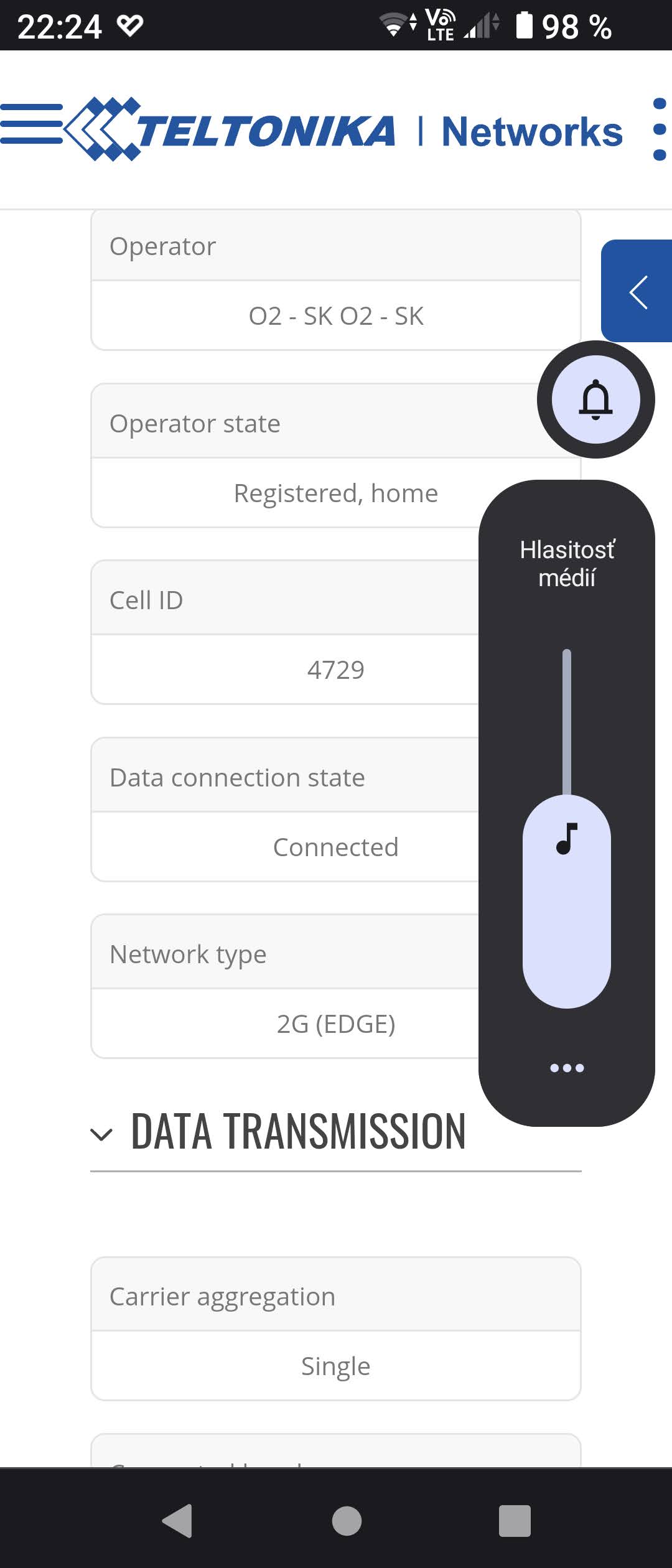

2023-08-07 22_38_37-IP Range - Angry IP Scanner
From the screenshots it can be seen that your device connects to a 2G network, thus the connectivity issues.
It is possible that the 4G coverage in your area is poor.
Please, navigate to Network → Mobile and try setting the network type to 4G only. Does the device connects to 4G then? If so, what are the signal parameters?
If possible, you can try using a SIM card from a different operator for testing purposes.
