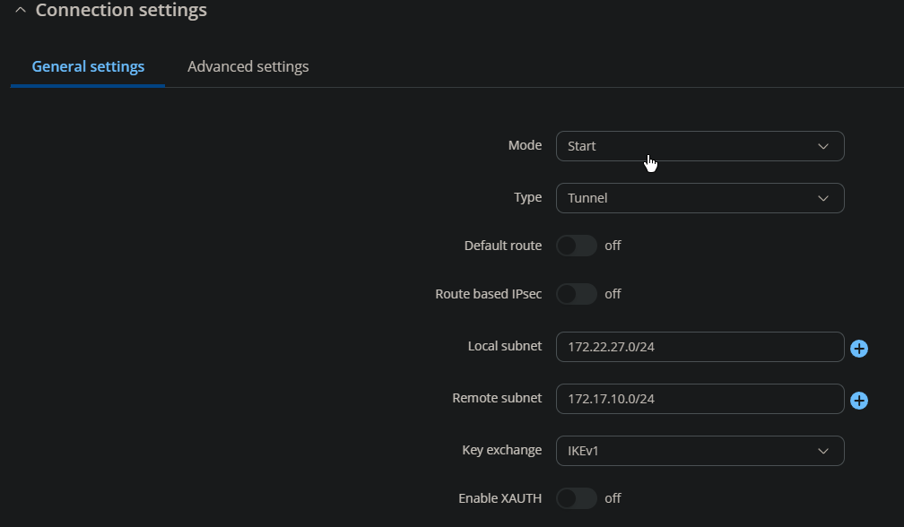

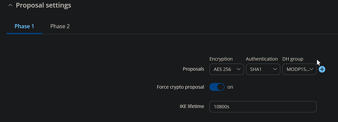

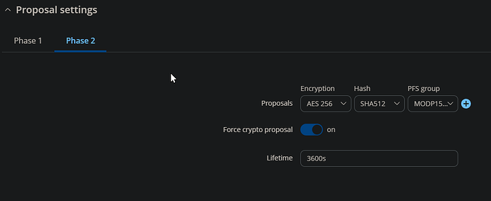

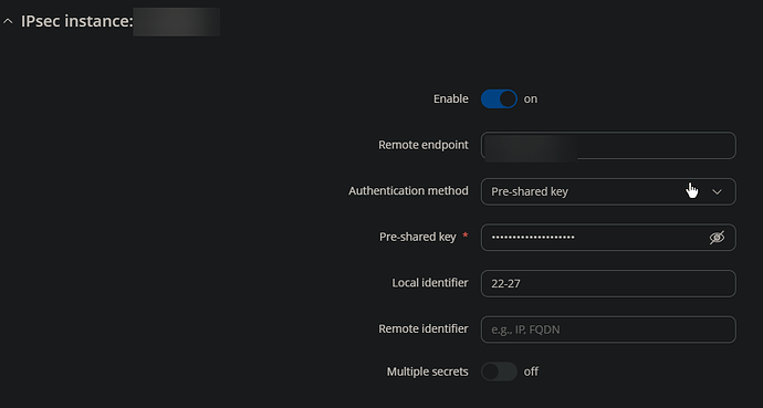

for reference, I have attached my current IPSec config

Our developers are aware of the IPsec issue and are actively working on a resolution. The fix will be implemented in future updates. Unfortunately, I don’t have an exact release date, but I will keep you informed if I receive more information.
Thank you for your understanding and patience.
Thanks Marija for the update, I will wait for the next firmware release.
