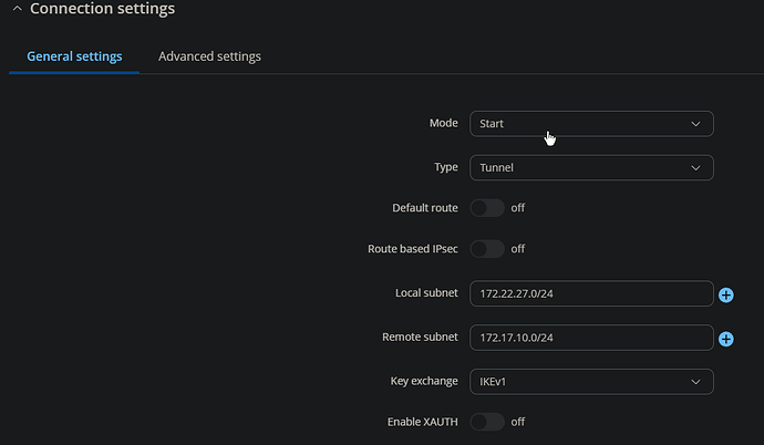

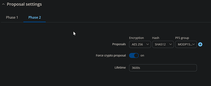

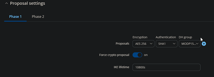

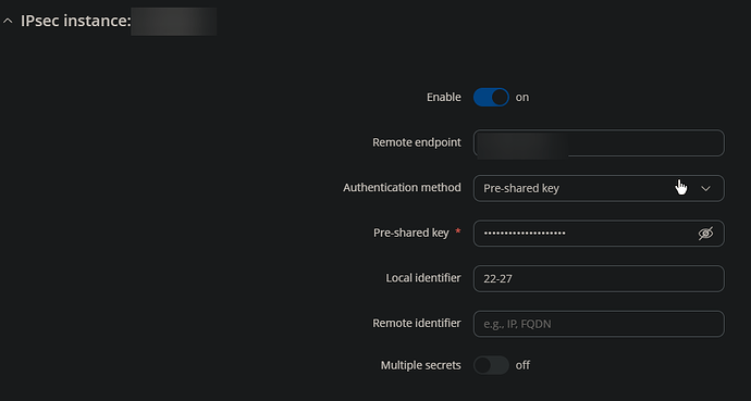

So far, I have encountered the same problem accessing the webserver of the router via IPSec tunnels from all firmware version from 7.12 to 7.14. I keep having to downgrade the firmware version to 7.11.
Since the original topic did not have a definite solution, is there something in the tunnel configuration I need to do differently on newer firmware versions?
For reference, the current config is as pictured:

Thank you for the suggestion. That gave me some ideas. The problem was with port scan prevention. Turning this feature off and I can access the web UI remotely again.
Perhaps the problem was with me binding the web UI to port 8888 and port scan prevention has been more aggressive than before.
