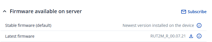

I’m on the lasted firmware:

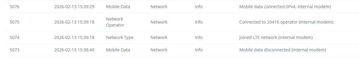

AI summerized the times and date. As shown below, it’s not exactly the same time.
Date Mobile data disconnected Joined LTE network
2026-01-20 15:59:11 15:59:50
2026-01-21 15:56:19 15:56:54
2026-01-22 15:52:32 15:53:04
2026-01-23 15:49:00 15:49:31
2026-01-24 15:47:21 15:47:50
2026-01-25 15:47:16 15:47:46
2026-01-26 15:47:33 15:48:09
2026-01-27 15:47:35 15:48:09
2026-01-28 15:44:00 15:44:35
2026-01-29 15:43:35 15:44:12
2026-01-30 15:39:06 15:39:39
2026-01-31 15:37:20 15:37:49
2026-02-01 15:36:17 15:36:47
2026-02-02 15:36:15 15:36:59
2026-02-02 15:51:53 15:54:38
2026-02-02 15:52:06 16:21:08
2026-02-03 15:49:05 15:49:39
2026-02-04 15:48:54 15:49:32
2026-02-05 15:49:14 15:49:47
2026-02-06 15:49:06 15:49:41
2026-02-07 15:46:10 15:46:39
2026-02-08 15:44:08 15:44:38
2026-02-09 15:44:04 15:44:43
2026-02-10 15:42:15 15:42:51
2026-02-11 15:41:23 15:41:55
2026-02-12 15:41:25 15:41:55
2026-02-13 15:38:40 15:39:18
2026-02-14 15:33:54 15:34:24
2026-02-15 15:32:25 15:32:55
2026-02-16 15:29:19 15:29:55
2026-02-17 15:28:25 15:28:59
2026-02-18 15:23:55 15:24:31
I’ll also post on the providers forum. I’ll let you know if anything changes
