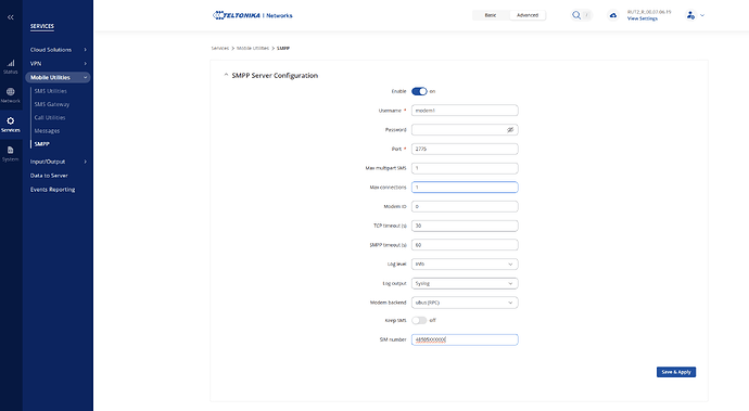

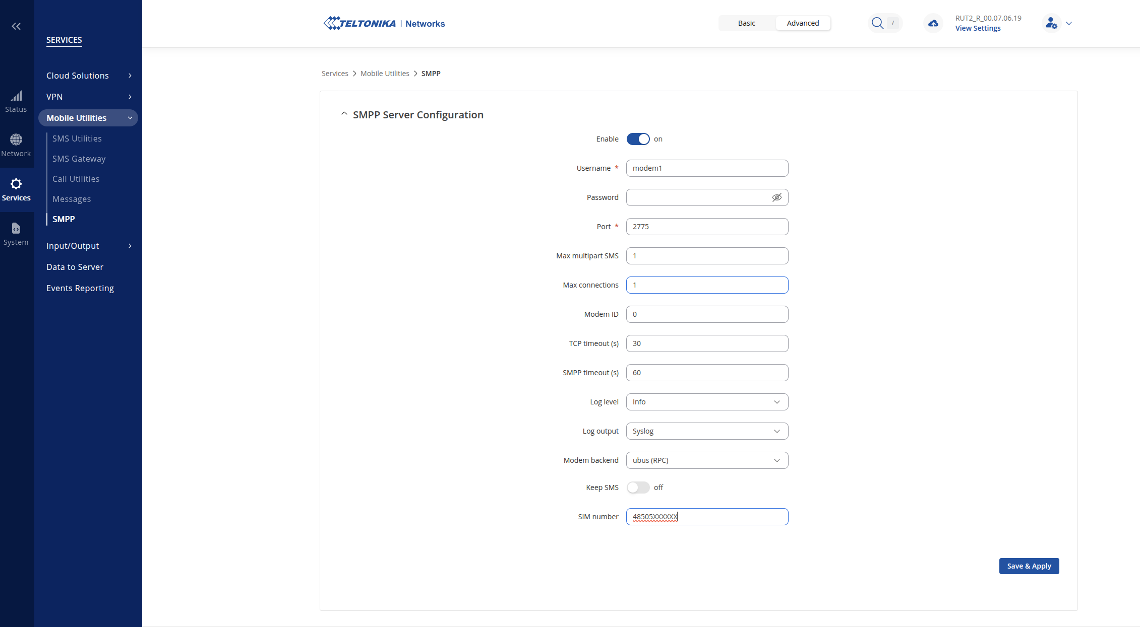

That’s how it looks:

Hi @csiwekk
this looks truly amazing.
