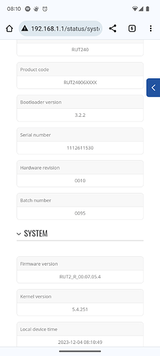

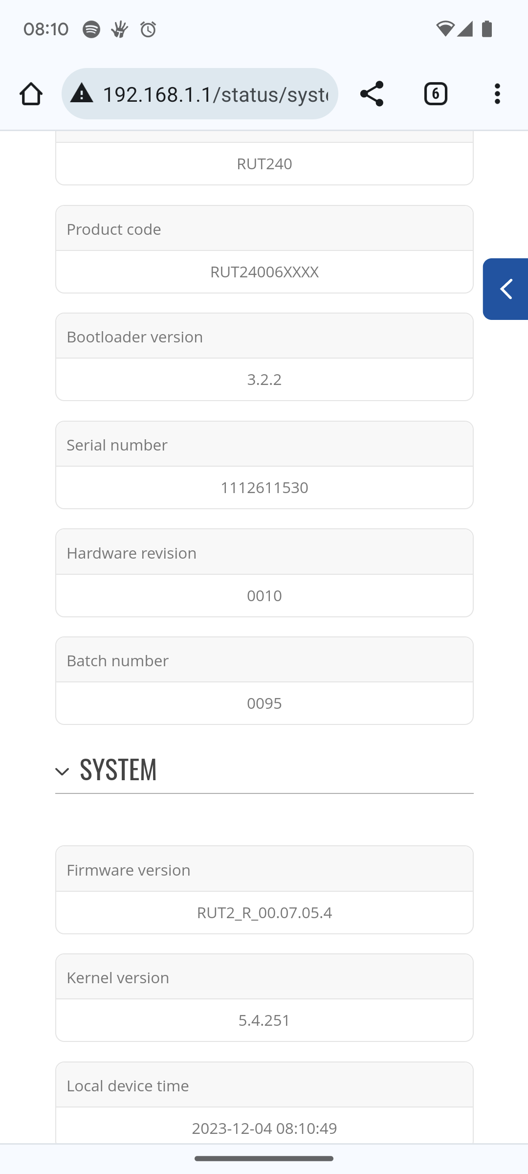

The RUT240 has the latest firmware. In the systemlogg i got an entry “.usb supply vbus not found, using dummy regulator” can this be the problem? The earlier FW had problem with dataspeed och constant hangs och data dropouts so i upgraded the FW to the latest version.
What firmware version is installed on your RUT240?

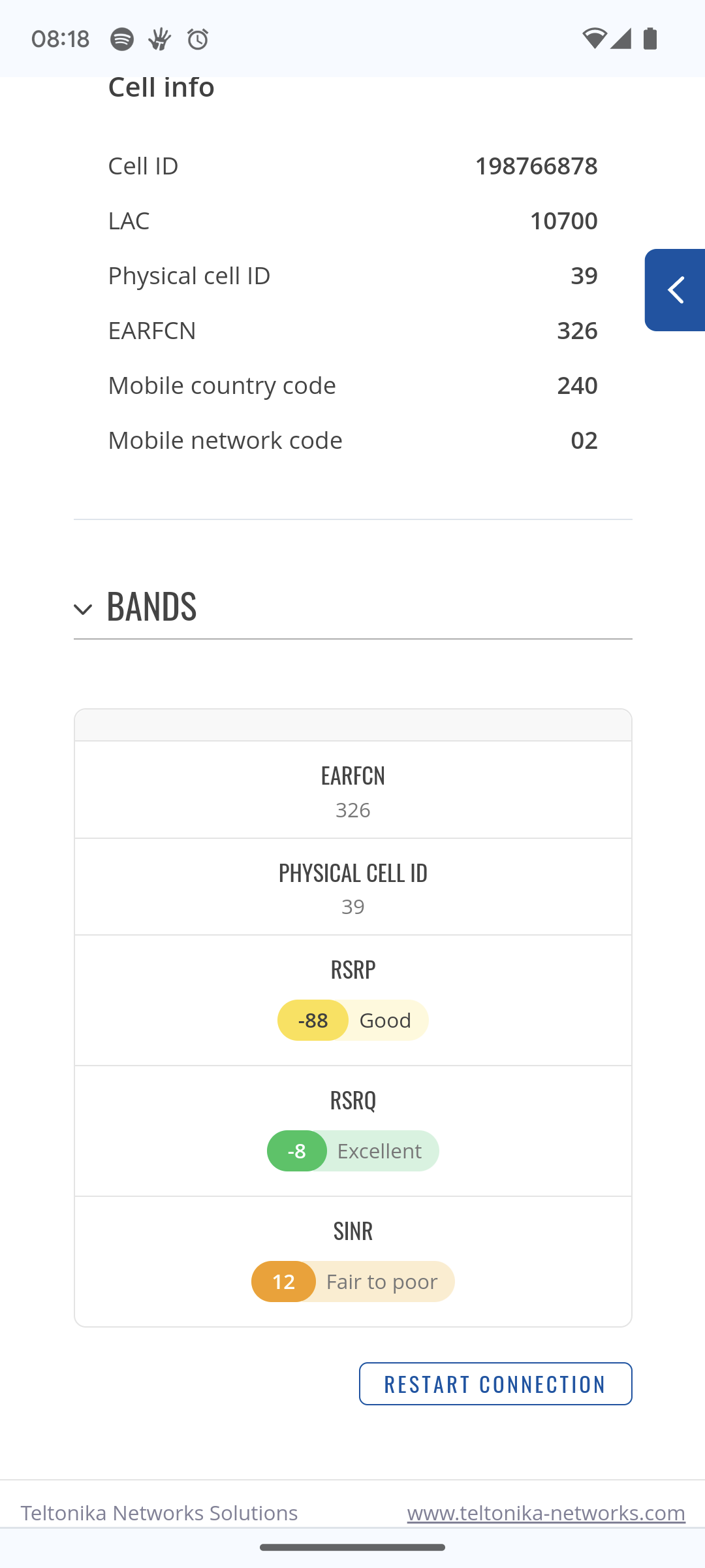

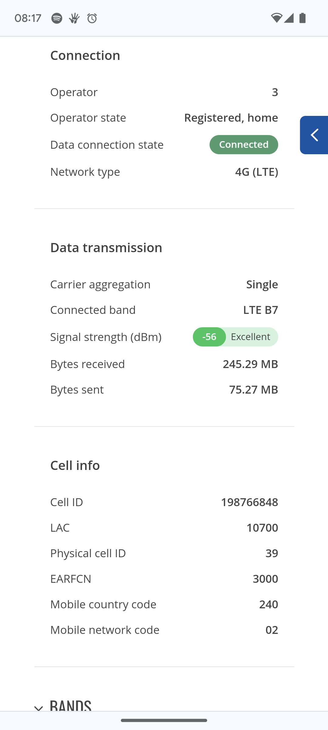

Also, what are the signal parameters in Status → Network → Mobile? Could you please share a screenshot here? Before doing so, please hide any sensitive information, such as IMSI, ICCID, Cell information, etc.
Another thing that I would like to mention is that the RUT240 will not be able to achieve the same speeds as your mobile phone. For more information, I would suggest checking these forum posts here and here.
