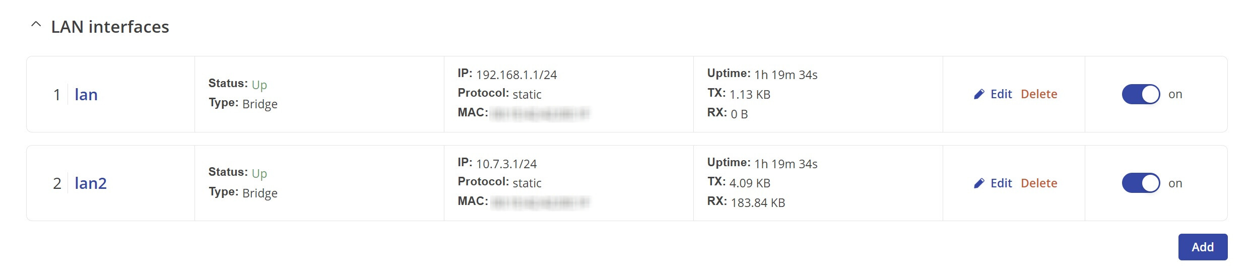

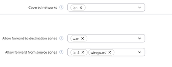

This is ma LAN configuration:

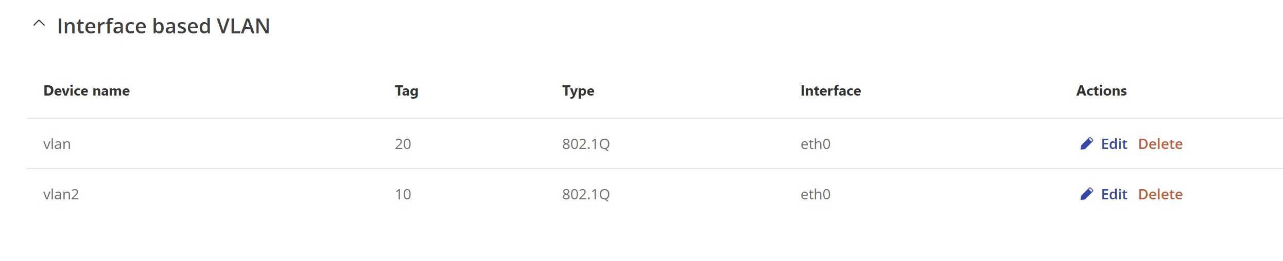

Here my VLAN configuration (it goes to a NETGEAR GS308E):
Here my FIREWALL configuration:
Here my TRAFFIC RULES configuration (default):

The Allowed IPs values look correct. Idem for lan, vlan and traffic rules.
Could you show the:
  • Covered networks
  • Allow forward to destination zones
  • Allow forward from source zones
    values for all the firewall Zones=>Forwarding (use the edit button to display the fields).

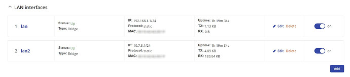

Ok…I’ve done few more tests in different configuration and I’ve found something that may narrow down the issue.
My firewall configuration is correct because now it works, to make it work I had to delete the VLANs, disable WAN and assign one physical port to each subnet.
192.168.1.1 => eth0
10.7.3.1 => eth1

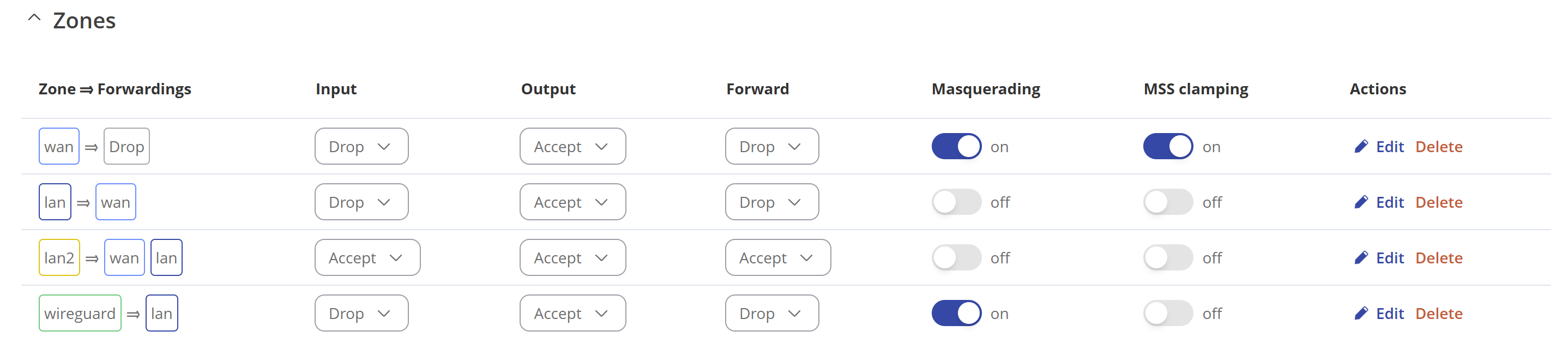

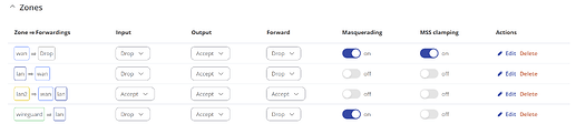

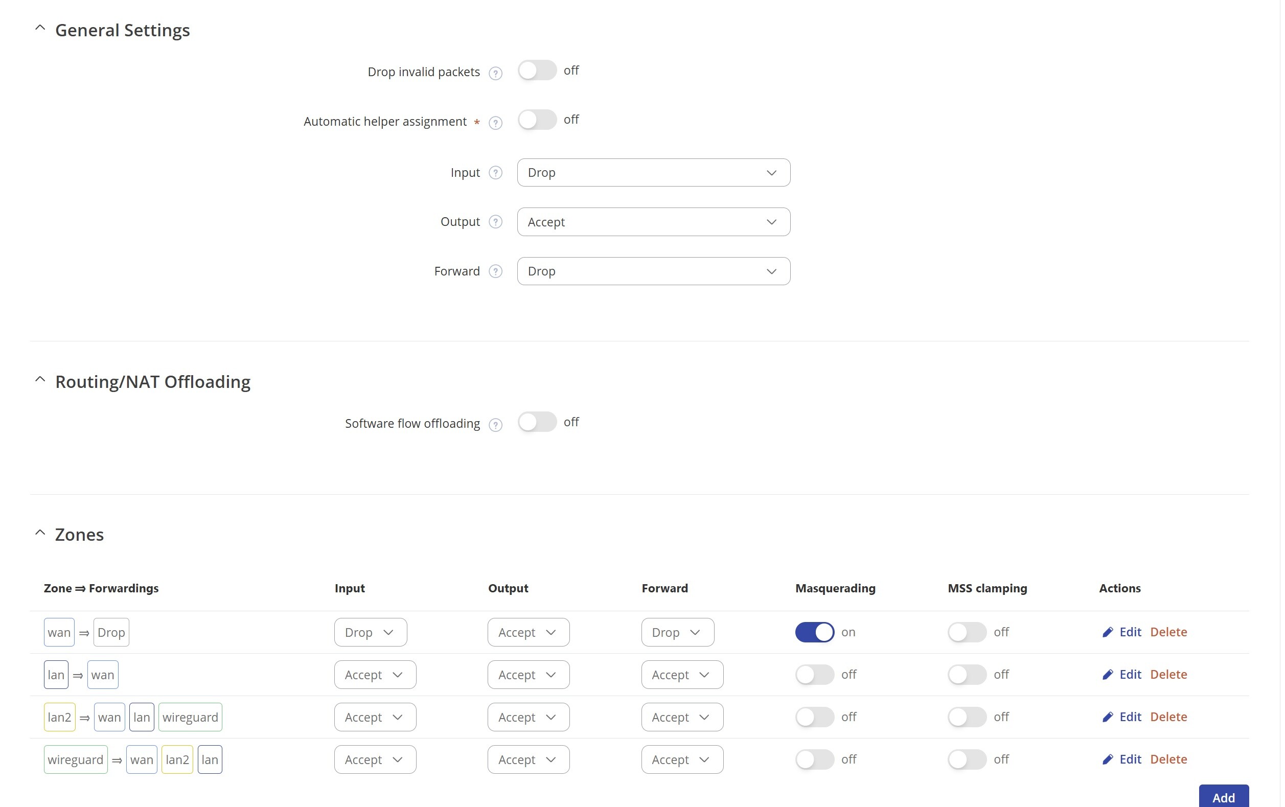

So my Firewall pages now look like this:

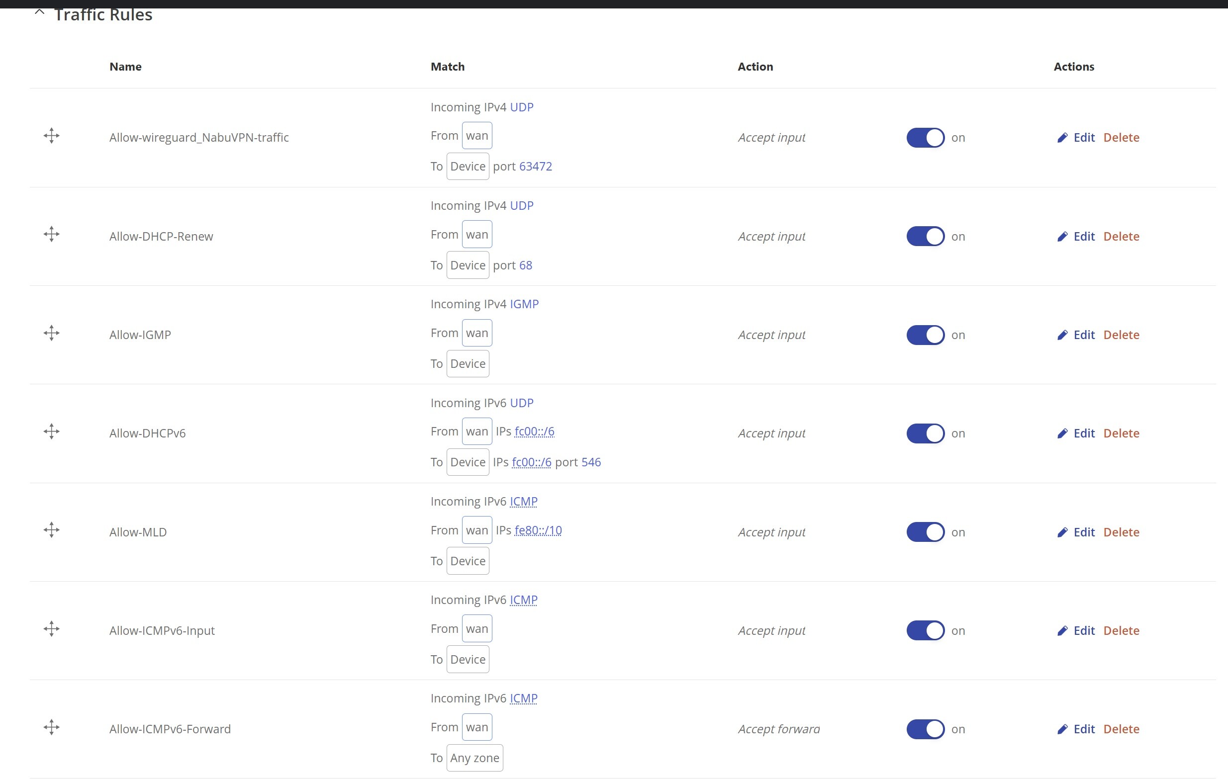

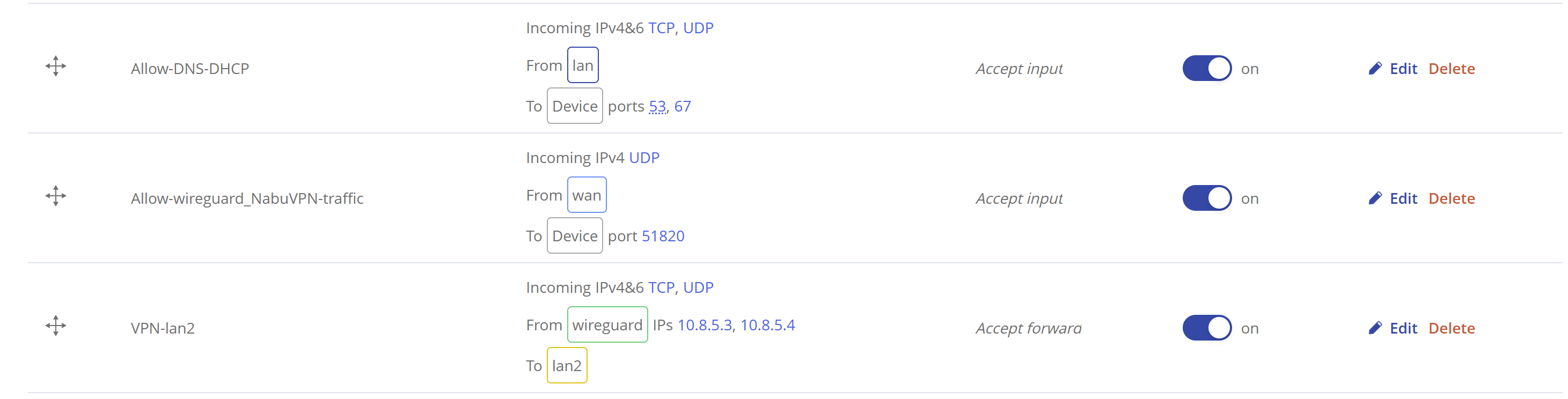

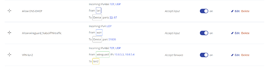

And I added this rules to the Traffic Rules page:

Just to be clear in this situation where the VPN works and I have internet connection on both subnets, if I then again create the two VLANs and assign them to port “eth0” and enable again the WAN on port “eth1”, the problem where I lose internet connection appears again.

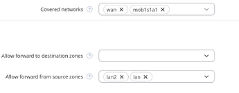

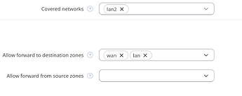

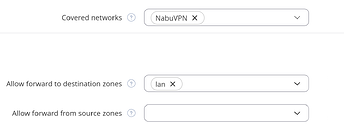

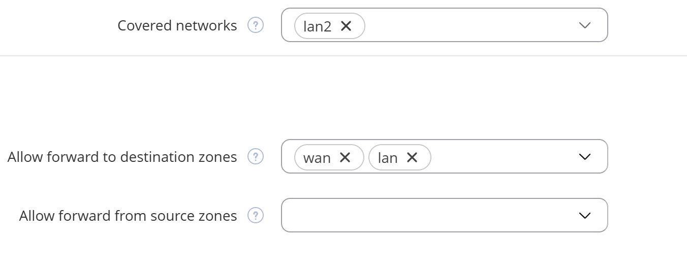

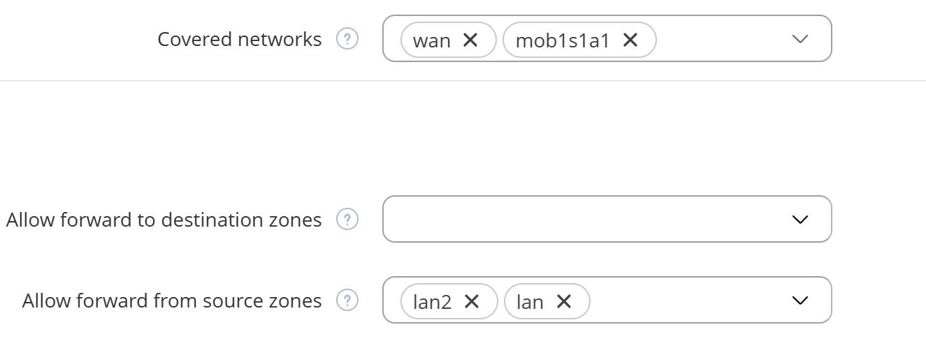

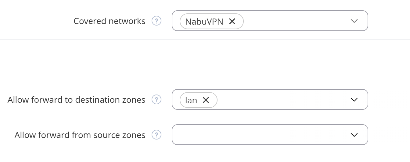

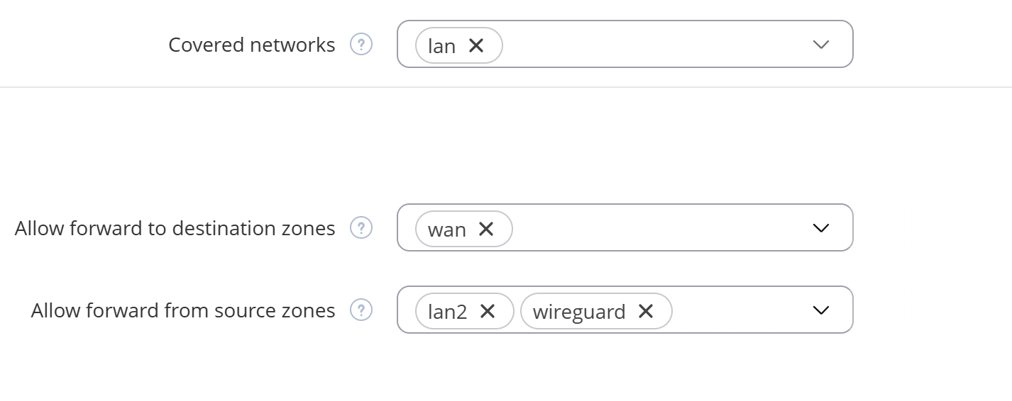

Without the “Covered networks”, “Allow forward to destination zones” and “Allow forward from source zones” initial and current values I won’t be able to tell what is wrong.
WAN
LAN
LAN2
WIREGUARD
NOTE that my idea is that “lan” is the restricted subnet made for IoTs
eth1 is the default wan port except if you have configured it at lan. Is that what you want ?
No, I configured it as LAN just for testing purpose.
It’s been two days now and I’m trying everything to make this thing work as I want.
CPU is almost always around 40% and RAM over 80%.
Stop the wg tunnel and recreate your vlans / firewall zones as you described above.
Do you still have Internet access ? What are the “Covered networks”, “Allow forward to destination zones” and “Allow forward from source zones” for all the fw zones ?

Created the VLANs like before, assigned to eth0 but not assigned to subnet yet.

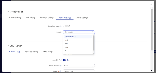

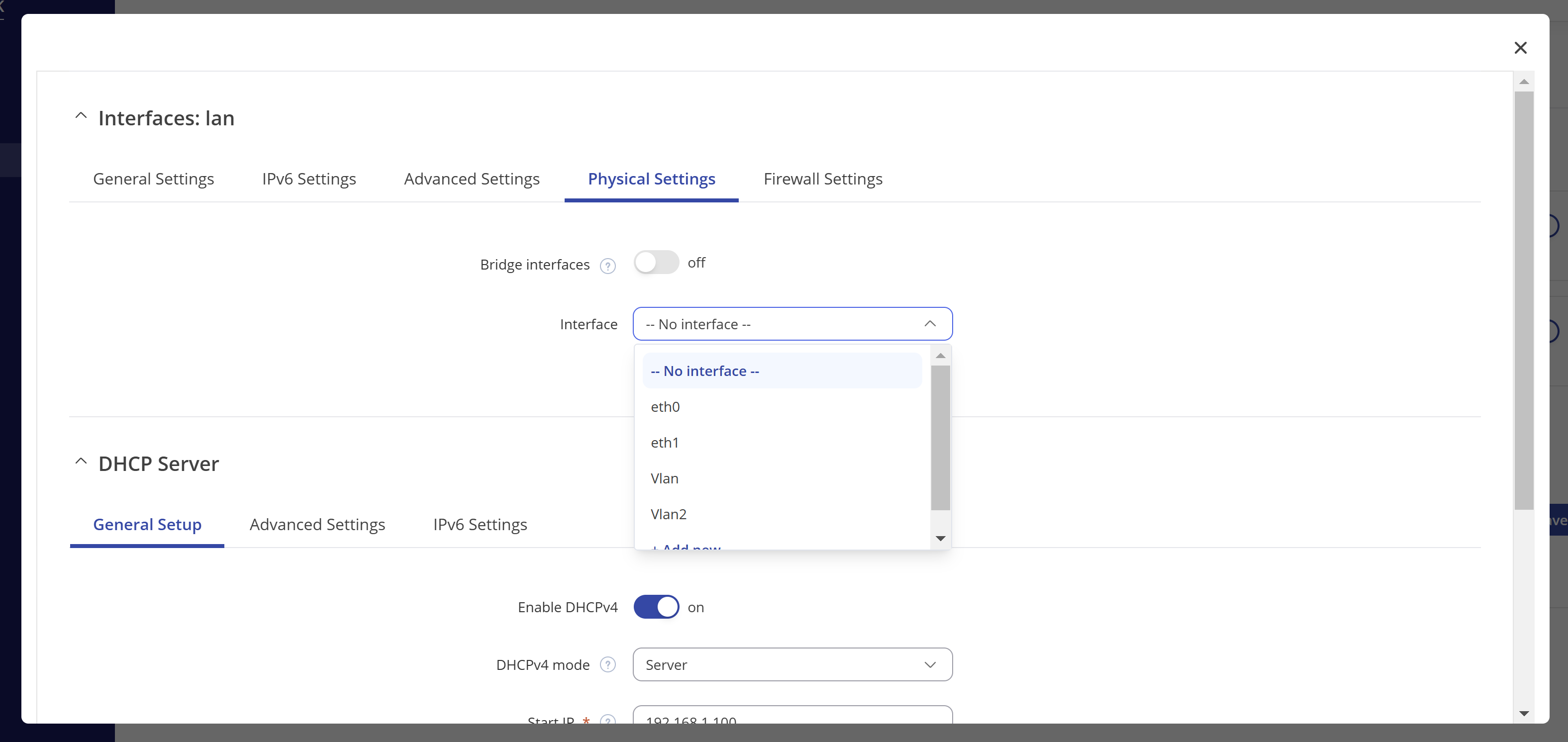

Now nothing but the VLANs are not associated to the Subnet…
If I understand correctly, you need to create a lan and associate it to a physical interface for each vlan. In your case that would be eth0.10 and eth0.20 (or vlan1 and vlan2).
Then the association to a subnet can be performed.
