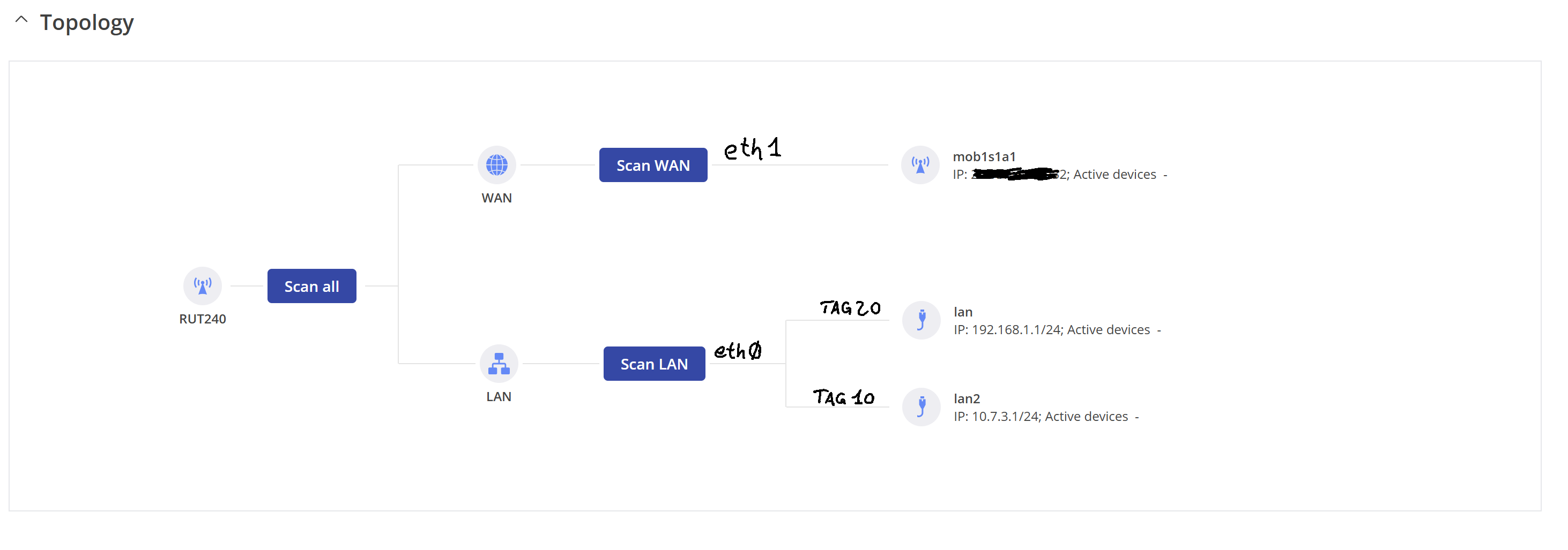

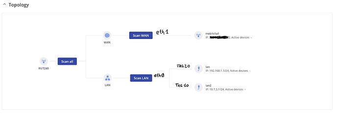

yes now I have this:
192.168.1.1 => vlan(tag=20) => eth0
10.7.3.1 => vlan2(tag10) => eth0
Not sure what is different but now it works!
