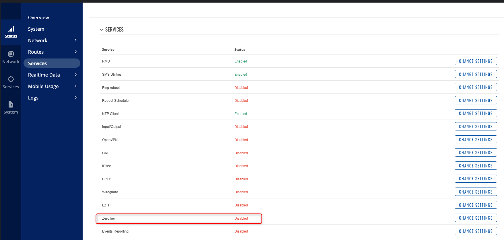

In the status page the service displays as disabled but when I go to change settings it shows as enabled

Could you please clarify whether ZeroTier is actually down, or is it just shows that ZeroTier is ‘disabled’ in Status → Services? There is a known issue where ZeroTier shows as disabled in Status → Services, but it should work properly regardless.

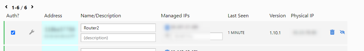

Thank you for your reply! I have checked and the service is running but the status shows disabled. Good to know that this is a known issue and that it doesn’t mean the service is actually down. What happens to me is after a reboot its as if the router is not connecting with the zerotier server
When i go online to the zerotier website the “Last Seen” doesn’t report that the router is online however it is. If i change the port from 9993 to 9994 , reboot and change it back to 9993 then then the router connects to the zerotier webservice
In the image below it shows connected as its working fine now
What i don’t understand is why i need to fiddle with the ports before it will connect?

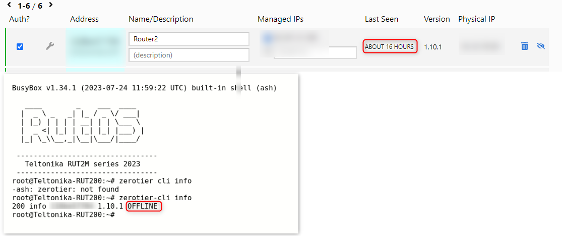

Hi
Thanks for your reply. I have done what you suggested and the issue is clear. The service is offline after the router was off for the night. I have switched the service off, saved, waited, and turned it back on and it still reports offline.
Any suggestions other than what I’ve done before to get it working? I will leave it in this state for as long as I can that way I might be able to test your suggestion.

If the ZeroTier would be disabled, the CLI command would return an error (missing port/not found). In your case, it seems that ZeroTier is running but it did not connect yet. It is possible that there is a connectivity issue, or it tries to connect before the device establishes internet connectivity, or maybe it takes some time to authenticate and connect.
