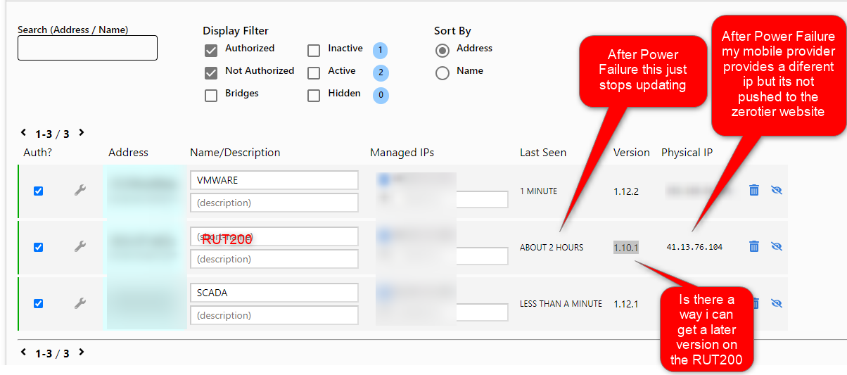

This is my second post about the same issue. Here is my first post
Basically, ZeroTier only connects once and after each power failure. The new public IP that gets assigned to my mobile connection does not get updated on the website.
I don’t know what to do anymore, The only way I get it to work is by uninstalling the zero-tier package and reinstalling it. Any help would be appreciated

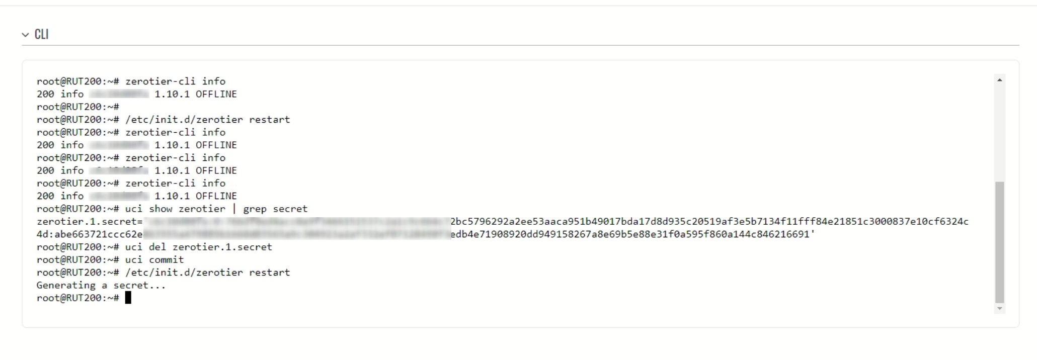

Since I am unable to replicate this, can you please try the following?
Next time you reboot the device and it does not reconnect, could you please check if it reconnects after restarting ZeroTier:
zerotier-cli info
/etc/init.d/zerotier restart
If it does not help, please try:
uci show zerotier | grep secret
Then, if its zerotier.1.secret, do:
uci del zerotier.1.secret
uci commit
#wait 2min
zerotier-cli info
Does it connect?
EDIT: While there is no newer ZeroTier version available on Teltonika devices currently, you could try to update it yourself. There was a topic about it here.
Hi Thank you very much for the reply
I have done as you suggested. Please refer to the following
It did not connect again
