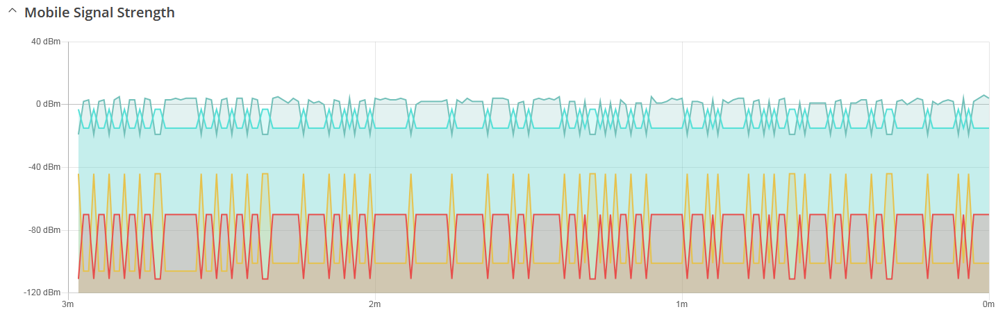

I own a RUT241 with FW RUT2M_R_00.07.06.1, and the mobile RSSI periodically drops from -70 to -111dBm for no reason:
[MobileRSSI]
When the signal drops to -111dBm, all signal level LED are also turned off, but the mobile connection stays active (no disconnection).
Let me know if I you need debug logs to track this bug.

In one of my RUT951 devices i’ve got an issue with mobile signal after firmware update to latest firmware RUT9M_R_00.07.06.3
Mobile data is connected but when i check the data transmission data I see signal RSSI change from -48 to -111 dbm. Device do not loose conection but I see this variation.

Since I upgraded fw on my rut241 to 07.06 and 07.06.1, mobilesignal has been unstable.
Every 8-10 seconds the signal drops to -111dBm and all the signal strength leds on the router go off. Signal are gone a couple of seconds, then back to normal again. After a while it’s gone again.
