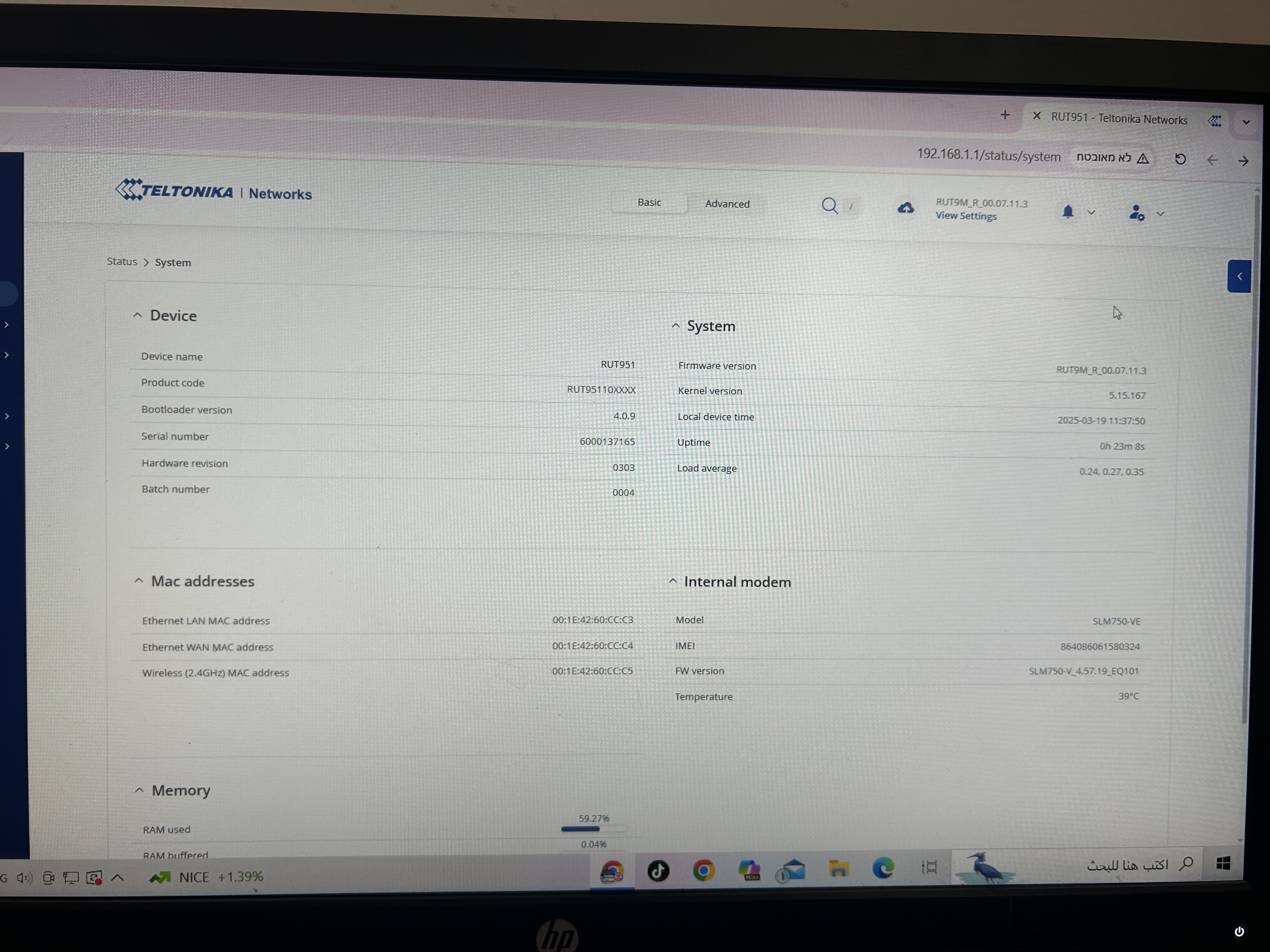

Furthermore, if possible, please provide a screenshot from the Status → System page, ensuring that any private/sensitive information (such as S/N, MAC addresses, etc.) is blurred or hidden.
Now, after the upgrade, one issue has been resolved — SIM slot 1 is working.
However, SIM slot 2 is still not functioning, even though I tried switching the SIM cards between the slots.

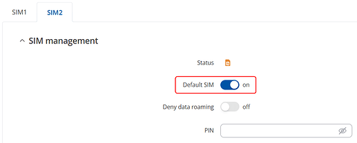

Please note that the RUT951, like any other single-modem router, can establish only one connection at a time, using the SIM card selected as the default.
To test if SIM slot 2 is functioning properly, please follow these steps:
  1. Navigate to Network → Mobile → General
  2. Select the SIM2 tab
  3. Set SIM2 as the default:
  4. Click Save & Apply
After applying the changes, please check if the connection is established. Let me know if you need further assistance.
No, it didn’t work.
Could you try upgrading the device firmware to the latest 7.13.2 (preferably without Keep settings selected, if feasible)? From the screenshot, it looks like you’re still running an older 7.11.3 firmware.
After the update, please check if the SIM card is still not being detected in the SIM2 slot when it is selected as the default.
