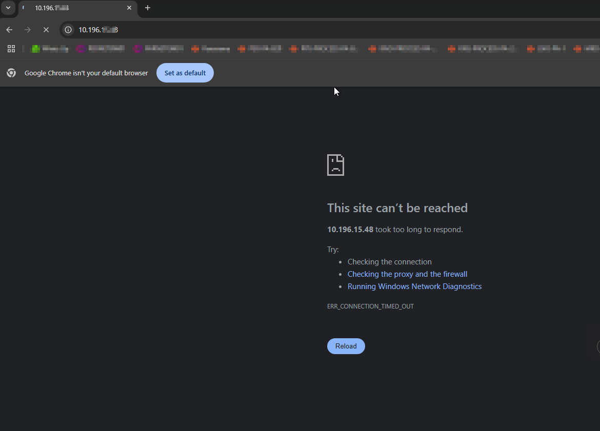

From the wan it takes a very long time with frequent connection “timeouts” . If the webui loads it does not load properly i can see the username / password fields and some basic graphics. I was able to login once , however again i did not get the full UI experience and it was not responisive

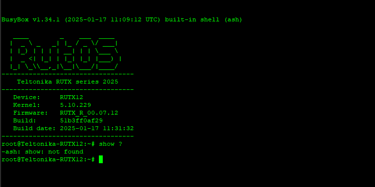

  1. I can access the SSH interface with no issue using the WAN interface

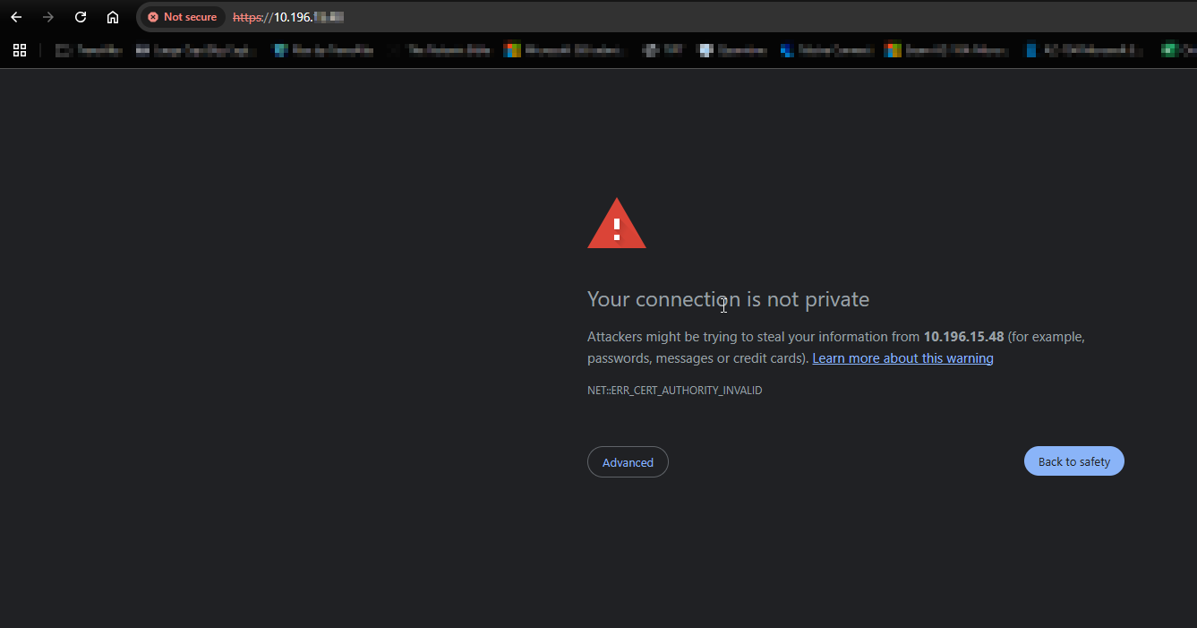

  2. Here are the screenshots when i try and access the Web Inteface using the WAN Interface

With the release of RutOS version 7.12, the HTTP protocol is disabled by default, and HTTPS Redirect is enabled to enhance the security of WebUI and API communications.
Please check the following topic for more details:
Additionally, you can refer to these wiki examples:
