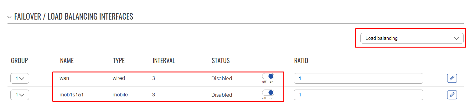

If you do not have any VPNs configured on your RUT and simply need to forward different types of traffic via different WAN interfaces (like mobile SIM or wired WAN), then you should be able to do so via multiwan. Those can be configured in Network → Failover → Multiwan. There, select load-balancing on the top and enable the interfaces you want to use:

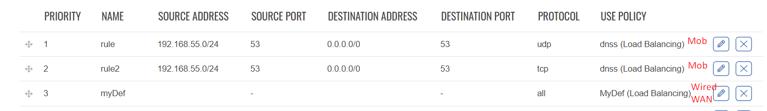

Create rules at the bottom that will match UDP/TCP traffic (for example, port 53 for DNS) and use a policy you want (for example, mobile interface). Create the rules you need and move them to top of the list. The last rule should match the rest of the traffic and route it with your desired interface.
