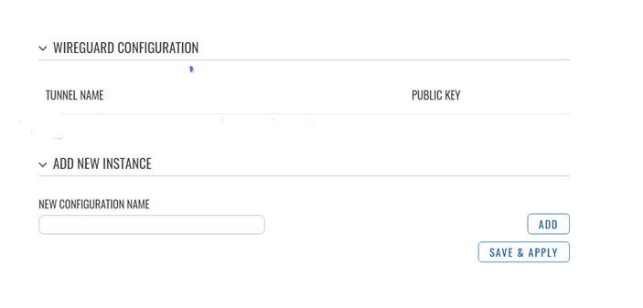

First step today was to add a wg instance and peer exactly as per installation file through the webUI. All fine when wg off. Also fine when wg on, but only handshake seems to go through wg interface. This was confirmed by the VPN provider test page which gave an IP address associated with the internet provider, not the VPN provider.

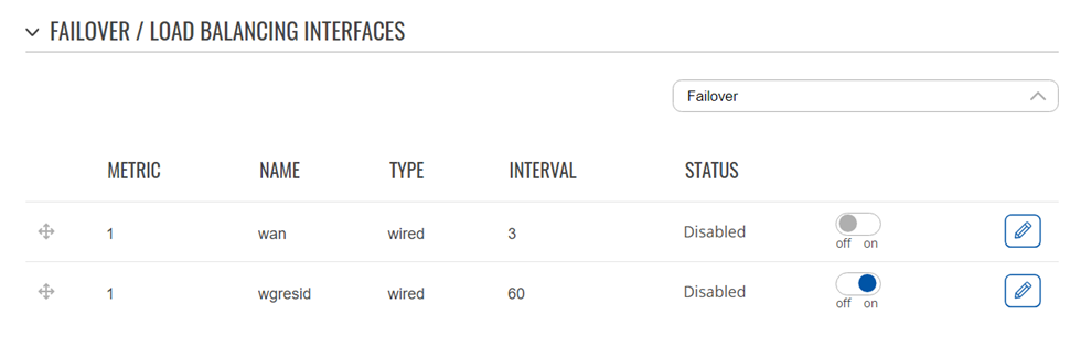

After editing config mwan and mwan3.user + restart as above I lost internet. As yesterday Windows thinks it is there, but I cannot open any web pages and there is no new handshake in the tunnel.
Interestingly, a few bytes are received now and then in the existing tunnel but nothing seems to be sent, a behavior I have not noted before.
Wg, iprule and iproute - note that your 1001 rule now appears in 32764:

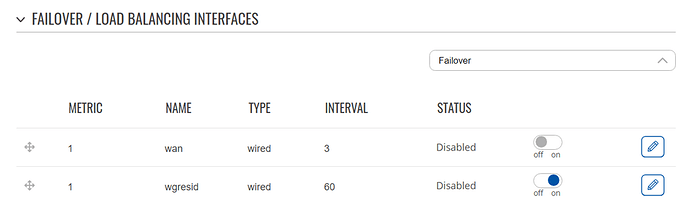

When trying to add the first line manually the router stopped responding while (or after?) trying to execute. I lost webUI contact and the shell never gave me a new ready signal.
I cut the power for a while and the router came alive again but still no internet. (Windows thought it had, but nothing could be opened etc).
Wg and iprule - note the disappearance of the 1001 rule after the mwan restart:
