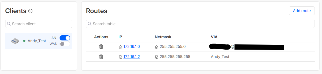

When I use routes for the device within my VPN, this works perfectly. However adding a route for each device means the VPN needs to be restarted which breaks the connection for all other devices on the VPN.

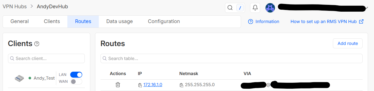

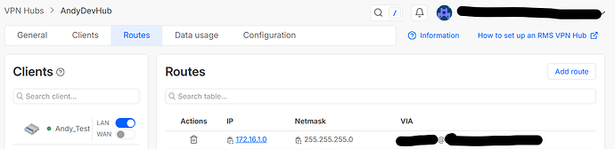

Instead I would like to have one route which allows my VPN user to talk to all devices on the VPN, like below.
I have tried this approach and there is no 172.16… route pushed to the OpenVPN Client and
route print -4
does not show a 172.16 route
Even when I add a 172.16 route manually into my OpenVPN Client on Windows 11 I still cannot talk to the device.

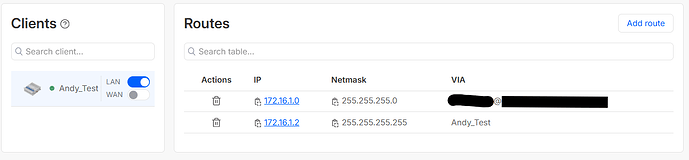

As soon as I add the below entry and restart the VPN, everything works perfectly, but I do not want to add a route for each device for the reasons mentioned above.

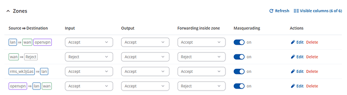

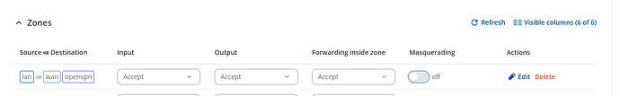

Could you please confirm whether you have tried enabling masquerading on the LAN zone under Network → Firewall → Zones settings as described in the thread here:
Let me know how it goes.
Thank you Martynas for the response.

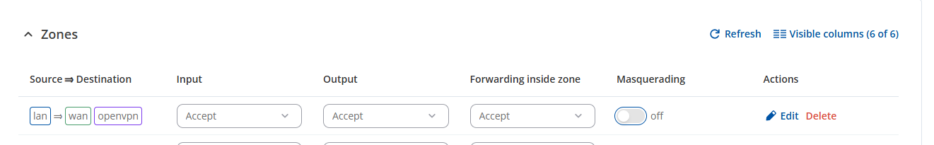

I was looking for this on the RMS but I think it’s a setting on the device.
So I’ve toggled the top option from OFF to ON and tried Save & Apply.
I will remove the other routes and see if this works.

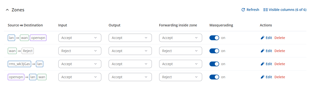

Hello Martynas,

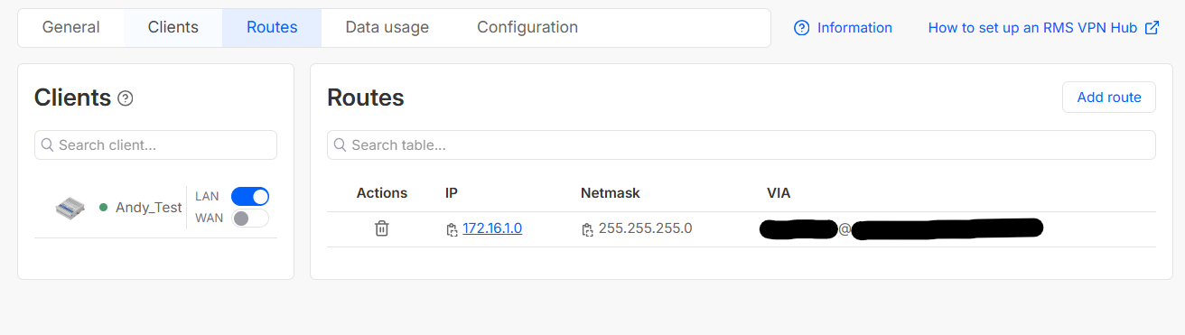

I have removed the device route so now only one route exists
Device settings are as below
Still facing same issue.
Here is my IPv4 routing table showing the route that should be in place.
Please note I’ve had to set this route manually in my ovpn client file because the gateway hasn’t pushed it on connect.
