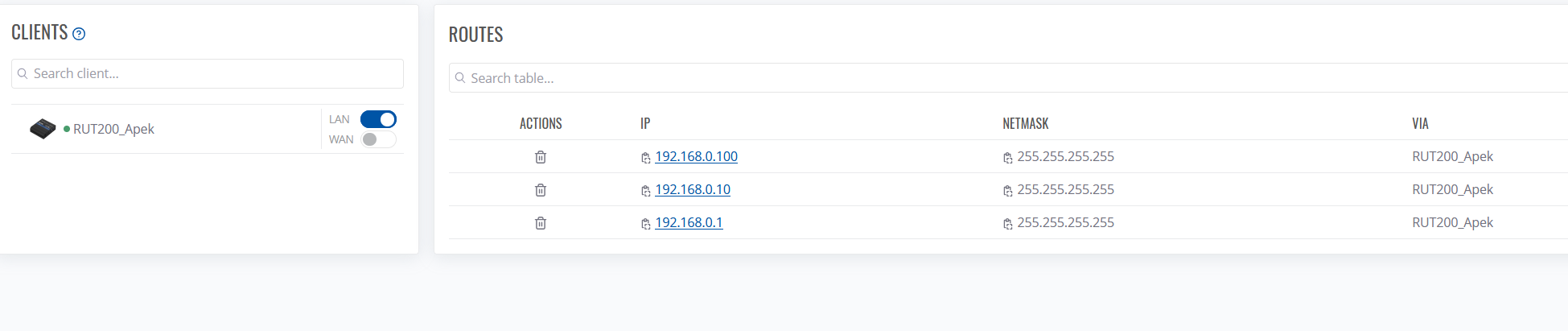

i have a problem with LAN forwarding on RMS VPN. I made configuration of VPN as usual (clients, routes, etc.), but through OpenVPN i cannt connect to devices on my LAN network. From RUT CLI i can ping my devices on 192.168.0.1 or 192.168.0.10. Through OpenVPN it is possible to access WebUI on 192.168.0.100.
Maybe it is usefull to add, that RUT was registered to RMS and working well, then I performed factory reset, unregistered RUT from RMS and registered again. And from this moment I cannot acces LAN devices.

Could you test deleting these routes you already have and adding just one singular route:
IP: 192.168.0.0
NETMASK: 255.255.255.0
VIA: RUT200_Apek
Restart the VPN hub afterward and try to access your LAN devices again.
If this doesn’t resolve the issue, kindly send me a screenshot of your Network > Firewall > Zones window, just make sure to blur out any sensitive information such as public IP addresses.
