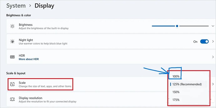

Hi everyone, I found that setting the screen scale to 100% in the PC settings, as shown in the image below, makes the RMS VNC work correctly.
I hope this helps and we’re waiting for Teltonika to fix the issue.
This fixed the issue we were having with VNC as well. Cheers!

After investigating the issue, I noticed that the behavior seems to depend on the combination of two local display settings:
  • Windows display scaling: Settings → System → Display → Scale
  • Browser zoom level, in my case Google Chrome
The important point is that neither setting seems to be the sole cause. The issue appears to depend on the combination of Windows scaling and browser zoom.

For this particular customer, Windows display scaling is normally set to 125%. As a workaround, I asked the user to set the Chrome zoom level to 80%, and Remote Access VNC then works correctly.
So, at least on this workstation:
125% Windows scaling + 100% Chrome zoom = VNC unusable
125% Windows scaling + 80% Chrome zoom = VNC working
This strongly suggests that the problem is related to how the RMS Remote Access web client handles browser rendering, DPI/display scaling, or viewport dimensions, rather than to the remote VNC destination itself.
