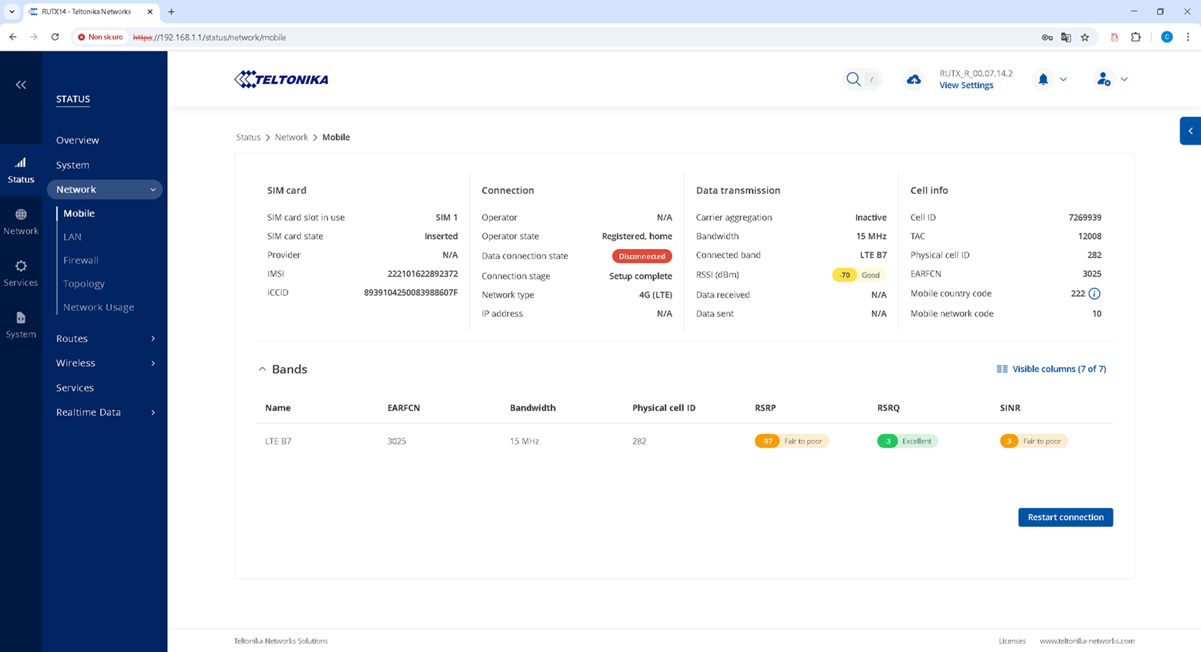

Could you please share a screenshot of the Status → Network → Mobile page from the WebUI?
Hi Marija

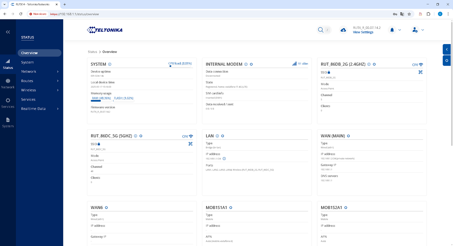

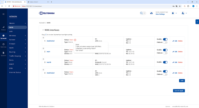

below the newtork status

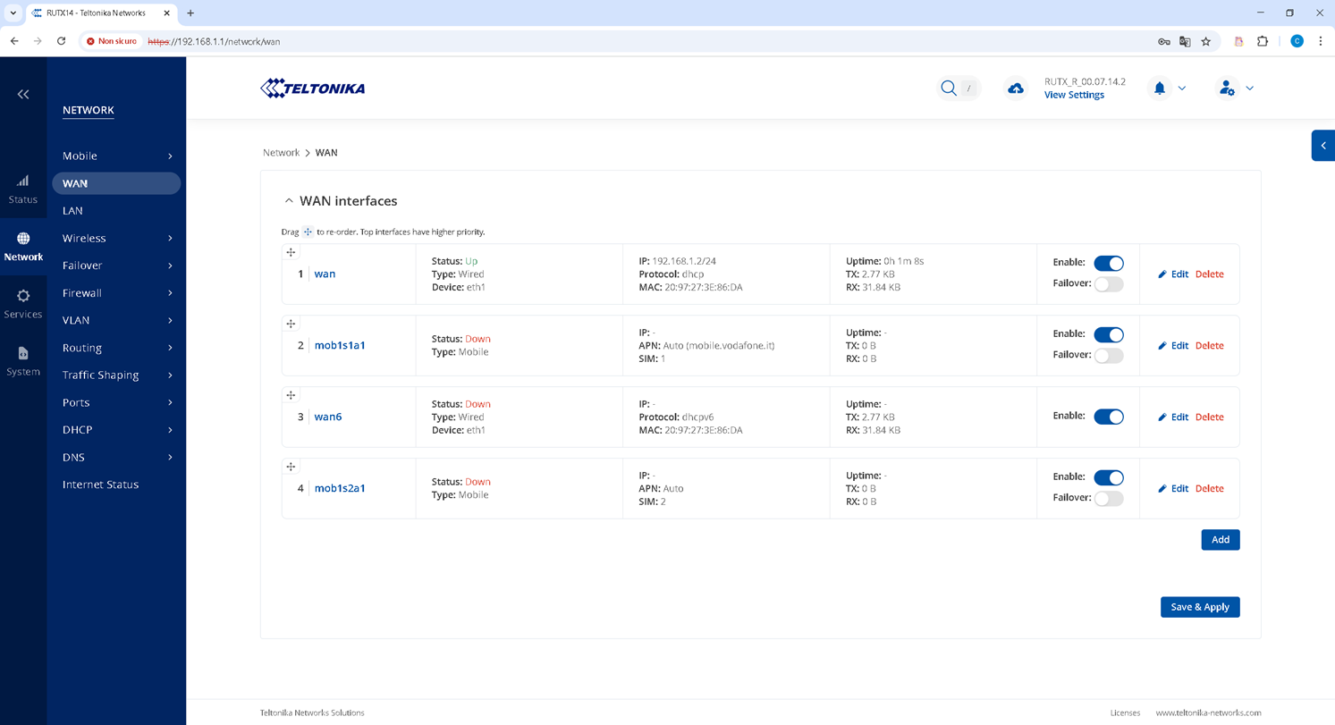

and the WAN status
Can you see that it reports an error on status of the mob1s1a1?
It seems it cannot activate the mobile data connection on WAN.

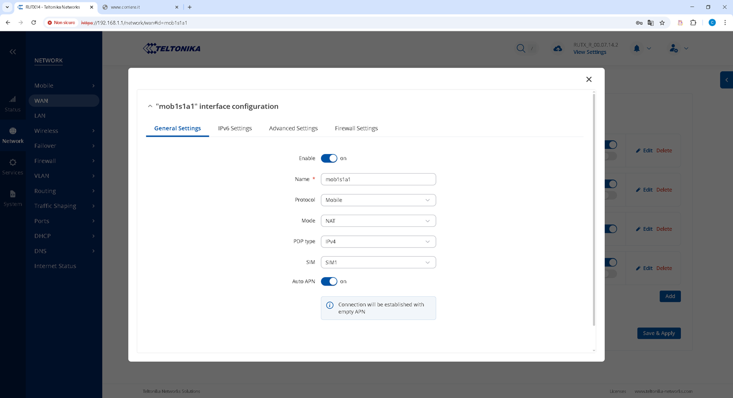

Try changing PDP type to IPv4 only for mobile interface mob1s1a1.
Please click Edit next to the mob1s1a1 interface, locate the PDP type setting, select IPv4, and then click Save & Apply.

i did the recommended change in PDP type to IPv4 and manual settings operator
the status of the router was the following
as first attempt I connected even the eth was and wan status was the following and everthing worked fine I was able to navigate.
The mobile connection was established but obliviously data connection state wasnot connected.

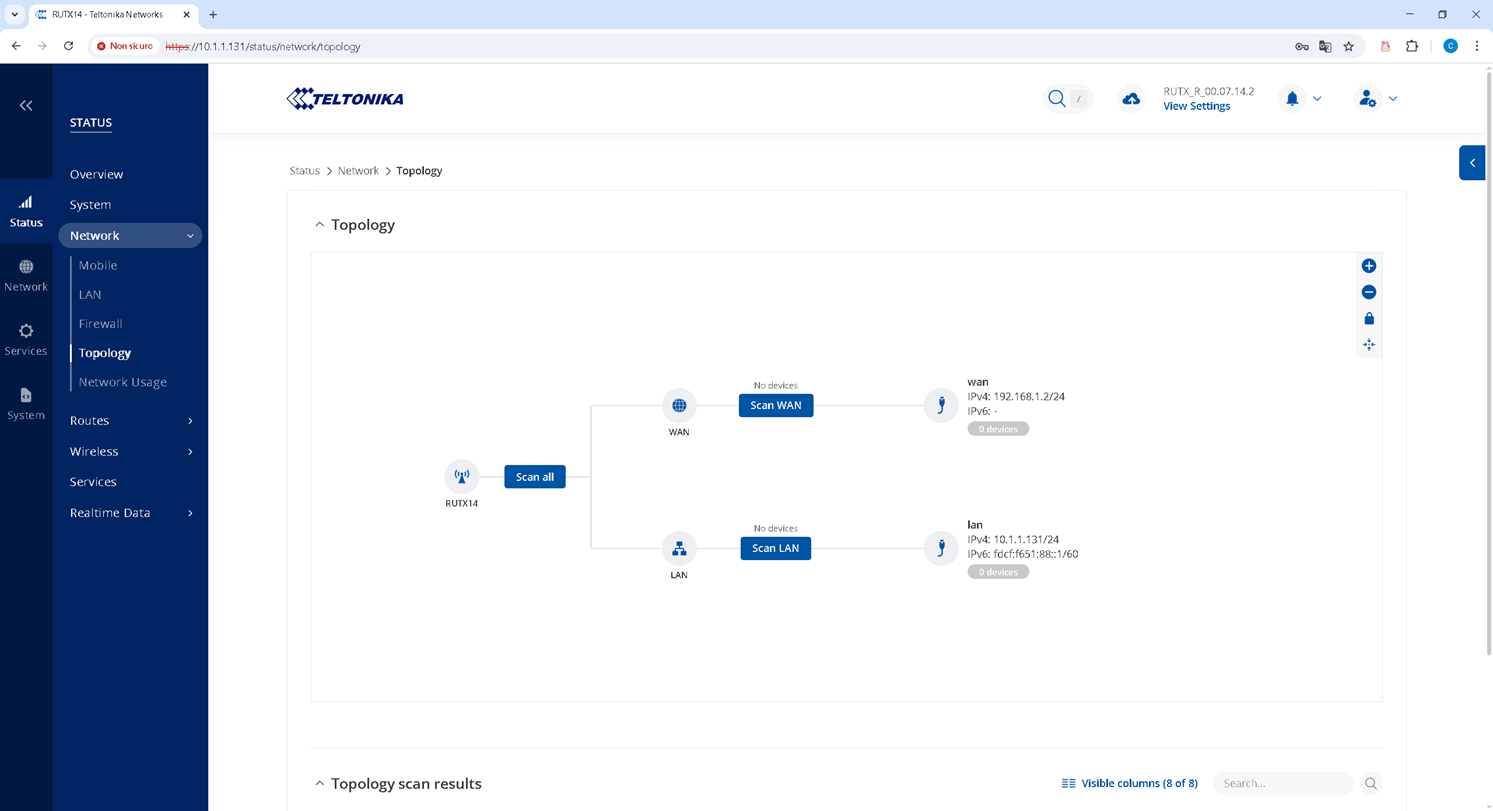

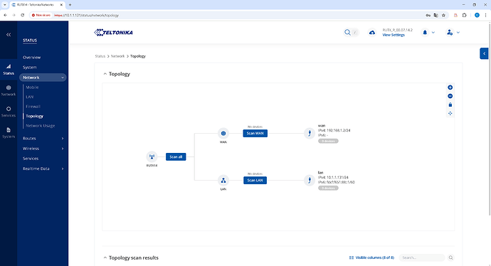

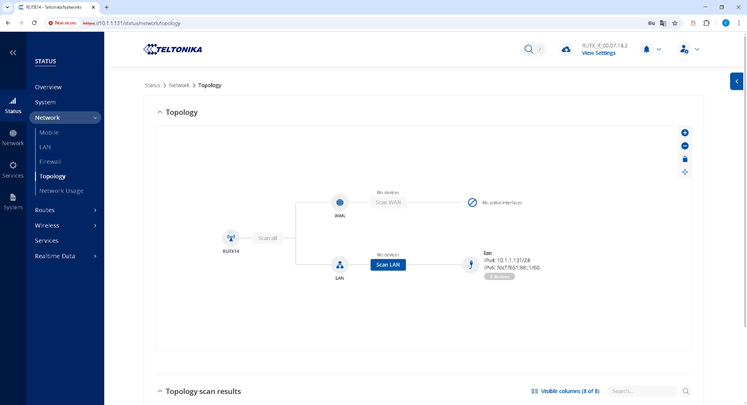

and here was the topology
then i disconnected the eth wan and I expected that the wan swapped on mobile connetion but as before an error appeared, it was “QMI call error, reason type INTERNAL: interface in use config match call failed”
And in fact the wan did not switched to mobile even the wan was ok
and the and the topology was the following (wan not active)
