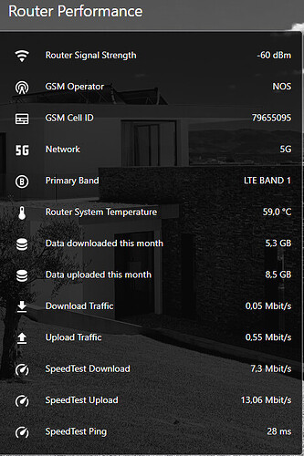

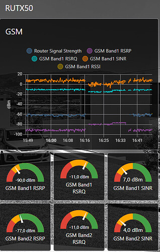

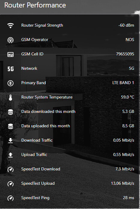

I probably have all the performance data you would like to see. I monitor this on a constant basis:
Speeds, uptime and signal quality (LTE).
I monitor network and bands:
Mind the black band which indicates a loss of connection… (The cell tower is on about 2km max).
and I monitor some additional data as in:
Signal strength doesn’t seem to be the issue. What I need to know whether I have provider issue or a router issue (the last one besides speed is already proven. Too many issues with this router. If it comes to stability the Huawei was outperforming this router by far. The RUTX50 has too many glitches. The forum is proof of that).

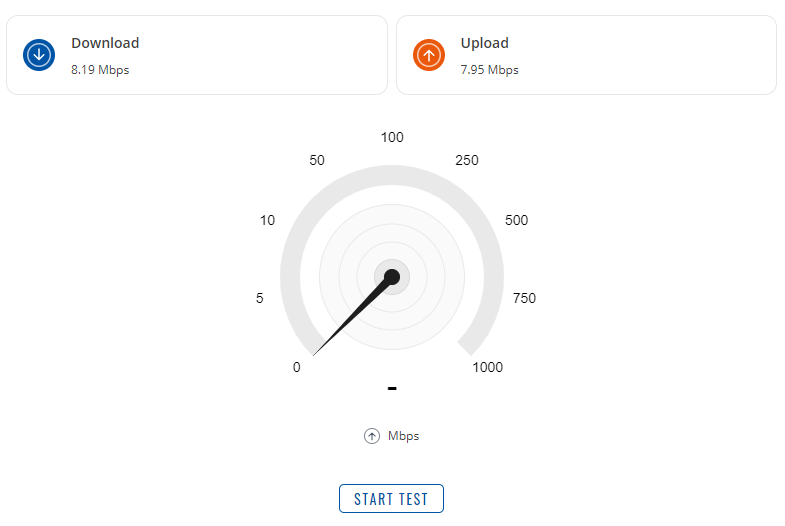

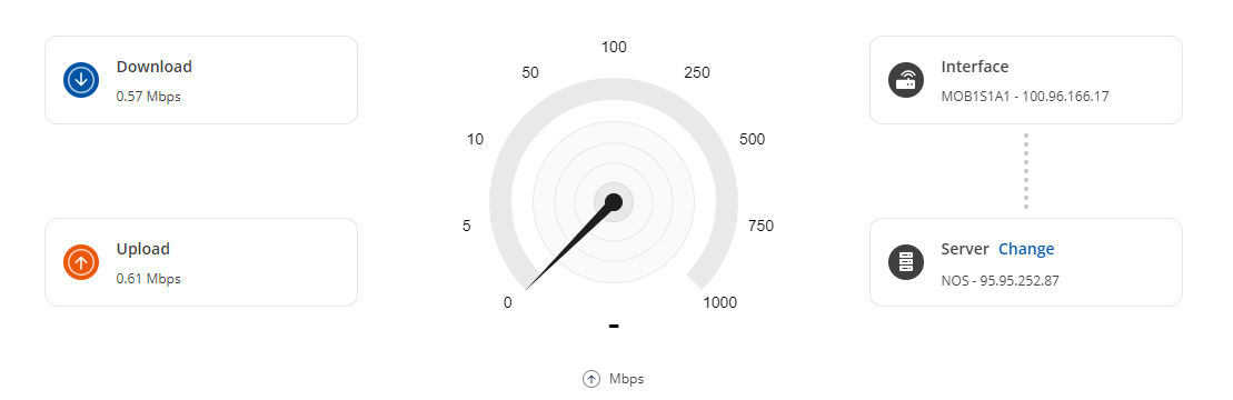

A speed test by the router gives every similar outcome:

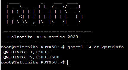

Can you check MTU settings in Mobile interface (LTE)? As I discovered, by default it is 1500 bytes.
But my carrier use 1460 bytes. You can check MTU size with gsmctl -A at+qmtuinfo command from command line. If you have MTU mismatch, then I think, your router performance can be bad.
It seems to match…

Please post a screenshot of Status → Network → Mobile with the signal strength parameters. It contains information about the secondary bands, which could be causing the issue. Make sure to hide IMEI and ICCID.

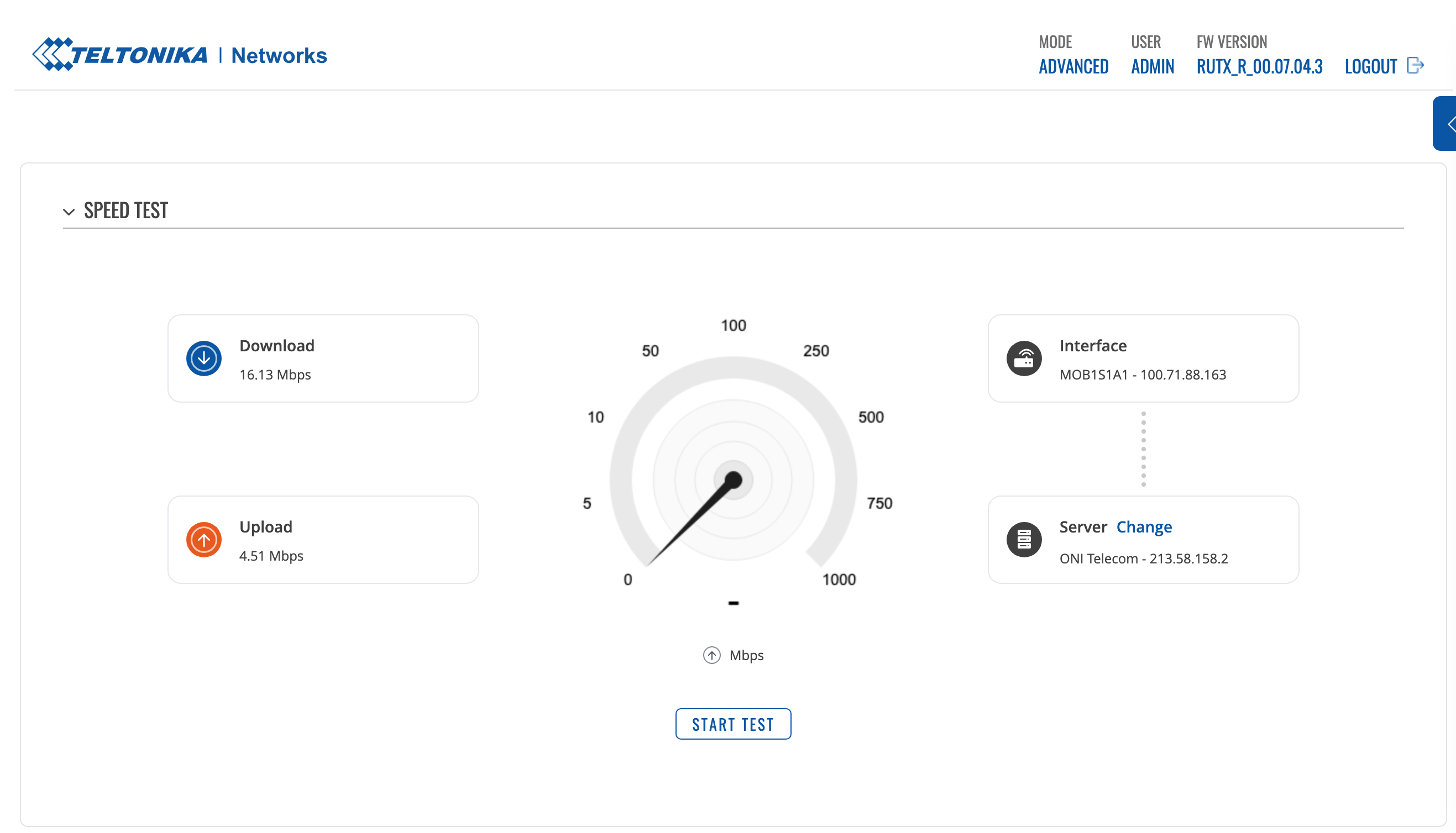

And could you try running a speedtest to a different server?
I assume you mean this one:
This is my last hour performance. By coincidence I had some connection issues as you can see and the router rebooted;
In the meanwhile I will change server for the speedtest.
I took the closest server (in distance) I could find from the list (not the provider server):
Outcome still in the category POOR.
