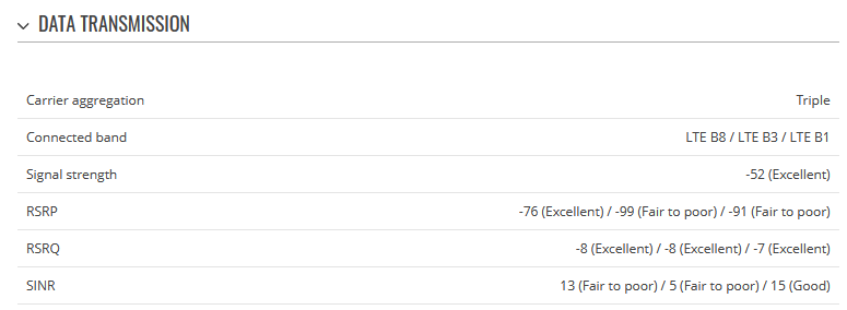

I also have a Poynting XPOL-2-5G antenna with 2 jacks. If you number antenna jacks from the USB post as 1-2-3-4, GPS jack sitting between 2 and 3, and if antenna is plugged into 1 and 3, you get a reasonably good signal -

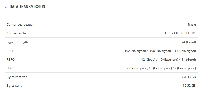

If you jack it into 1-2 though it gets considerably worse -
The main antenna connectors for LTE and low-band 5G are 1 and 4 from the USB port. 2 and 3 are for high-band and 4x4 MIMO support. So if the router is primarily used in a rural area, first and the last antenna connectors are the ones to use.
However, in the city, where n78 band is available, not utilizing the two middle connectors could result in lower downloads speeds.
