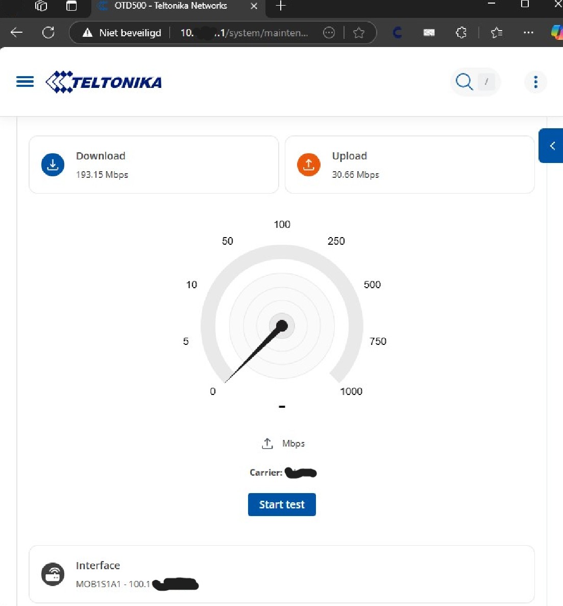

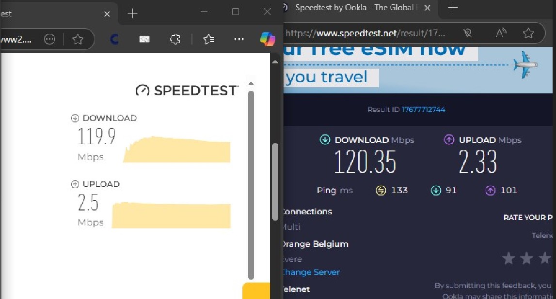

Hello, we are using a OTD500 for about a month now. We use it as an internet failover (second WAN). When connected to the OTD500 the download speeds are very good via 5G (>200mbps). But the upload speeds are terrible (<3Mbps). Even when we are directly connected from a computer (so no router in between) the speeds are bad. When performing a speedtest through the webinterface the download speed is >200mbps and the upload speed is >30Mbps. These values are the expected speeds. So what is causing the bad upload speed when connected to the OTD500?

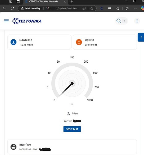

Speedtest on device:
Speedtest when directly connected:

We have indeed performed multiple speed tests at different times, using various nearby servers, including those recommended by our provider. The results from the OTD500 WebUI speed tests consistently show both download and upload speeds meeting expectations.
However, the issue remains that when the OTD500 is connected to a router or directly to a laptop, the download speeds are generally fine, but the upload speeds are significantly reduced — typically around 4 Mbps, far below the expected performance.
This discrepancy between the device’s own speed test and real-world upload performance through connected equipment is the core of our problem.
We would appreciate any further insights or troubleshooting steps you could provide to help resolve this upload speed limitation when using the OTD500 as a failover or primary connection.
