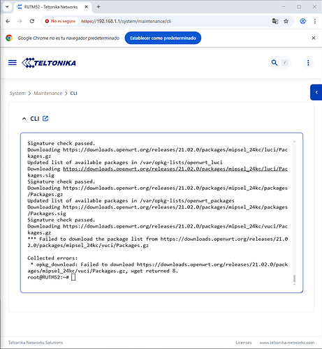

I am currently trying to install iperf3 package on my RUTM52. However, I have encountered that after running the opkg install iperf3 command, the response was Unknown package ‘iperf3’ Package installation encountered an error, removing previously installed package, so I decided to follow the commands indicated in the following issue:

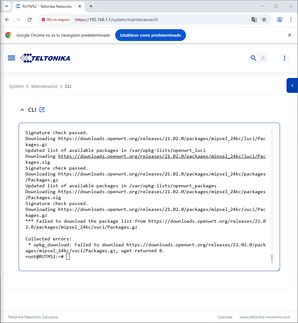

Nonetheless, after running the first command opkg -e /etc/opkg/openwrt/distfeeds.conf update, I get the following downloading error, and it does not allow me to download iperf3 package — obviously.
I am aware Konrad encountered the same error last year ( OPKG packages installation - package is unknown - #3 by kchrosto ), but they did not indicate the solution for it. Does anyone know what am I doing wrong or what is happening?
