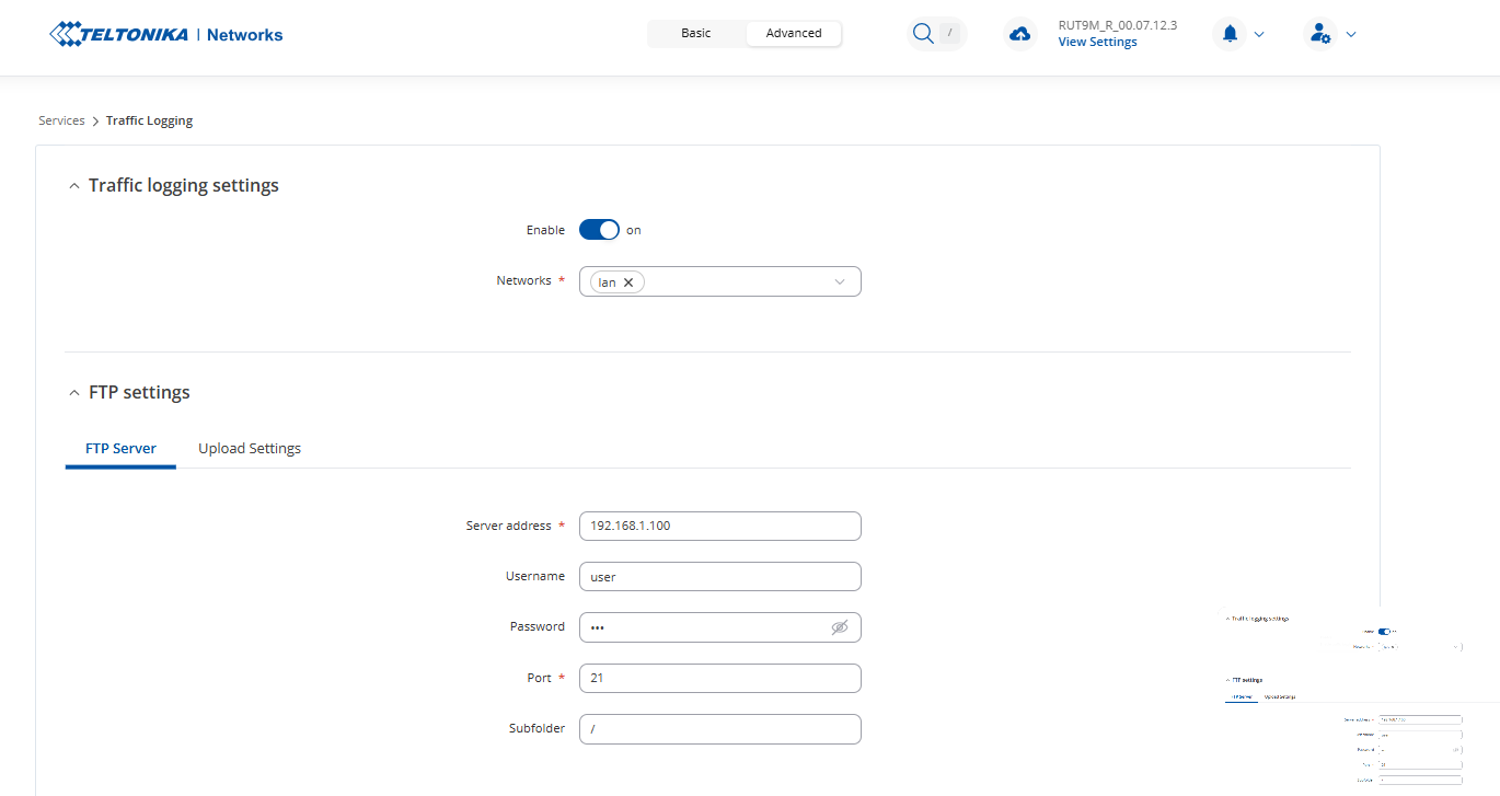

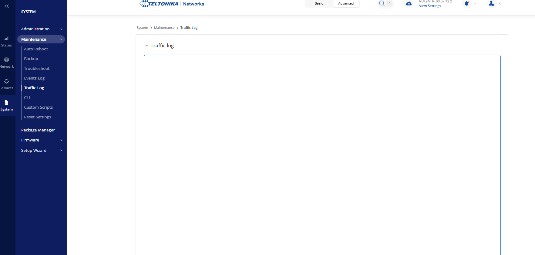

i already enable trafic log and setting ftp server after monitoring for 1 hour no traficlog show on Maintenance> traffic log and trafic log file on ftp server no data too

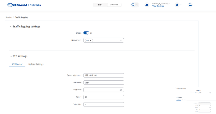

There was a similar topic discussed here: Traffic log blank. Please check it to ensure there are no inconsistencies in your traffic logging configuration.
Additionally, there is a known issue on some devices where no traffic logs are returned. This will be fixed with the upcoming RutOS 7.13 firmware release.
Hello @klo123645,
This issue is most likely related to a known traffic logging service stopping working bug, which, as mentioned earlier, will be fixed with the upcoming 7.13 firmware release.
