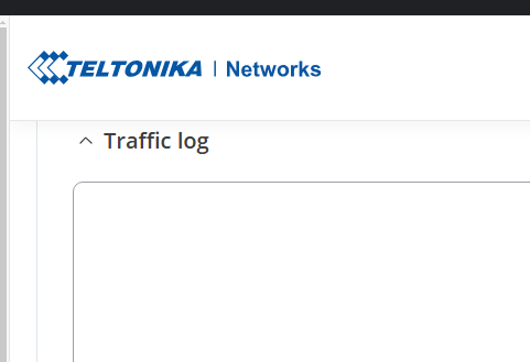

I have a RUT200, have installed Traffic Log via package manager and via upload.
In Maintenance traffic log - is blank
Whats wrong??

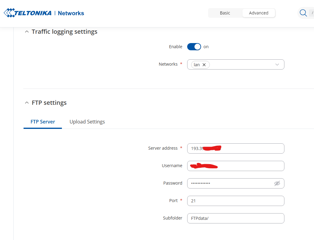

You won’t find any traffic logs in the System → Maintenance → Traffic Log page, as they are automatically removed once they are uploaded to the FTP server:
They are blank on the FTP server, message says they will be removed locally until sent to FTP
Then it’s most likely that the traffic logs weren’t sent to the FTP server at all. Please ensure that you have specified the subfolder path correctly, starting with the / symbol. Additionally, double-check that the uploading settings are configured accordingly.
