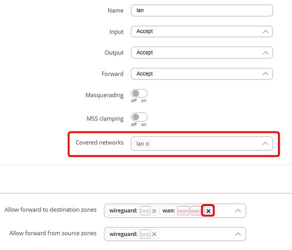

Additionally, on the OpenWRT side, the LAN clients should only be able to forward the traffic to WireGuard tunnel, and not the WAN zone:

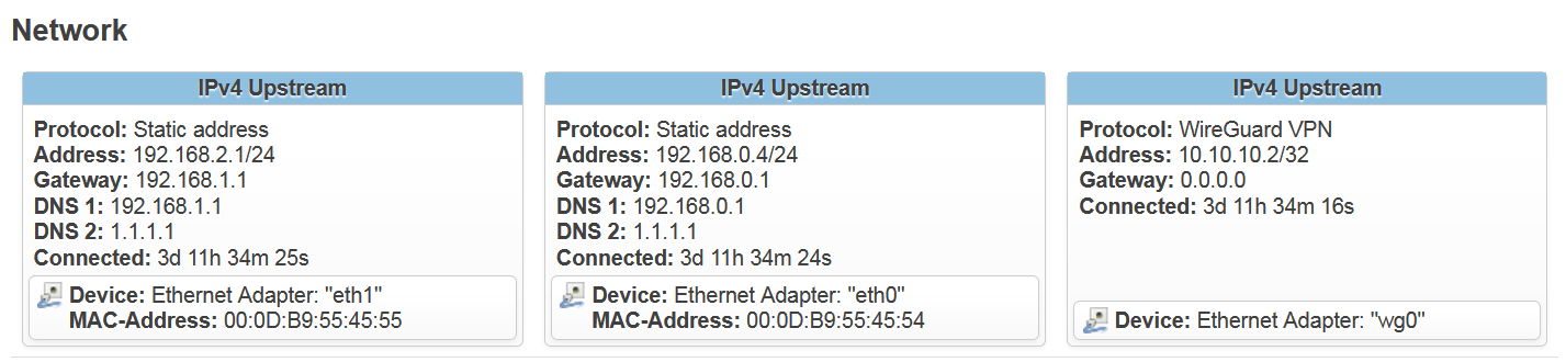

This is the overview from site B. As you can see, the B router sits behind yet another router and has a port forward from that upstream router to deliver the Wireguard traffic. This means double-NAT, and I guess it could have an effect on MTU size etc. However, there are no issues communicating back and forth between clients in the A and B networks, so I still fail to narrow down the root cause of this…

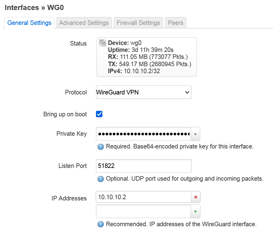

Site B WG interface

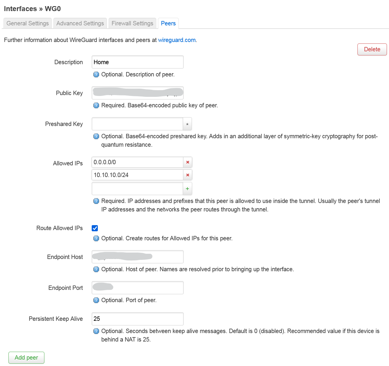

Site B peer A details.
Here you see the Route Allowed IPs is checked, and all IPs (0.0.0.0/0) are part of the allowed range (which I guess makes 10.10.10.0/24 a bit superfluous, right? :slight_smile: )

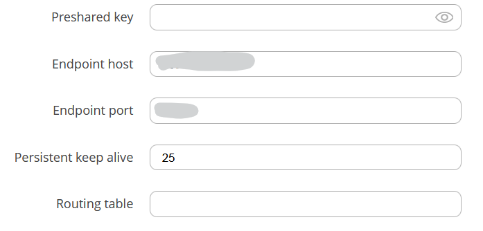

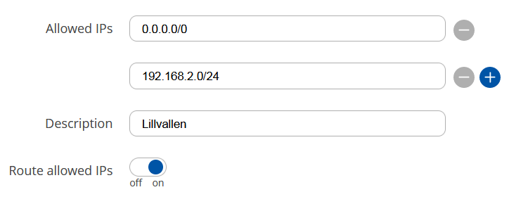

Site A peer B details
Site A peer B “Advanced settings”

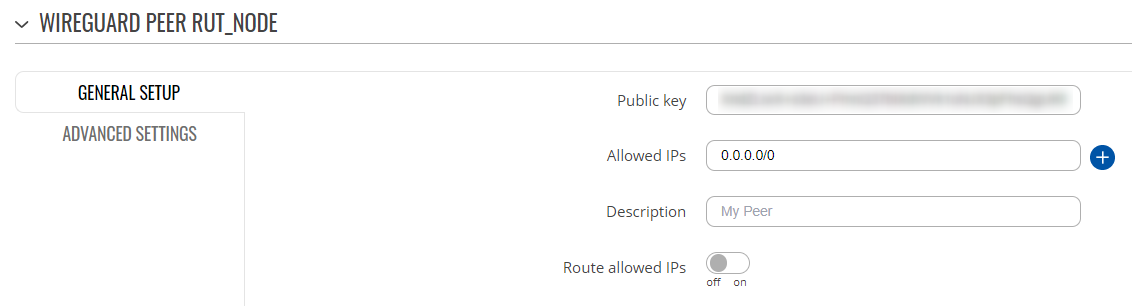

  • Could you try adding 0.0.0.0/0 on the Teltonika side, in the Allowed IPs section? Make sure to disable the Route allowed IPs option first, as you will most likely lose access to the RUTXR1 otherwise.

  1. I tried to first disable the Route allowed IPs and then added 0.0.0.0/0 to the list of allowed IPs from peer B (in the RUTXR1 config). The only consequence I noticed with this change, was that I lost contact with site B.
    This is another thing that I should have mentioned; I’m currently at site A, whilst site B is some 650km away from me, and I have no other remote access to it besides the Wireguard tunnel. But Í have a way of probing for internet access from a client that sits in the B network, which I can access (over the Wireguard tunnel, of course :slight_smile: )
    Connection with site B was re-established as soon as I removed the changes made.

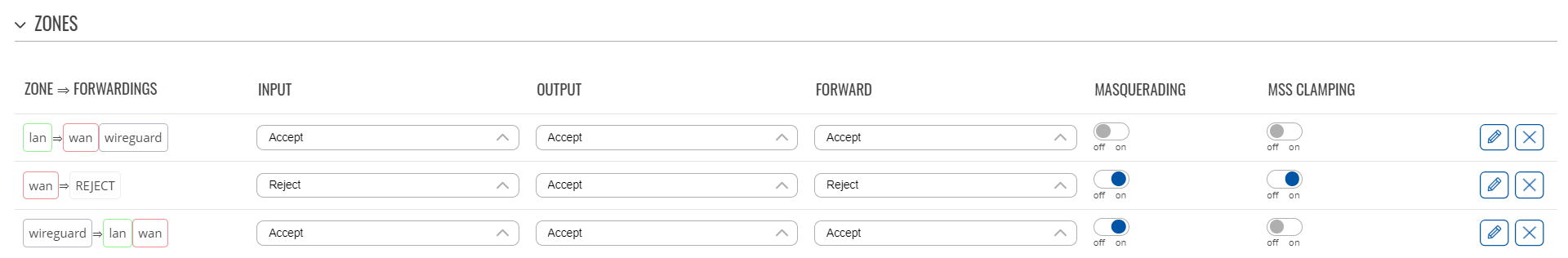

  1. This is my current firewall config for the RUTXR1 / site A. I have tried to copy the settings from the old RPi router/client to the best of my understanding. :upside_down_face:
    I wouldn’t be surprised if this is the culprit…

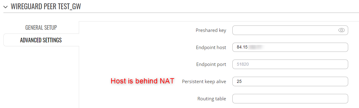

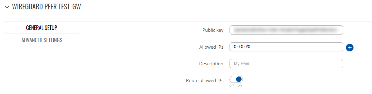

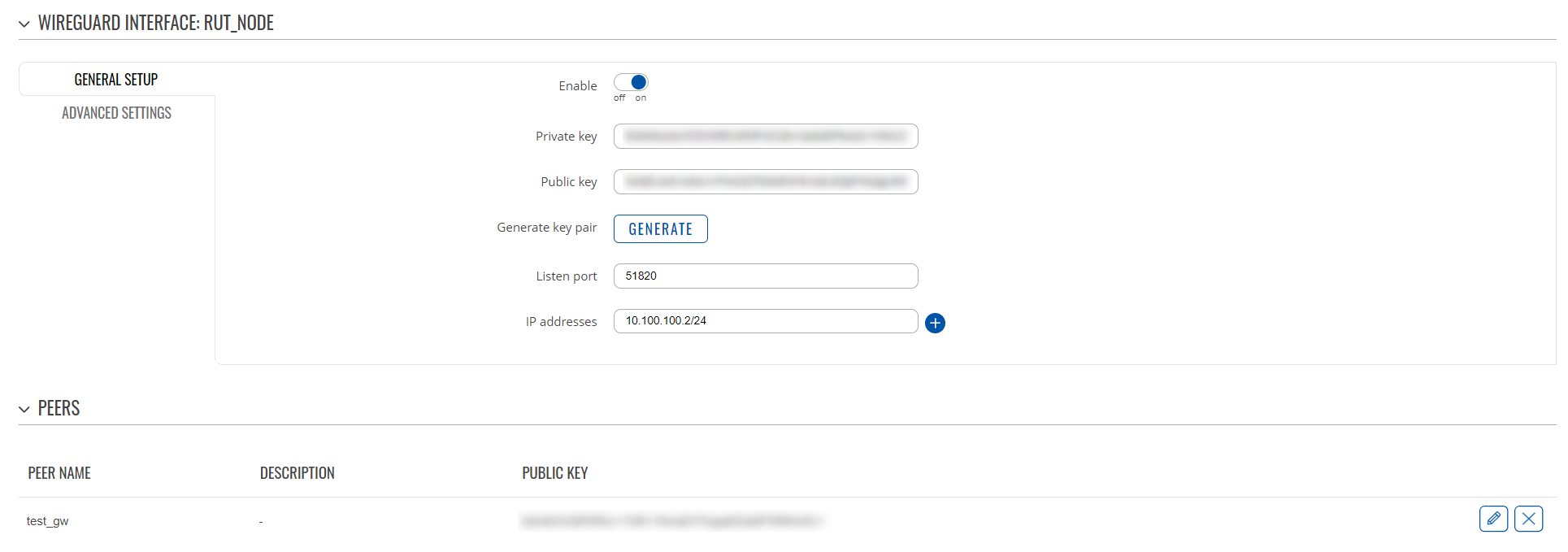

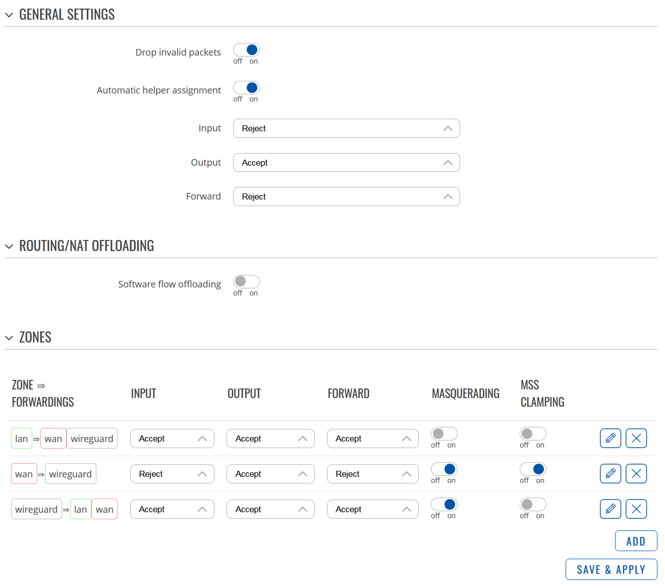

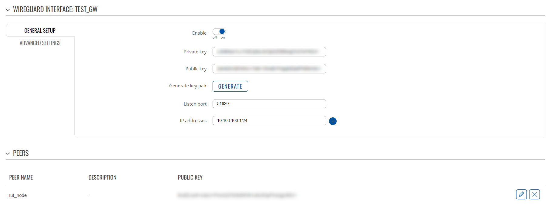

I’ve tried configuring your setup locally, and got it to work using the following settings:
When running traceroute from the RUTX10 (the node), all packets are routed via the Wireguard tunnel:
Since your configuration seems to be similar, I’d recommend double checking the RUTXR1 firewall settings, as well as making sure the WireGuard tunnel is established. Make sure that the DNS servers are added on the WireGuard node separately, as that may be causing issues.

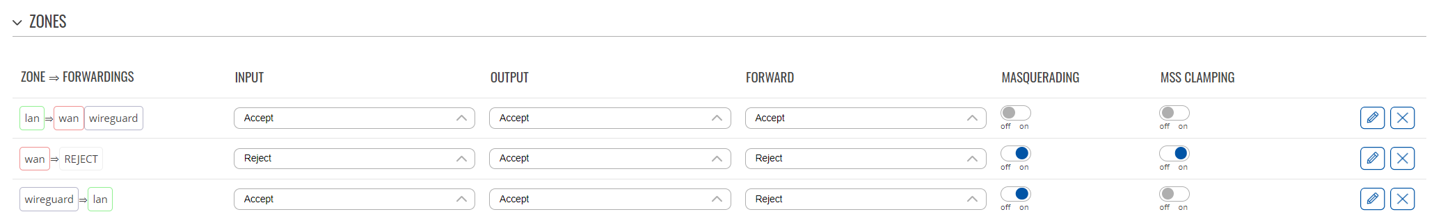

I have now gone through the configuration settings you supplied and noticed some variations compared to my set-up. These are my findings when adjusting to your recommendations:
  1. The firewall settings in the gateway (Site A in my case) differ in how your setup shows “wan => REJECT”, while I had “wan => wireguard” previously. After some trial and error, I think I got the hang of how to create zone forwardings, and now my configuration matches yours. This unfortunately didn’t have any (apparent) effect, ie. status quo.

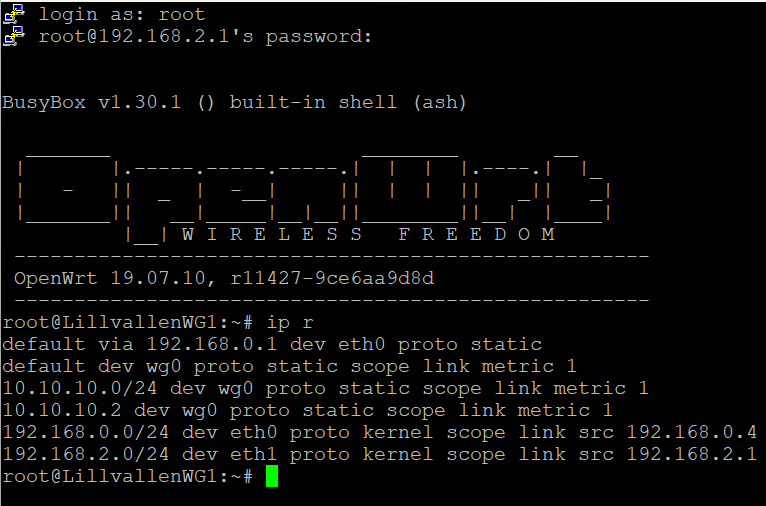

Could you post the output of ip r command on OpenWRT?
Make sure that Route Allowed IPs is enabled on 0.0.0.0/0 is specified as the routed network on the OpenWRT side. If the packets are being sent to the wrong interface, the issue may be related to the metric of Wireguard interface.
It should be noted that RUTXR1 should also have 0.0.0.0/0 as a routed address, as otherwise it will reject the packets.
Sure! This is the output of ip r when done from the console of the site B router:
