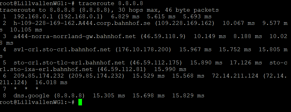

Just for clarity, this is the output of the traceroute 8.8.8.8 command when executed on the site B router:

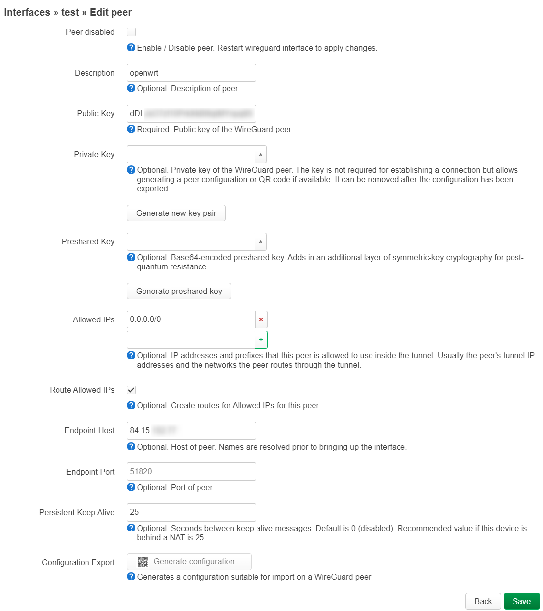

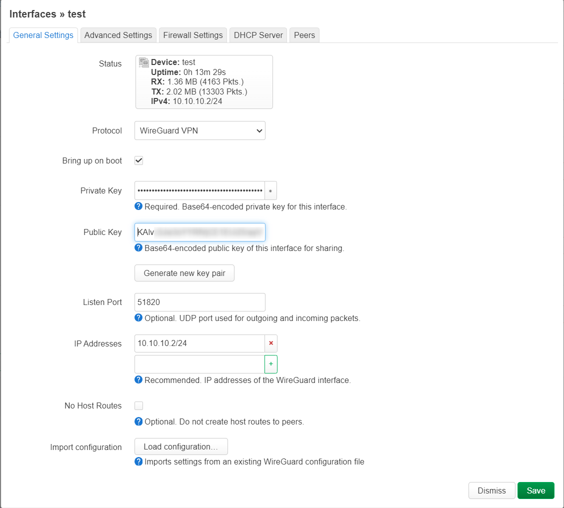

There is quite a lot of information in this thread, sorry if I got something mixed up. Went over the configuration once again, this time with an OpenWRT device:

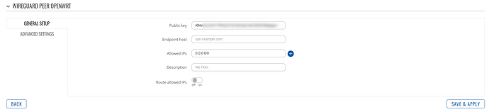

OpenWRT
WireGuard instance configuration:
WireGuard Peer configuration:

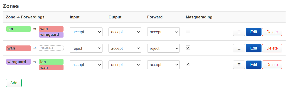

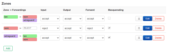

Firewall configuration:

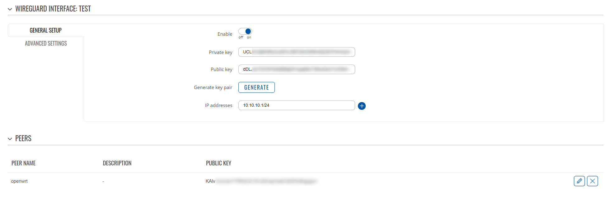

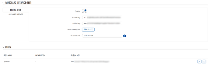

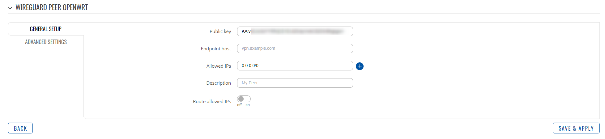

RUTX50
WireGuard peer configuration:
I think the issue previously was within the firewall of the OpenWRT router, as the WireGuard zone needs to be able to forward traffic to WAN as well, not only LAN. That’s why you were losing connection to the OpenWRT router.

I was about to implement the changes you described about the site B firewall settings, but before I do that, I would like to understand why? Don’t get me wrong, I’m not trying to be obstruent, but I’m a bit reluctant to make the change for the following reason:
- the B site is very far away. And it’s critical that I don’t loose contact with it, because if I can’t access the home automation system over there, I will get in a lot of trouble. So changes that could result in “cutting off the tree branch you’re sitting on” makes me very anxious. I have no means of reversing any configuration change other than getting on a train for six hours, and then bus for another hour. Not to mention the cost.
- Site B has been working with it’s current configuration for several years. The thing that changed is at site A, where the WG tunnel is now terminating in the edge router, instead of client inside the A network. This makes me wonder about why I need to change how the WG firewall zone forwarding is done on site B?
To my understanding, as long as the WG tunnel comes up correctly (which it does), I shouldn’t have to change anything in the config of site B. Or have I totally misunderstood what WG is? I’ve been under the impression that it is an interface like any other interface, wan for instance.

I also found this thread from OpenWRT that kinda supports my theory of how WG works: Understanding the 'Route Allowed IPs' option in Wireguard - Network and Wireless Configuration - OpenWrt Forum but then again, I have a limited understanding of how ip traffic is actually routed at a low level.

As per your question, I’m not sure how the setup worked before, as from your screenshot, I can see that WireGuard can only forward traffic to LAN, from which it will not be able to exit to the internet. Adding the WAN formwarding will not break the setup, however, changing the Wireguard settings could, and this is the part I’d like to double check.

Another thing about your comment on WG and routing: From the tests I have been doing on the B site router, it seems that OpenWRT differentiates its behaviour between the router itself, and traffic being routed through it. Which would explain why I can get things like ping and traceroute to work on the router itself (by exiting directly though the wan interface), whilst the same traffic coming in through the lan interface gets redirected to the WG interface. The WG instance seems to be implemented in such a way that it implicitly uses the wan i/f for its tunnel side (10.10.10.2). And being a virtual device on the router itself, it doesn’t have to adhere to the firewall rules, hence bypassing them directly to wan. This behaviour would be in line with the ping and traceroute executed from the routers CLI.
Perhaps I got this totally wrong, but this is my conclusion from the behaviour I can observe. ![]()

That’s right, the router itself is considered as Device (input) in the firewall rules, thus any traceroute tests should be performed from the LAN client. This is the same for both OpenWRT and RutOS.
