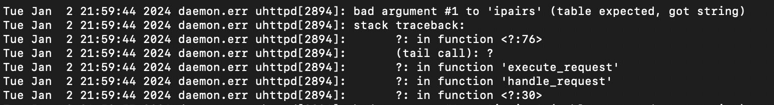

In the SSH console I get the error messages shown in the screenshot above, if I click on “save & apply”. I don’t know if that is related.
If I start the broker manually in the SSH console “mosquitto -c /etc/mosquitto/mosquitto.conf” no error message is shown
It seems like there are some issues regarding uhttpd based on the given screenshots, but cannot confirmed yet. But kindly try restarting both the uhttpd and mosquitto services through CLI using the commands below:

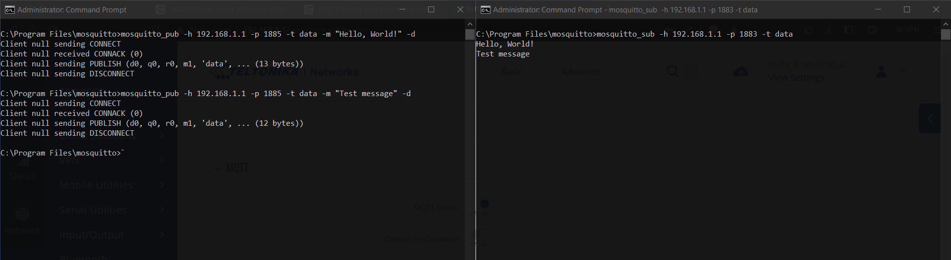

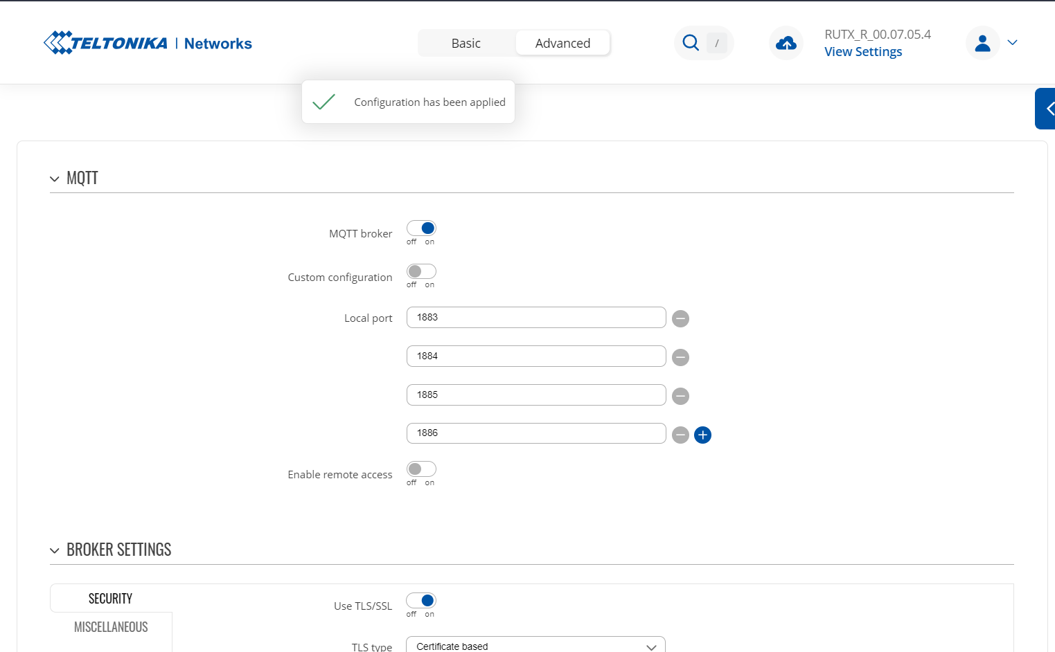

I conducted a little test on my side where I used a RUTX11 running the FW: 07.05.4 to see if I can recreate the issue that you’re having but I didn’t managed to do so. I can change some configurations in the WebUI successfully while running mosquitto clients at the background.
Kindly try if restarting the services mentioned above will allow you to change the configuration again.
