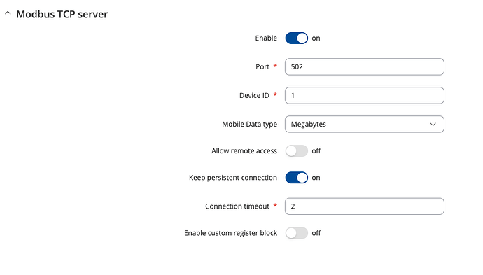

Device: RUTX09, Hardware revision 0505 batch0019
SERVICES > MODBUS > MODBUS TCP SERVER
“Mobile Data type” No longer works as a function/setting.
I have customised setups where data usage is monitored. This is now broken after a firmware update. It was set to Megabytes. However the data streamed is only in Byte.

Steps to reproduce the bug
Changed setting to “Megabytes” saved in Web-Interface/UI + Reboot. Modbus is still sending streamed data in Byte.

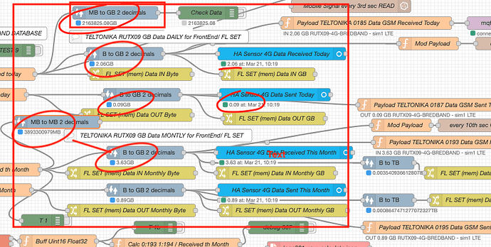

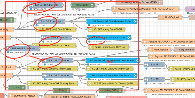

Data received :
Modbus data Register Address 185-199.
Data received with the Megabytes setting is sent as Byte.
Documented in our test with nodes reading MB to GB: Showing the wrong result. While the changed nodes reading B to GB is showing the correct data.
Web-Interface:
What is the wrong behaviour?
Modbus data Register Address 185-199. Reading Received in “Mobile Data type” Megabyte wont change the output of the chosen/picked and saved unit. Still sends the data in Byte.
