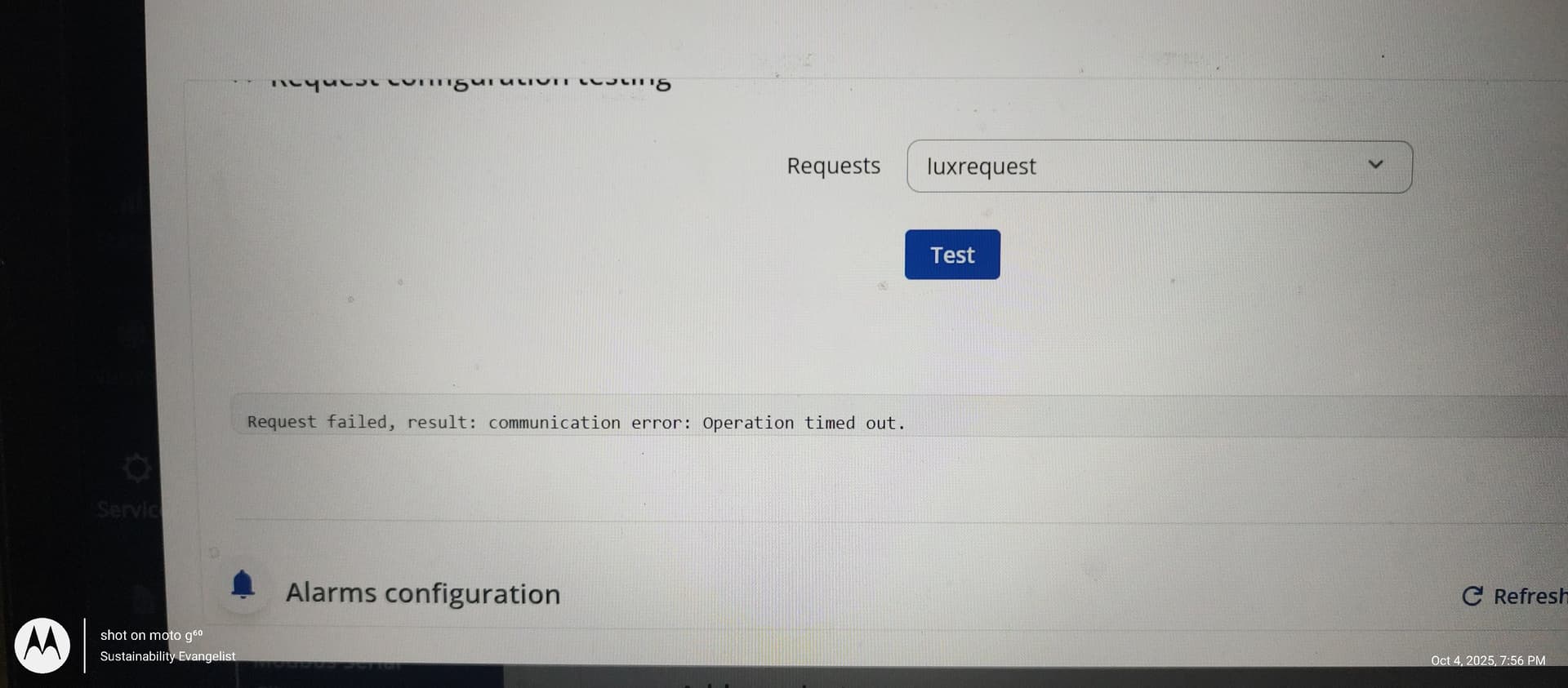

I have connected below mentioned lux sensor to TRB145. Upon clicking Test button getting error”Request failed, result: communication error: Operation timed out.
request configuration:
Datatype: 32bit float 1234
Function: Read holding registers 3
First register 2
Register count 2
I have tried various combinations including above but issue persist

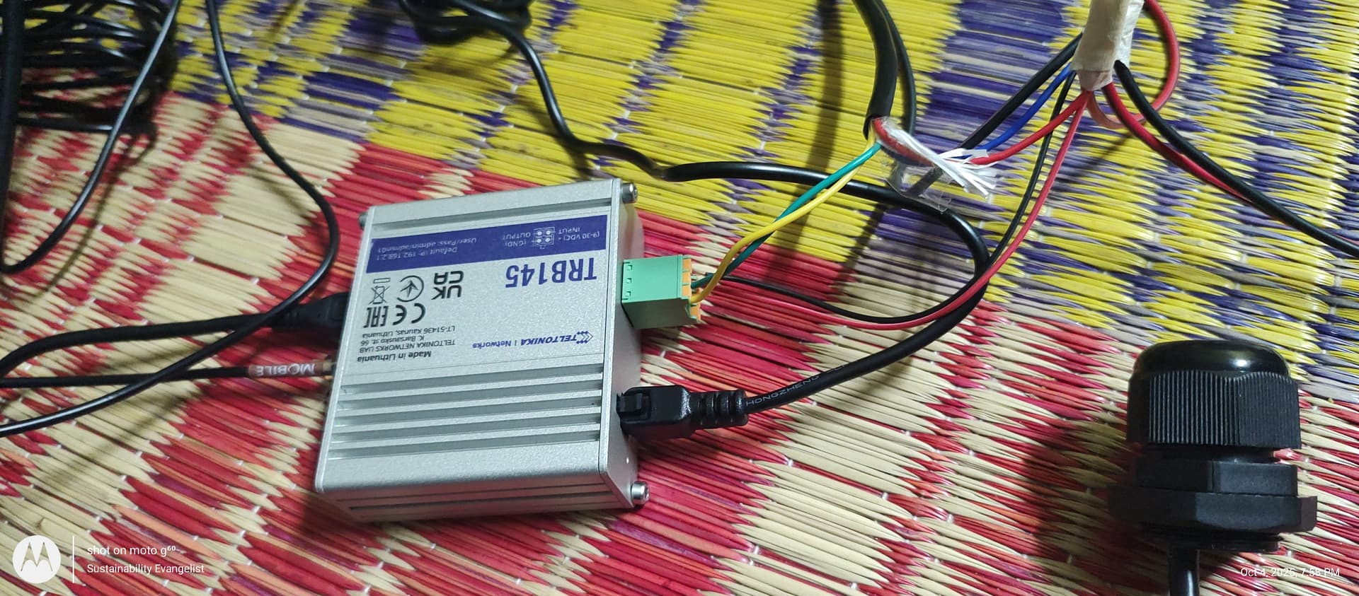

Thank you for reaching out.
Could you please first check and confirm that the RS485 wiring is correct, as described on a relevant thread here:
It is working now. Thanks
