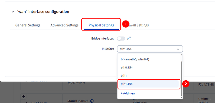

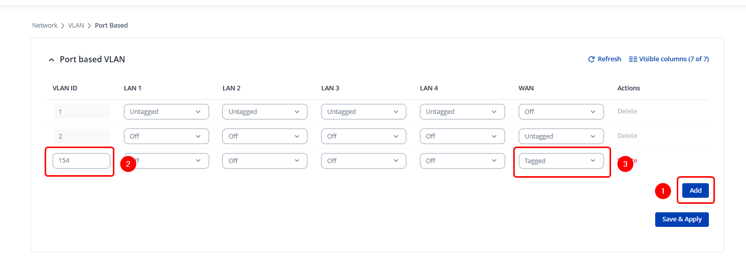

To add a tagged VLAN on the WAN interface, please follow the steps below:
After these changes, the device should start obtaining the IP address:

Thank you for the configuration settings, tested, working like charm.
Thank you.
Thanks for getting back, glad it worked!
