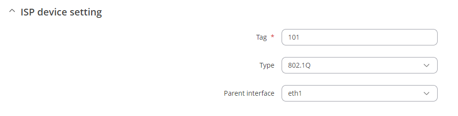

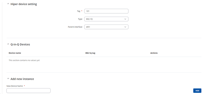

The correct configuration here would most likely look like so:
  • Navigate to Network → VLAN → Interface Based;
  • Create a new instance with any name (I’ll call it ISP for simplicity);
  • Once the configuration opens up, configure it as follows:

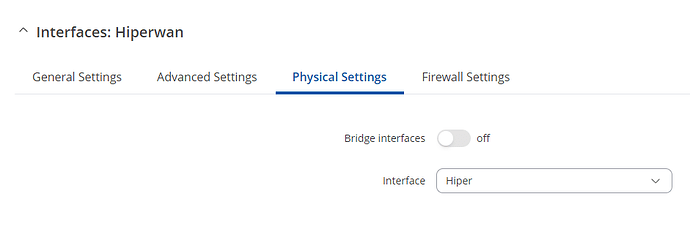

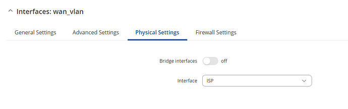

  • Save and Apply the changes. Then navigate to Network → WAN;

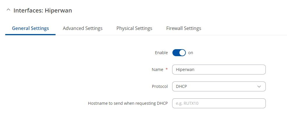

  • Create a new interface, specify a descriptive name, and configure the protocol as DHCP;

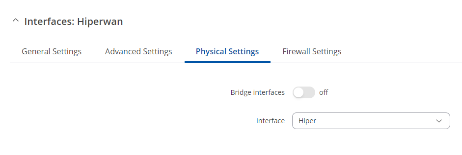

  • Under the Physical Settings tab, specify the created VLAN interface:
Save and apply the settings and check if the connection establishes.

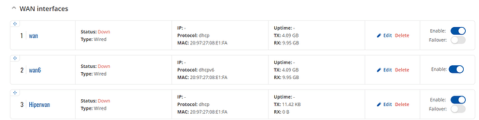

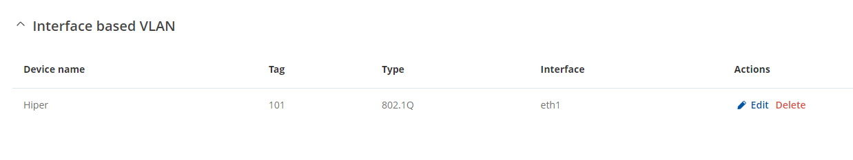

Thanks alot for giving it an attempt Daumantas!

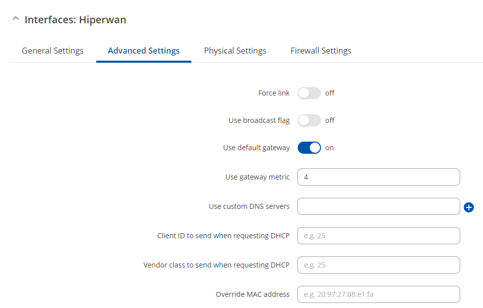

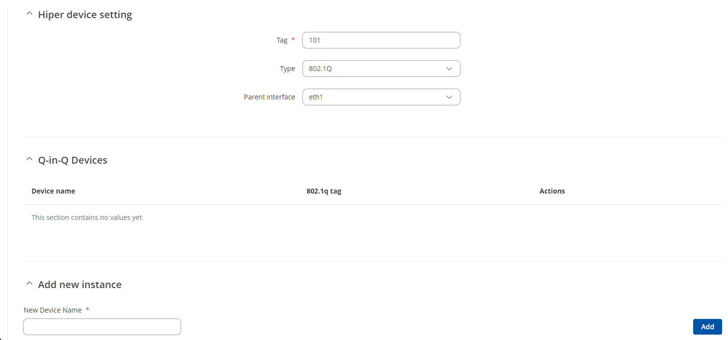

if i understand you correct, it did not work. I got no IP adress.
Any other suggestions?
Apologies for a late response.
You seem to have configured everything correctly - 101 VLAN tag is applied on the WAN port of the device. Perhaps you could contact your ISP to check if they can see the DHCP requests coming in from their side?
