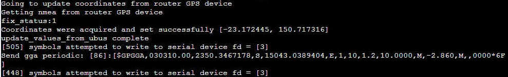

Screen shot attached from the RUTX50 CLI running NTRIP, local time was 11:03am, UTC time 01:03
GGA UTC time 030310.00 is actual +2 hours
-23.172445 => -23 10.34670’ GGA Lat = 2350.3467178’ and actual +40 minutes higher

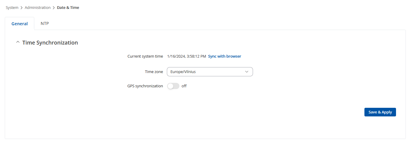

To address the most apparent issue, please check if your time zone is set correctly. This could be the cause of the problem. If the time zone is accurate and the issue persists, we’ll need to investigate further.
You can find Date & Time settings System → Administration → Date & Time.
Marijus
Thank you Marijus,
Confirm there are no issues with time indications on the RUTX50, all instances are correct. This was also confirmed in previous support (now closed) for the same issue noted on a RUT955 going back to Sepetember/November 2023.

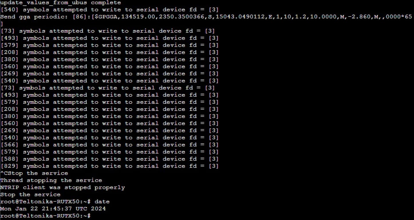

Another example with the router set to UTC, UTC time is correct, GPS time is correct, GGA UTC incorrect and now appears 8 hours behind actual UTC time? It could be 16 hours ahead but I doubt this scenario
