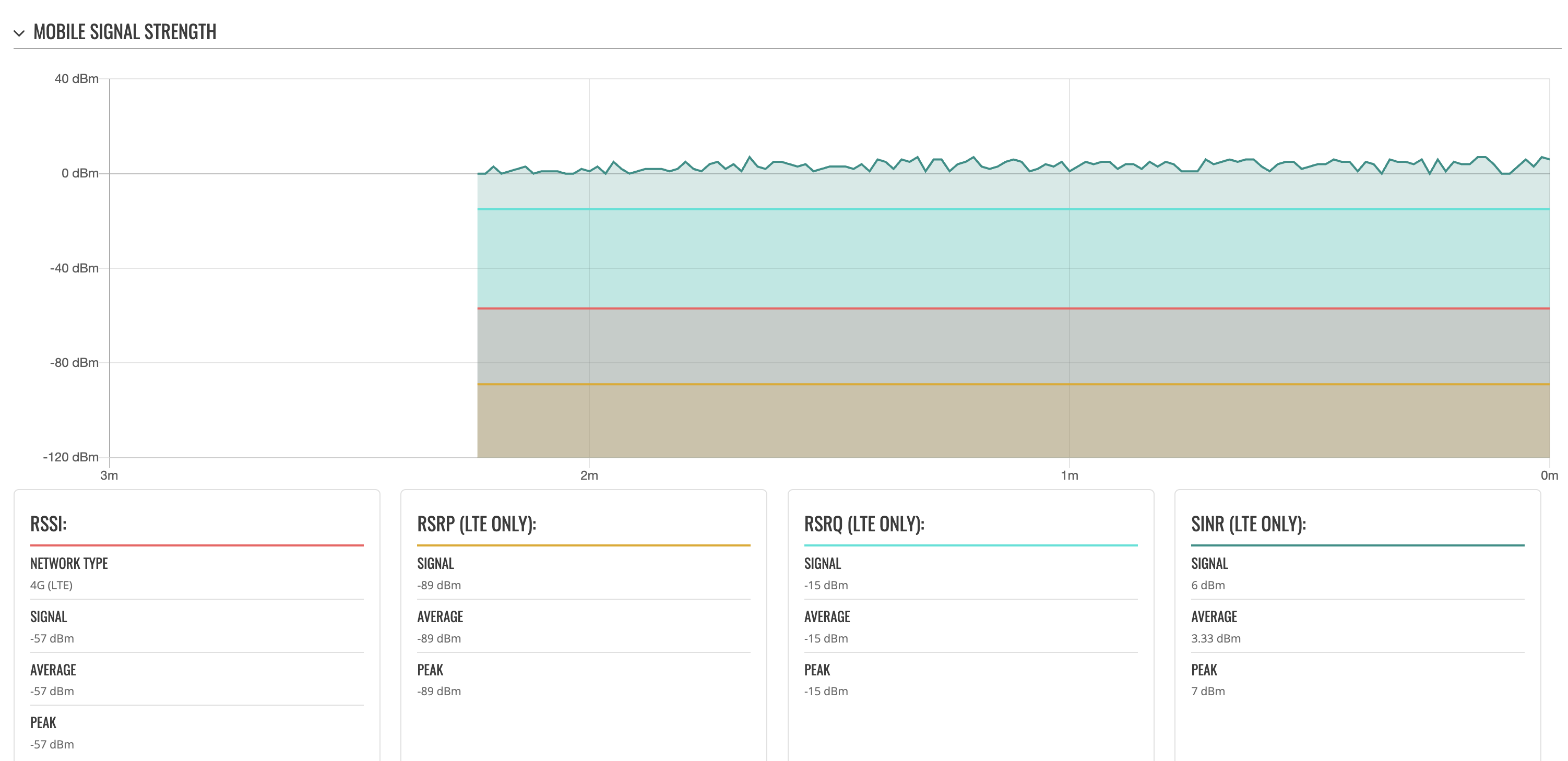

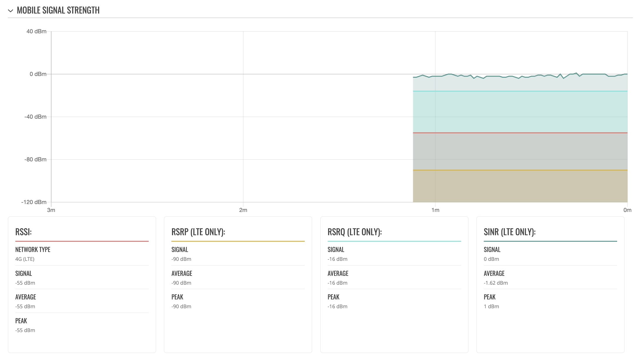

@flebourse Believe it or not, just got around to installing those inline 15dB attentuators. Here’s how things are looking now. Not sure if this is an improvement? What do you think?
Speed test via the mob1s1a1 interface is reporting ~7Mbit down x 26Mbit up. Not bad, but I’m not sure if I should try a different, slightly lower rated maybe 10dB? Or just leave it alone.
The SINR is still very bad the other values are more in line with common cases.

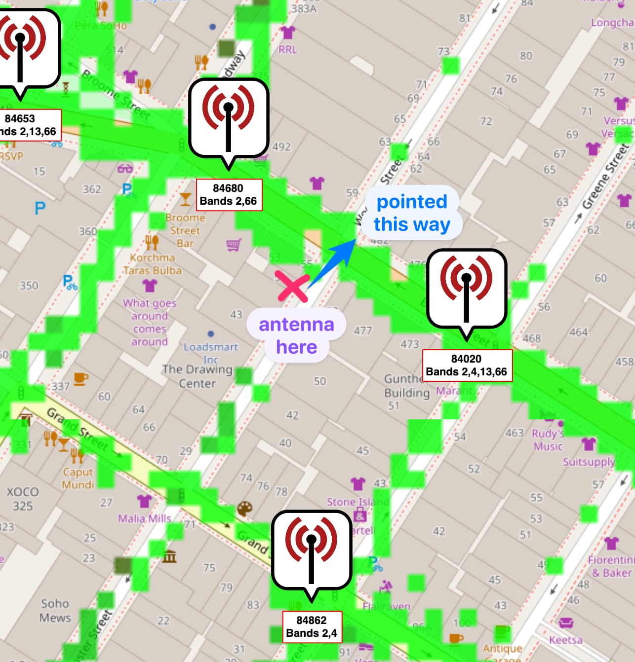

@flebourse Thanks. Will go back when the weather’s good. Here’s an image from Cellmapper that shows the area. I changed the radio from locked to B4 to “Auto” and it’s now switched itself to B2, with ever-so-slightly better looking signals.

Try to point the antenna towards one tower, choose the one that has a band with the largest width.
Edit: I didn’t look carefully enough, but you have four cells on the B2 band in the vicinity… This will generate a lot of interferences.
