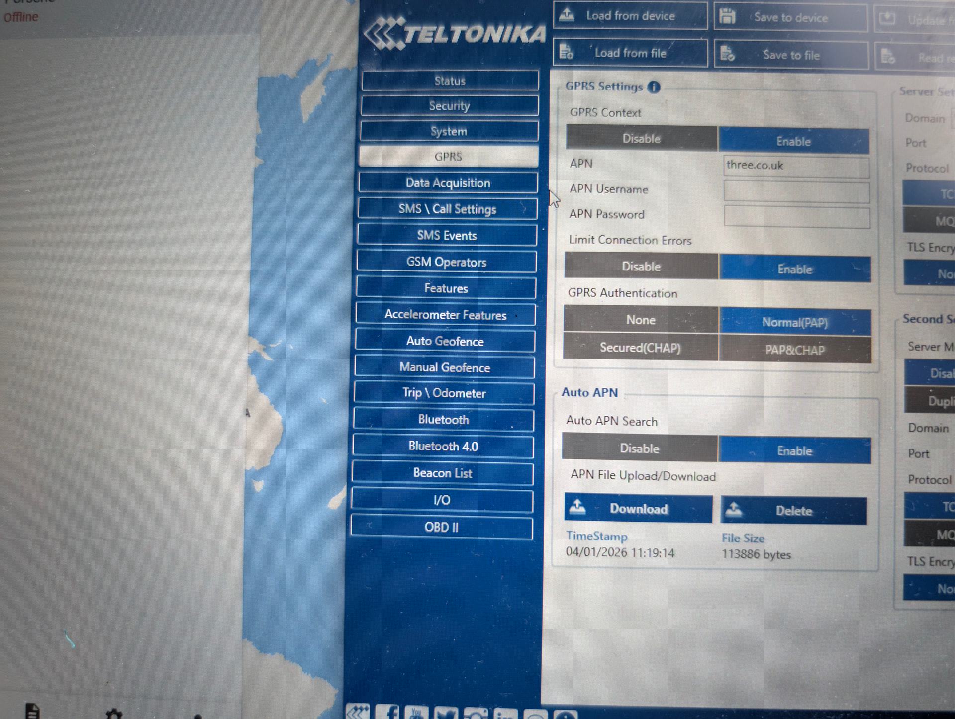

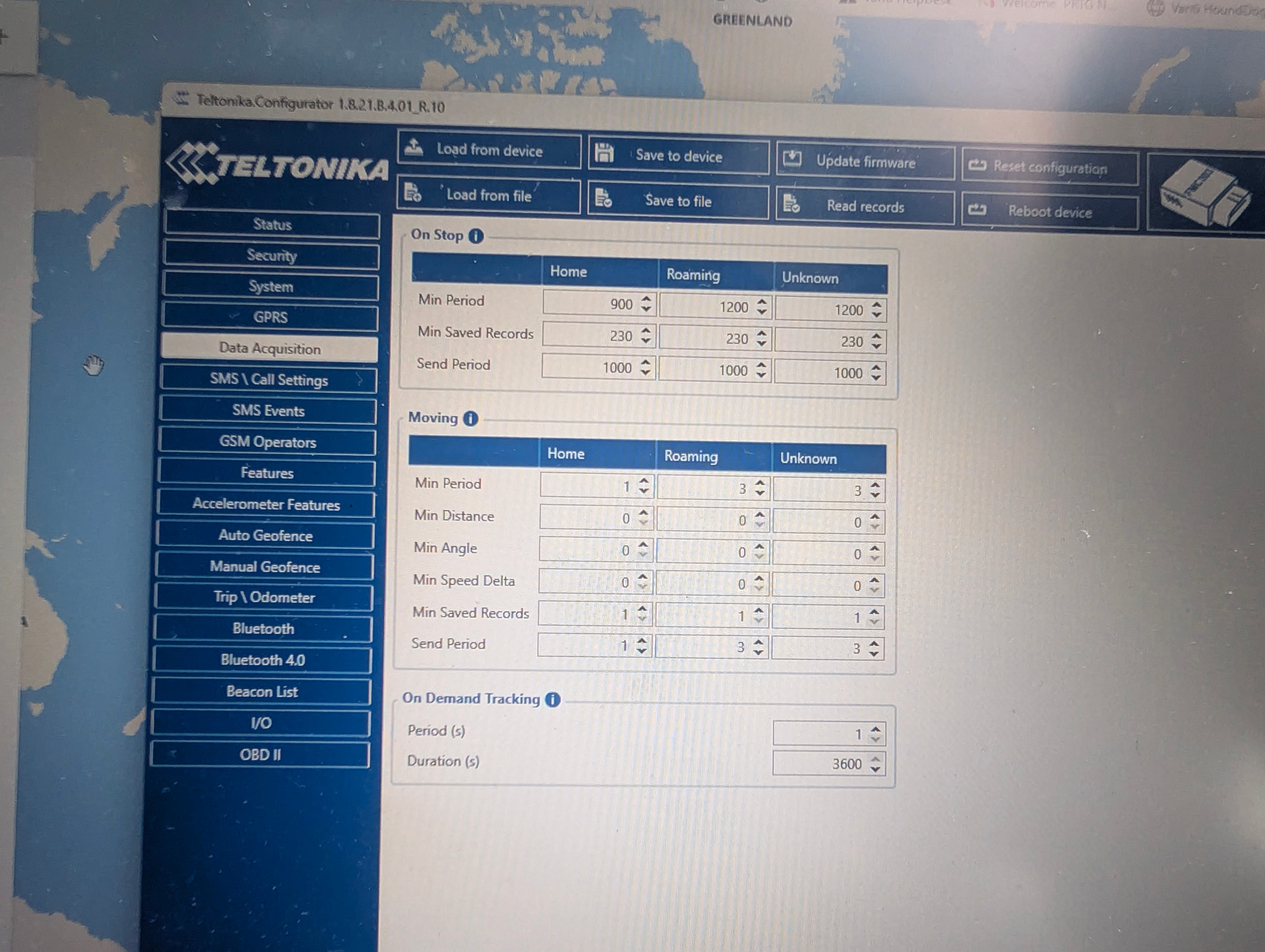

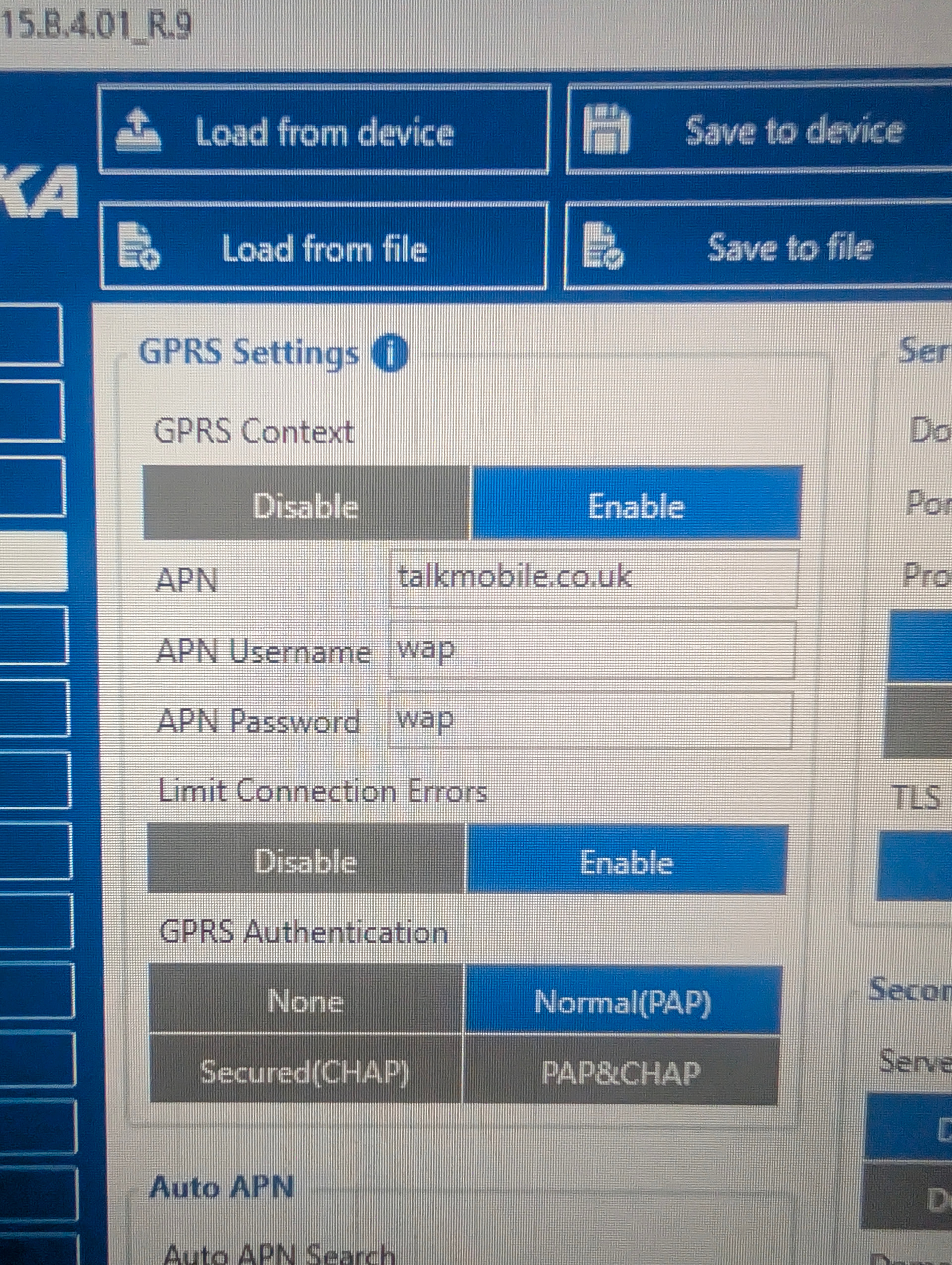

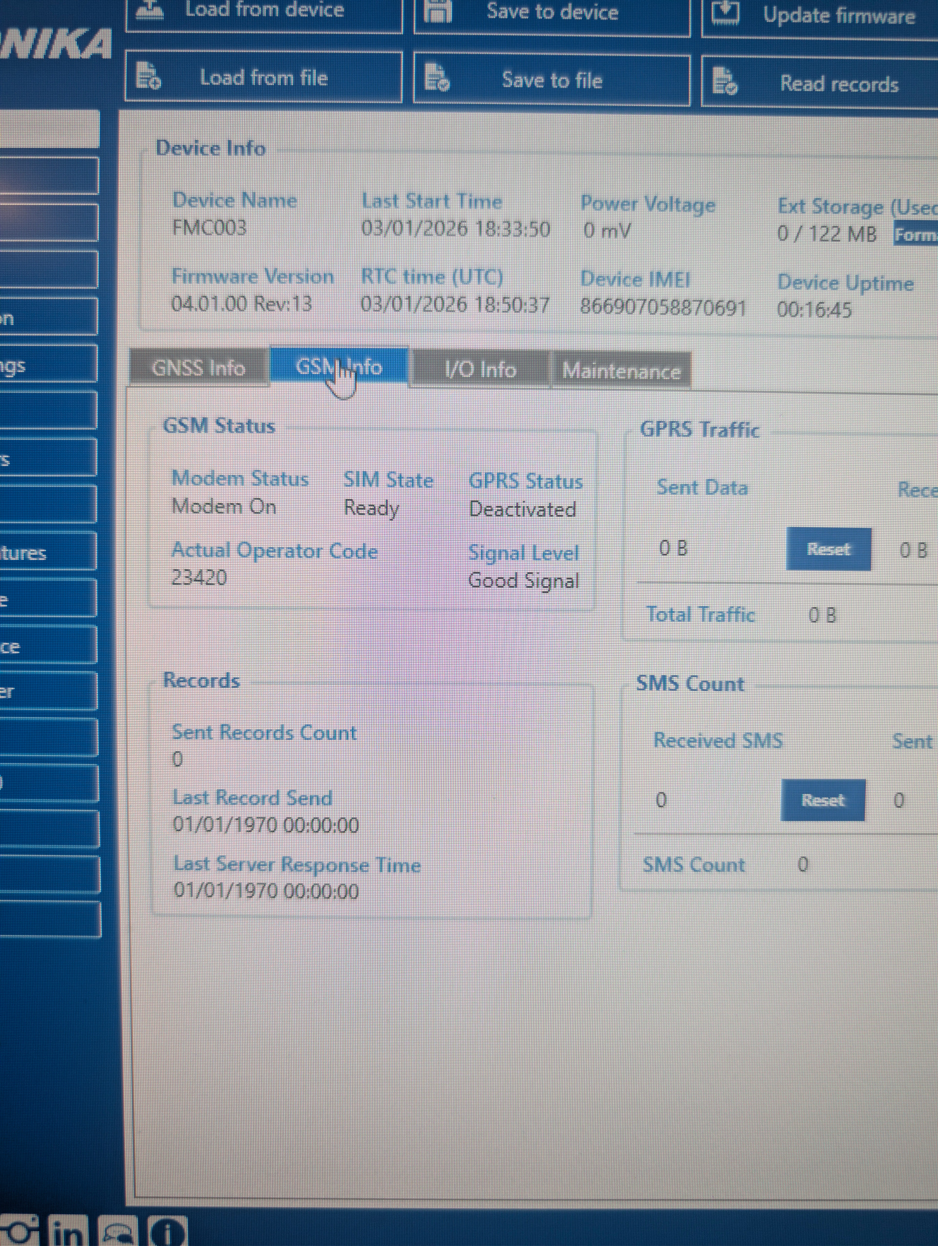

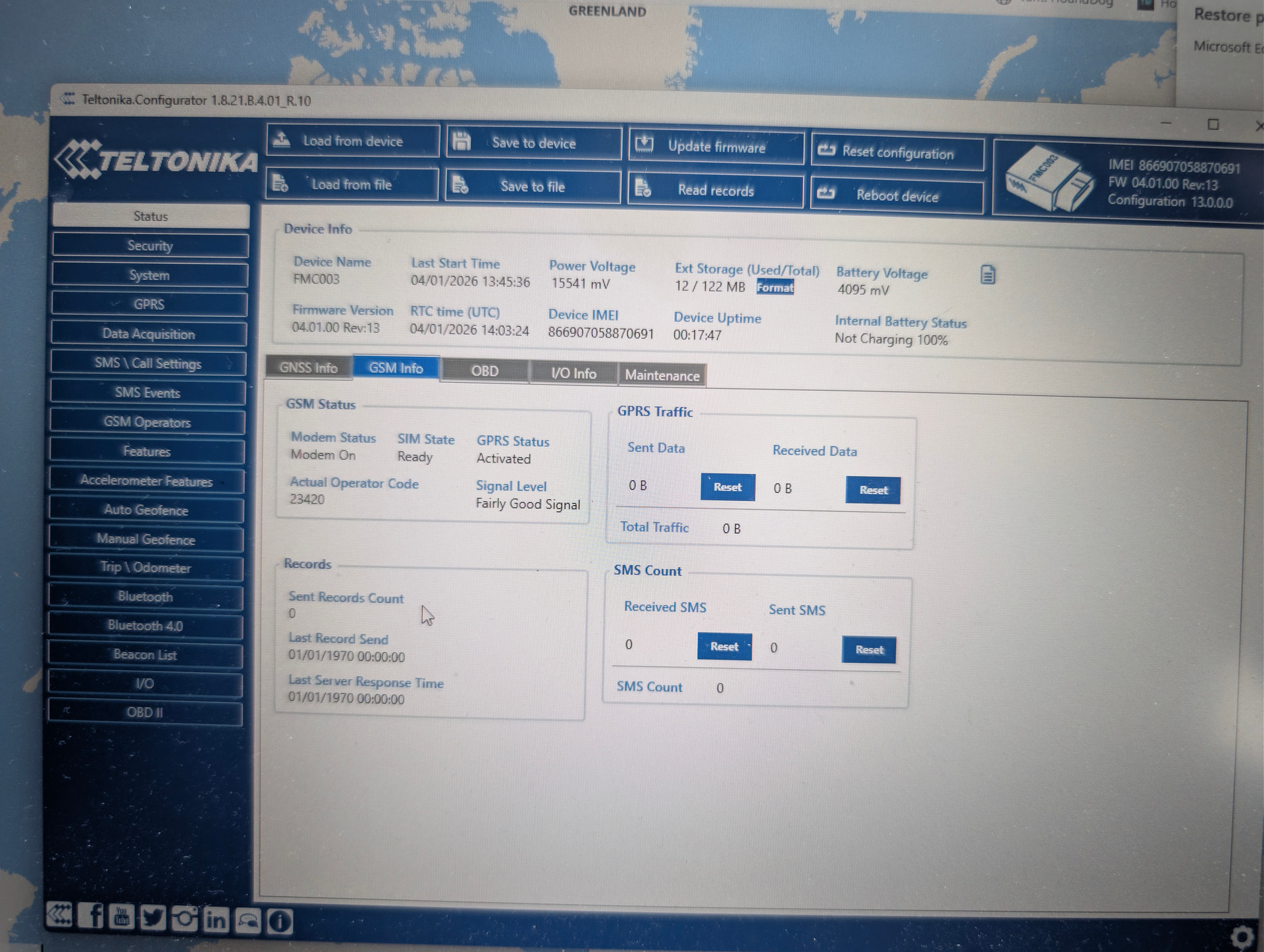

Hi all, I’m wondering if you can help, as of the 22nd of December my FMC003 has stopped sending data. I thought it was a SIM issue but have tested SIM in a mobile and it’s fine, I have tried another SIM card and although it goes activated on GPRS Status, it does not send any data.
Just to add sometimes the GPRS status says activated but still no data is being sent
Still not sending data, sim card has been confirmed as okay as its been tested in a phone. Another sim has also been tried but same issue.

you have an issue in the.
  • APN name
  • Domain,
kindly use the correct APN as it is provided by the provider, and use your server IP, not the domain,
BR
Laith
Both are correct and hadn’t changed from when it started working to when it stopped
try to use the server IP instead of the Domain
Tried this. Same issue.

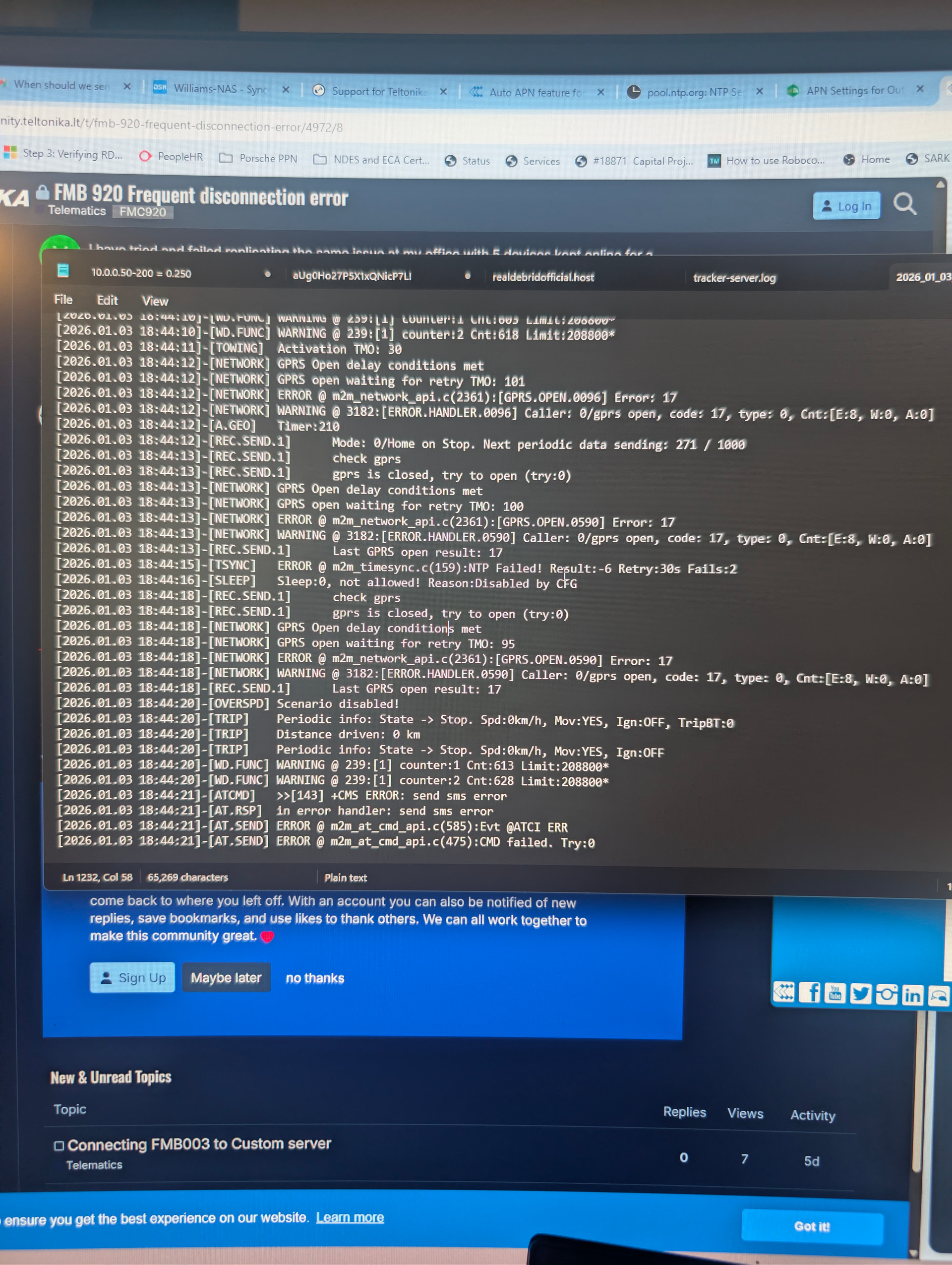

Here’s another log taken today, why is the device trying to register network as IMS when it’s data only SIM? Is this the issue?
2026.02.02 12:17:58]-[ATCMD] >>[214] +CME ERROR: Excute command failure
[2026.02.02 12:17:58]-[ATCMD] >>[232] +CREG: 2,3,“04fe”,“000dac02”,7
[2026.02.02 12:17:58]-[AT.RSP] Status: 3 (Registration Denied)
[2026.02.02 12:17:58]-[MDM.ALT] Trying with secondary APN (CID 0): ims
[2026.02.02 12:17:58]-[ATCMD] <<AT+CGDCONT?
[2026.02.02 12:17:58]-[ATCMD] >>[212] +CGDCONT: 0,“IP”,“ims”,“0.0.0.0”
[2026.02.02 12:17:58]-[ATCMD] >>[212] +CGDCONT: 1,“IP”,“ims”,“IPV4:0.0.0.0”,0,0
[2026.02.02 12:17:59]-[ATCMD] <<AT+CFGDFTPDN=1,1,“ims”,“”,“”
[2026.02.02 12:17:59]-[ATCMD] <<AT+CGDCONT=1,“IP”,“ims”
[2026.02.02 12:17:59]-[ATCMD] <<AT+CGACT=1
[2026.02.02 12:18:00]-[ATCMD] >>[214] +CME ERROR: Excute command failure
[2026.02.02 12:18:00]-[ATCMD] >>[232] +CREG: 2,3,“04fe”,“000dac02”,7
[2026.02.02 12:18:00]-[AT.RSP] Status: 3 (Registration Denied)
[2026.02.02 12:18:02]-[NETWORK] ERROR @ m2m_network_api.c(2361):[GPRS.OPEN.0590] Error: 19
[2026.02.02 12:18:02]-[MDM.ALT] Trying with primary APN (CID 1): ims
[2026.02.02 12:18:03]-[ATCMD] >>[232] +CREG: 2,3,“04fe”,“000dac02”,7
[2026.02.02 12:18:03]-[AT.RSP] Registration Denied
[2026.02.02 12:18:09]-[NETWORK] ERROR @ m2m_network_api.c(2361):[GPRS.OPEN.0590] Error: 17 (Network Not Allowed)
[2026.02.02 12:18:11]-[NETWORK] ERROR @ m2m_network_api.c(2361):[GPRS.OPEN.0366] Error: 17
[2026.02.02 12:18:17]-[ATCMD] <<AT+CREG?
[2026.02.02 12:18:17]-[ATRSP] >> +CREG: 2,2,“04fe”,“000dac02”,7 (Status 2: Searching)
[2026.02.02 12:18:17]-[ATCMD] <<AT+QCSQ
[2026.02.02 12:18:17]-[ATRSP] >> +QCSQ:“NOSERVICE”
[2026.02.02 12:18:17]-[ATCMD] <<AT+CESQ
[2026.02.02 12:18:17]-[ATRSP] >> +CESQ: 99,99,255,255,25,26 (#RSRQ: -7.5 dB | #RSRP: -115 dBm)
[2026.02.02 12:18:17]-[ATCMD] <<AT+QNWINFO
[2026.02.02 12:18:17]-[ATRSP] >> +QNWINFO: “FDD LTE”,“23420”,“LTE BAND 3”,1363 (Three UK)
[2026.02.02 12:18:17]-[ATCMD] <<AT+CSQ
[2026.02.02 12:18:17]-[ATRSP] >> +CSQ: 12,99 (Approx. 3 bars)
[2026.02.02 12:18:19]-[NETWORK] ERROR: 17
[2026.02.02 12:18:19]-[ATCMD] >>[232] +CREG: 2,3,“04fe”,“000dac02”,7
[2026.02.02 12:18:19]-[AT.RSP] Registration Denied (Status 3)
[MODEM.STATUS]
  CCID        : 8944200204798029010
  GSM Operator: 23420 (Three UK)
  GPRS Status : 0
  Service     : 0
  CSQ (rssi)  : 13
  QCSQ (rsrp) : -114 dBm
  QCSQ (sinr) : -23.5 dB
  QCSQ (rsrq) : -7.5 dB
  AT dead cnt : 136
Hello

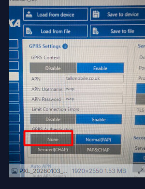

Kindly try to use without GPRS authentication
I see that the device is not able to register into the operator, so this could be a coverage issue as the signa is not enough good or the operator is not accepting the SIM card
@laith.sa
The operator is not accepting as for some reason since firmware update device is requesting IMS which is VOLTE and SIM would not work as it’s data only no voice which I believe is why it gets rejected.
I know it’s device FMC003 related, as SIM works fine in mobile phone (data only)
I have tried with none on GPRS authentication
