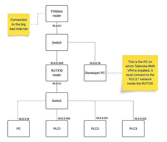

Let me explain my network setup shortly:
A FRITZ!Box 7590 that is connected to the ‘real‘ internet.
The RUTX10 (10.0.0.200) is In the local network of this fritzbox (10.0.0.1).
The local network inside the RUTX10 (10.0.3.1) has a few devices: 10.0.3.10 (PC), 10.0.3.100 (PLC), 10.0.3.101 (PLC).
My goal was to create a VPN connection so I can access the devices in the 10.0.3.* local network.

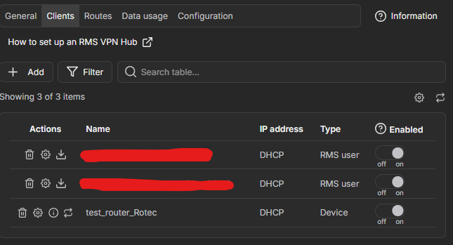

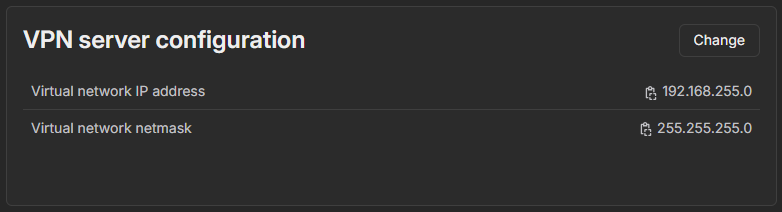

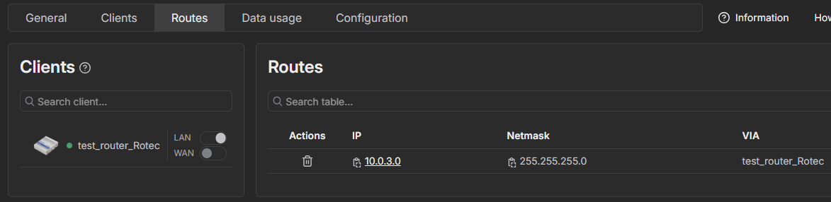

So I added the RUTX10 to RMS and created a VPN hub:
Connecting with either OpenVPN Connect or Teltonika RMS VPN sometimes works, but when it does, it is very unstable and flaky. This is an example when pinging 10.0.3.1 (RUTX10) from my remote pc:

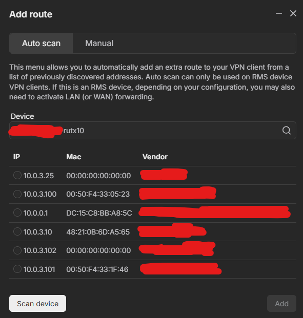

Thank you for reaching out. A couple of things to double-check:
  • Do the PLCs have their default gateway set to the RUTX10 LAN IP (10.0.3.1)?
  • Can these devices actually be seen in the RUTX10’s ARP table (arp -a) or at least be pinged directly from the RUTX10 itself?
If those look fine, you can also try following the suggestions provided in similar topics here:
Additionally, whenever you make changes on the RUTX or in the VPN settings for testing, it’s good practice to regenerate the client certificates for the RUTX and restart the VPN hub.
Let me know how it goes.

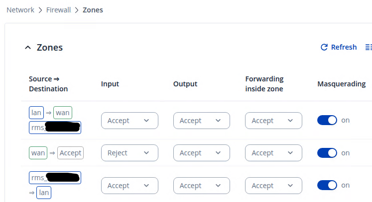

The devices within the RUTX10 lan are visible from the RUTX10, as can also be seen with a scan:

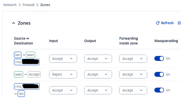

The masquerading mentioned in the community posts was already on because I had looked through the community before posting.

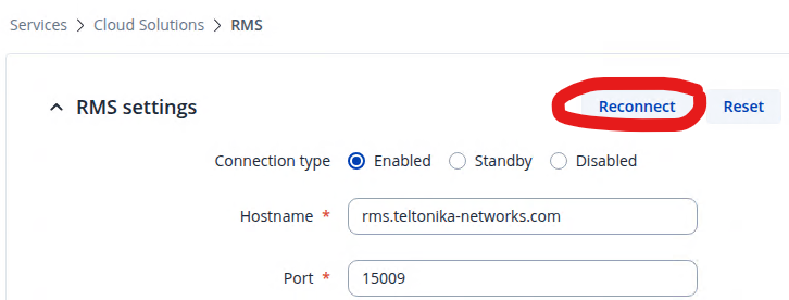

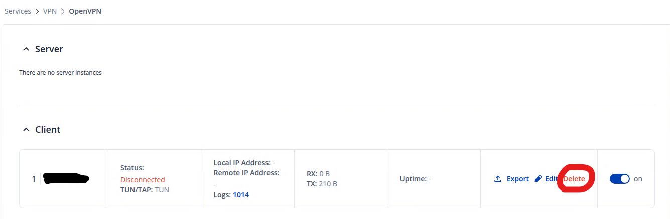

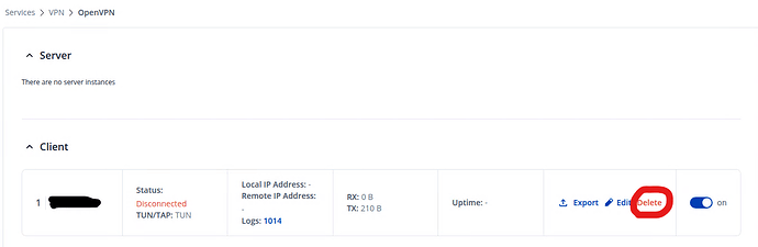

Where is the button to regenerate client certificates? I could not find it, so I assumed if I just fully recreate the RMS to RUTX10 connection the certificates are renewed.
What I did to achieve new client certificates:
  • Delete the VPN Client in the RUTX10
  • Delete the VPN hub in RMS
  • Remove/detach the device completely from RMS
  • Re-add the device in RMS
  • Recreate the VPN hub in RMS
  • Reconnect the RUTX10 to RMS
  • Update the firewall zone settings to include the new automatically generated VPN Client
  • Reboot the RUTX10
This solved my problem yesterday (stable connection with access to full lan), however when I got back to work this morning I got the unstable connection again.

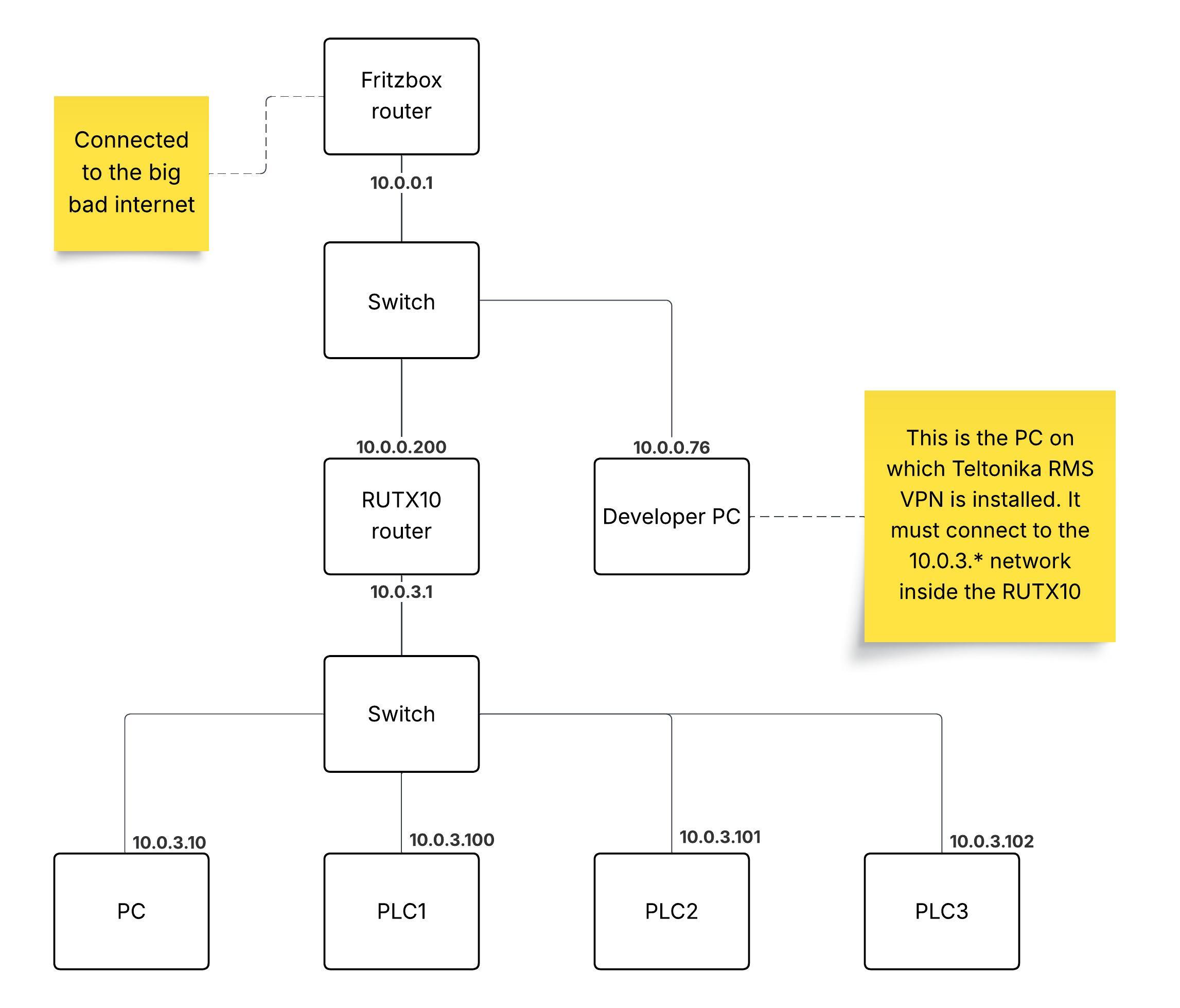

Here’s a visual network overview in case that helps:
Hello @JP-Rotec,
Thank you for the additional clarification and provided topology. Your setup is much clearer now. The main goal is simply to reach the RUTX LAN (10.0.3.X) from the Fritzbox WAN-side network (10.0.0.X).
In this case, you don’t actually need a VPN. The same result can be achieved with simple static routing. A very similar setup was discussed and achieved in this thread here:
Basically, to achieve this, you’ll need a couple of things:
  • On the Fritzbox, create a static route to destination 10.0.3.0/24 (RUTX LAN) via gateway 10.0.0.200 (RUTX10 WAN IP).
  • On the RUTX10, add a static route to destination 10.0.0.0/24 (Fritzbox LAN side) via gateway 10.0.0.1 (Fritzbox LAN IP).
  • In the RUTX firewall zone settings, allow forwarding from the WAN zone to the destination LAN zone:
I hope this helps or at least gives you some useful insight into your desired setup.
