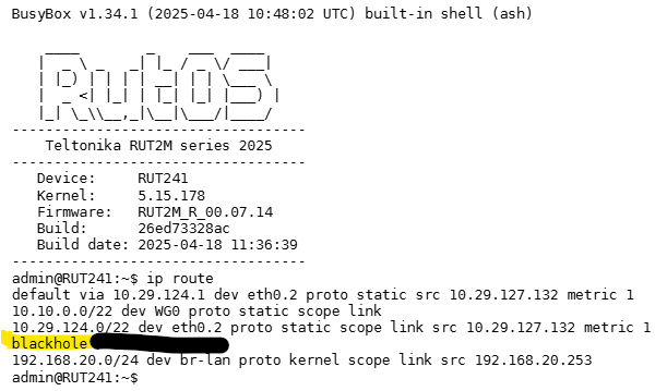

The issue is that this configuration forciebly adds a blackhole route in the routing table:
I can manually remove this blackhole, but at every reboot of the device it is added again. Is there some option to avoid this blackhole when configuring a Wireguard tunnel ?

Could you please first update the device’s RutOS firmware to the latest version, 7.14.2? The correct update guidelines are provided in the topic here: Important Note About Firmware Update

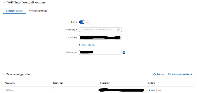

Regarding the WireGuard configuration issue, to better understand it, could you please provide a screenshot of your peer’s configuration page?
