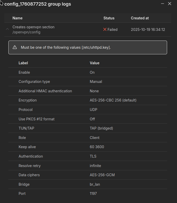

Configuring OpenVPN via RMS fails
I am trying to configure an OpenVPN connection on a RUTX8 (Firmware 7.17.5) via RMS. This has worked some times yesterday, but I had to go through repeated revolutions while finding out which settings to do to make the tunnel work with my remote. Today, I cannot configure the router with the RMS any more. The connection first times out, and then the configuration fails with “Must be one of the following values [/etc/uhttpd.key]” without any more explanation.
uhttpd.key has something to do with LUCI on regular OpenWRT installation, not with OpenVPN. I guess this is totally unrelated to what I am trying to do.
Please advise how to fix this.
Greetings, Marc

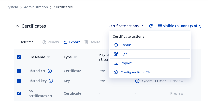

  • System → Administration → Certificates yields the attached dialog. How would I Regenerate or Reapply a certificate/key pair on that dialog? Am I supposed to select “create” here?

You can create or import certificates in System → Administration → Certificates by pressing the Create or Import button. Detailed instructions on how to generate or manage certificates can be found here:

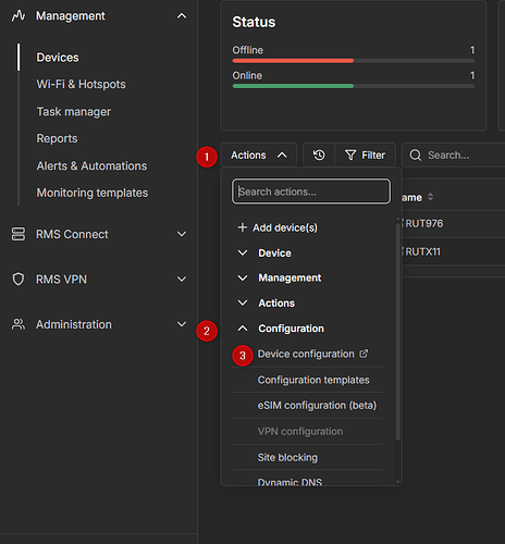

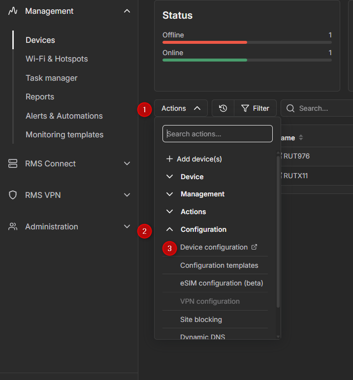

If your goal is to connect the RUTX8 to your own OpenVPN server, you’ll have to configure an OpenVPN client interface via the WebUI (or RMS) separately, without using the RMS VPN Hub.
To do so, select the device in RMS, then go to Actions → Configuration → Device Configuration. This will open a page where you can view and edit the device’s configuration remotely.

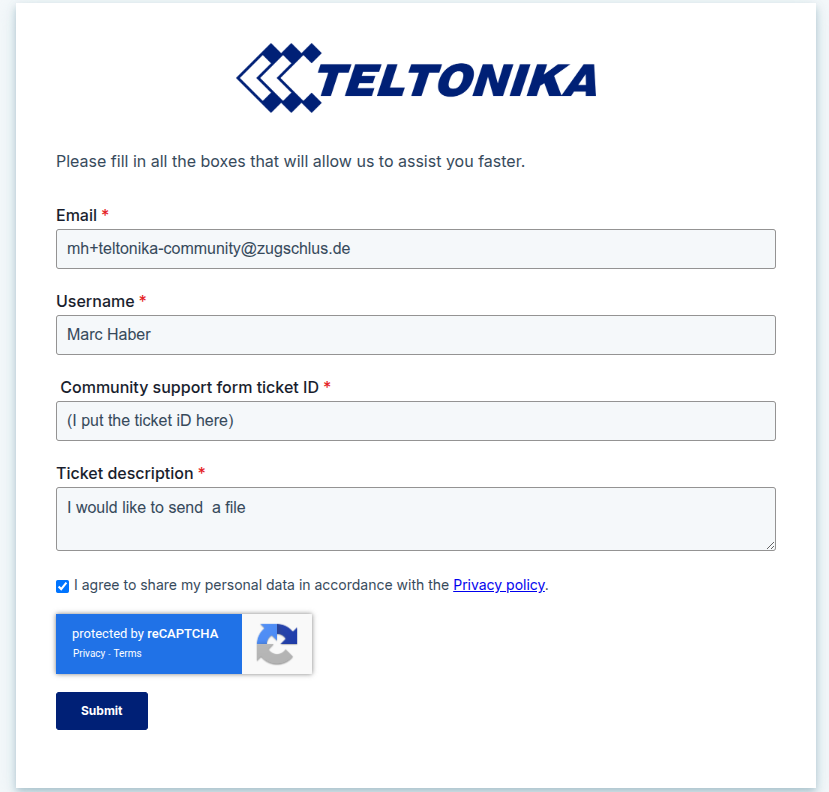

For troubleshooting purposes, we will require more sensitive information from your end, such as the troubleshoot file, which may contain passwords, public IP addresses, serial numbers, and such. To avoid leaking this information, we have sent you a form to fill out, which you will receive in your e-mail inbox that you have registered your account with in the forums. In the Ticket ID field of the form, please enter the ID of this thread, which is 16032.
Sorry for being stupid and sending an empty form. I expected the next page of the form have an upload button of some kind, but in fact it is a one-page form.

This is the web form you sent me on October 30, I don’t see an “upload file” button.
When I click on submit, I go through the hell of reCAPTCHA and then it just says “thank you for submitting the support form”, probably with having sent an empty form. What am I doing wrong here?

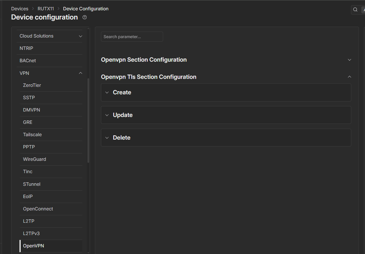

As there is no possibility to select a certificate that is already on the device when configuring OpenVPN from the RMS (see Configure OpenVPN Client via RMS when key material is already there - #3 by Justinas ), I am now configuring my OpenVPN connections via WebUI and have thus not encountered this issue any more. I guess this was just a beginner kind of “holding things wrong” and I will revisit this issue once it has become possible to configure an OpenVPN connection via the RMS.
