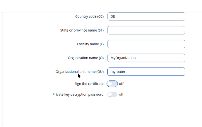

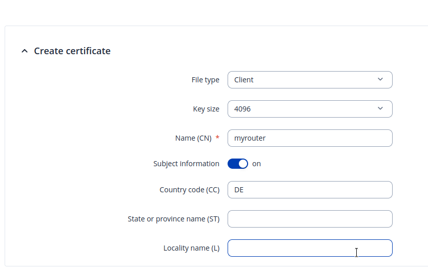

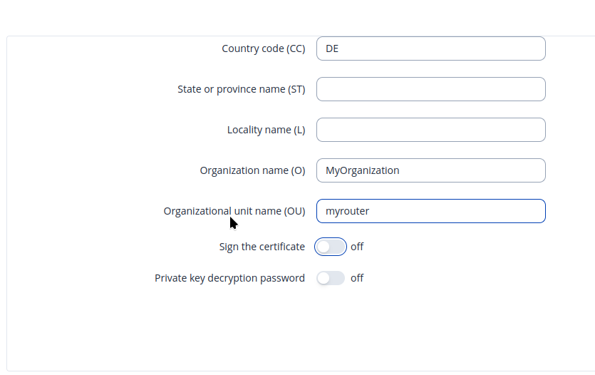

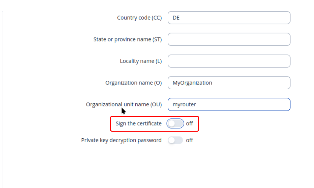

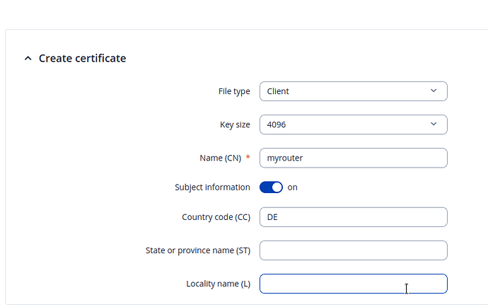

Since I need to make some progress, I now use the RMS to access my remote device’s WebUI, doing things manually. I used System => Administration => Certificate to generate a certificate request for a client certificate and a corresponding private key:
Note that “Private key decryption password” is “Off”. We’ll need that information later.
After clicking on “Create”, the device worked for a minute and then showed the key and the certificate request:

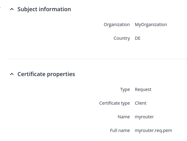

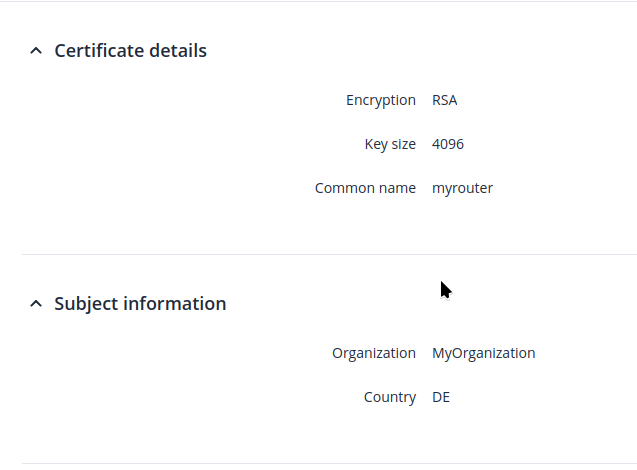

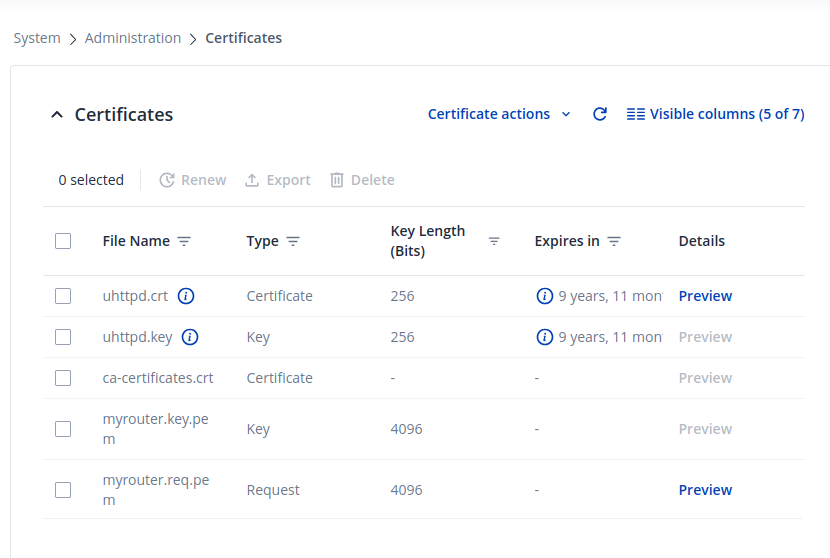

Clicking on Preview shows sensible data, but not the certificate request itself:

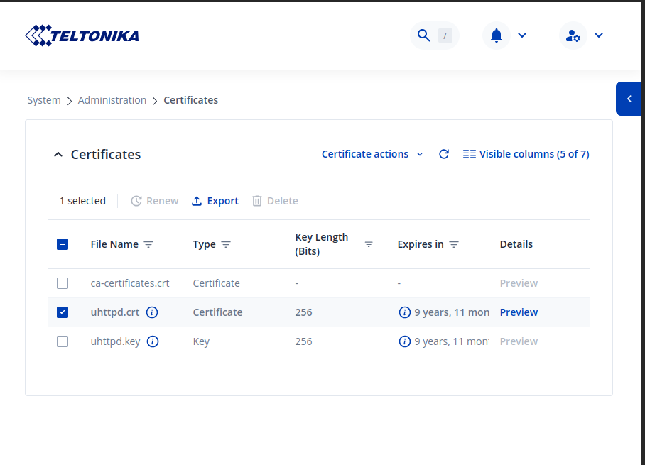

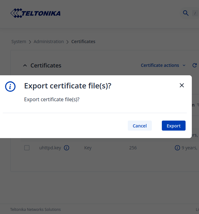

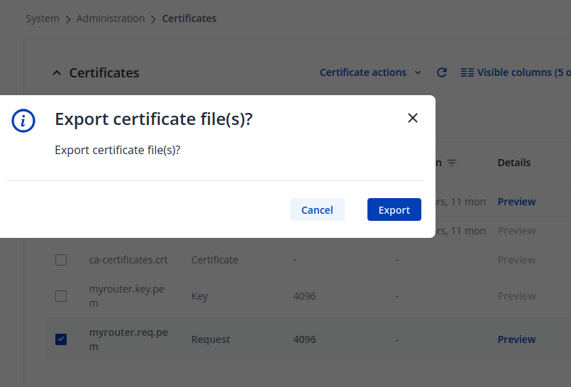

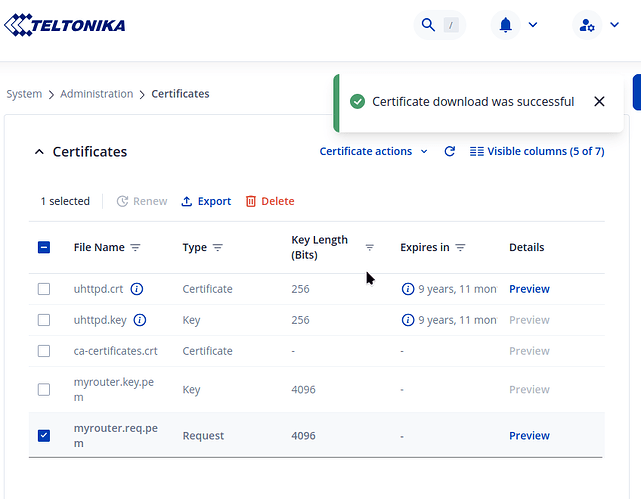

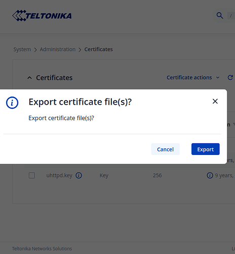

I then click the checkbox of the certificate Request and “Export” from the menu line:

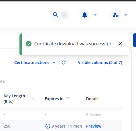

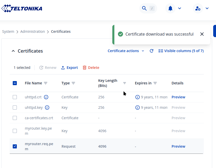

Browser now happily says “Certificate download was successful”.
But, my Browser didn’t download anything. The downloads directory is empty. It looks to me like the RMS is somehow “eating” my download.
When I log on the device’s WebUI directly without going through the RMS, download of the certificate request is successful immediately. But that’s a luxury that I don’t always have; most of my devices are behind a NAT devices that I cannot control, and therefore cannot connect directly to my devices. That’s why I am using the RMS in the first place!
Where is my download going to?

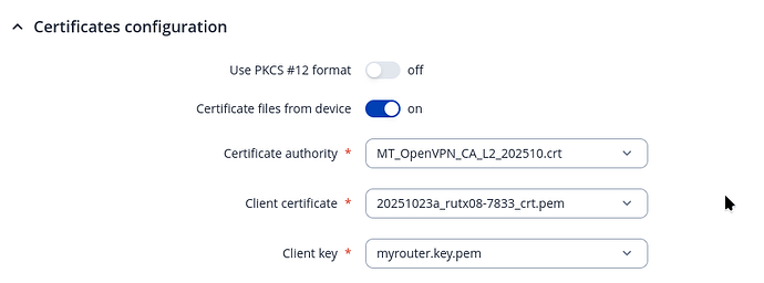

Now lets assume that everything was successful and I was able to create my OpenVPN configuration:
When I now enable the configuration, this appears in my log:

I have a sneaking suspicion that the errors you’re getting are due to the fact, that you didn’t sign your certificate, judging from the screenshots:
Could you perhaps try & re-generate it, but this time make sure the “Sign the certificate” option is enabled?
I didn’t sign the certificate on the device since I have an external Certificate Authority. The device generated a Certificate Request (myrouter.REQ.pem) which I downloaded and then signed with my external Certificate Authority, yielding the file 20251023_rutx08-7833_CRT.pem which I uploaded to the device again and selected when creating the OpenVPN connection. This is the normal way of handling X509 certificates when you have an external CA.
I found a workaround: If I put a password on the generated private key, then OpenVPN can use the key when I enter the same password in the OpenVPN configuration. That doesn’t make sense, so it is really just a workaround.
So, this is now a bug report: If a private key is generated on the device and the optional switch “Private Key Decryption Password” remains at its default (off) during key generation, the generated key is not useable in an OpenVPN configuration later.

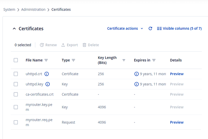

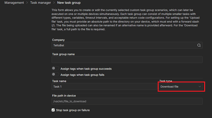

When I access the device’s web UI via the RMS, downloads initiated from the device seem to go to a place where I cannot access them. Where do they go? See Picture 1 where I exported a certificate and don’t find that file anywhere. Maybe that file should show up in “Recent device files”? Maybe there should be a download option in Actions/Actions where I also can export backups, event logs and troubleshoot files?
Picture 1:

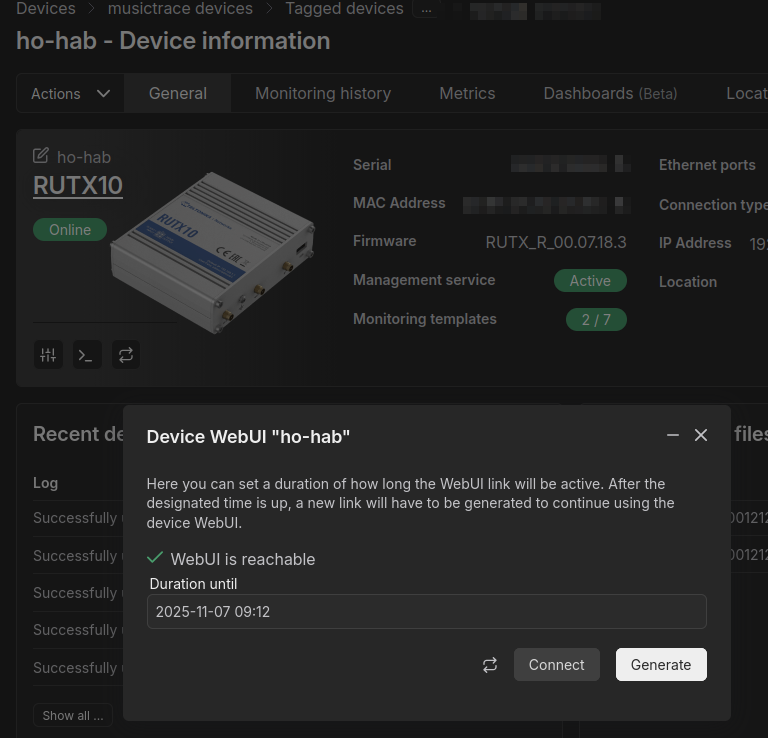

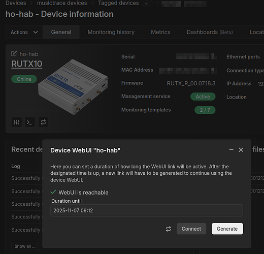

Found another workaround. When accessing the WebUI, I have always punched the “Connect” button:
Then the WebUI opens as kind of sub-window to the RMS and downloads go “somewhere”.
But you can also copy the link:
and paste the link into a different browser tab. That will open the WebUI of the target device in its dedicated windows, and downloads work.
I still would like to know the comment of your development people, but I’m fine for now with this way.

We’ve attempted to test this on multiple different Web Browsers and were unable to reproduce the issue of being unable to download the certificate files. Perhaps, if possible, could you try using a different Web browser to see if the issue persists? Or could there be possible restrictions set on your computer/browser that don’t allow these downloads to happen properly?

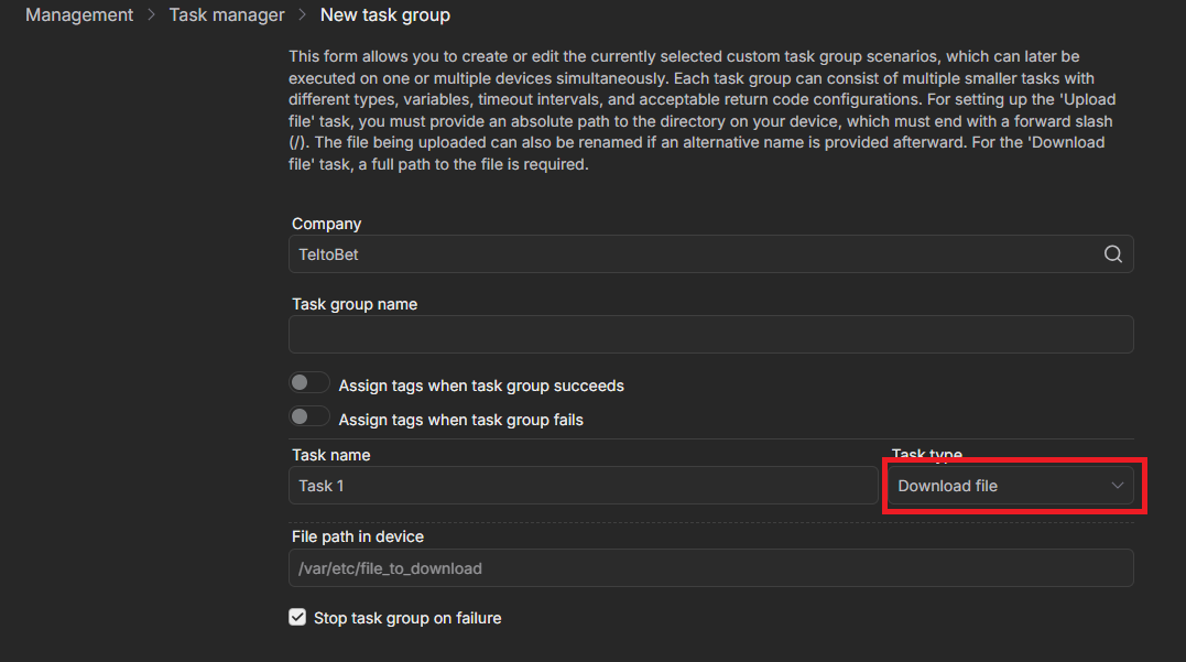

Additionally, I can suggest downloading/exporting such files through the use of Task Manager:
You can do so by specifying the file location.
You’re right. It works in Chromium. It doesn’t work in Firefox (on Linux).
