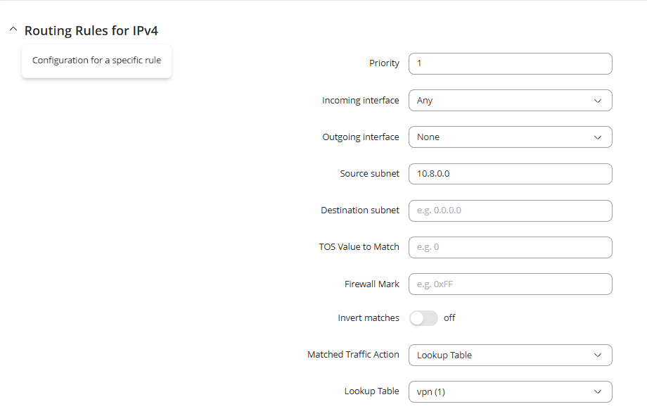

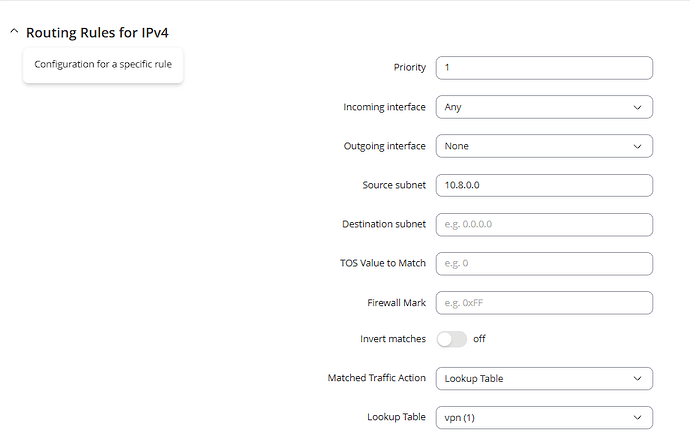

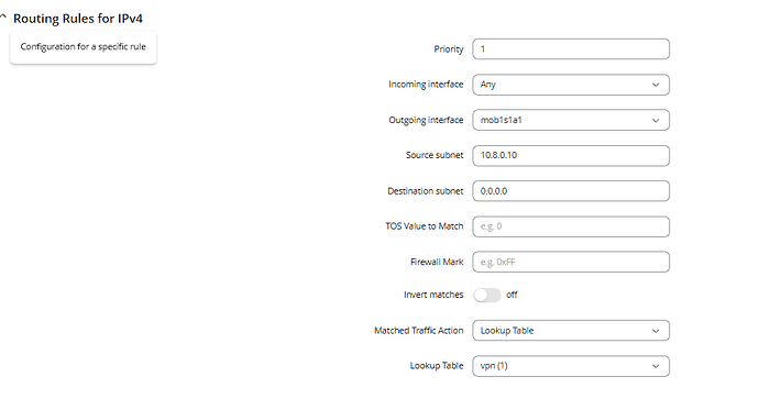

police
routing rule

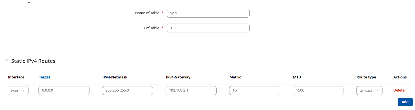

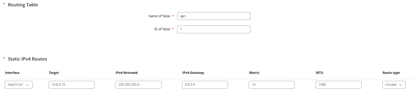

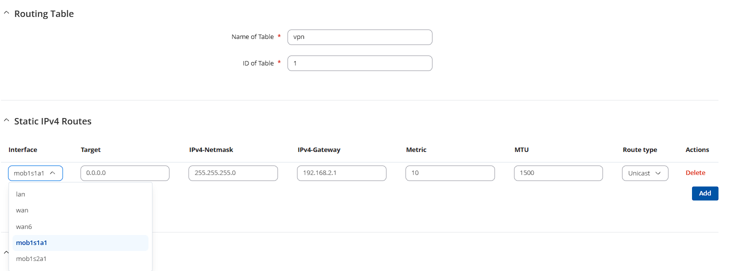

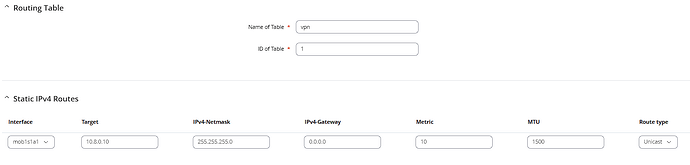

From the first view, the created static route is a bit incorrect:
  1. For interface, the VPN client’s interface should be selected;
  2. For target and netmask – 0.0.0.0;
  3. Gateway should be the mobile WAN IP.
Then, in the routing rule:
  • The Incoming interface is logical interface where the client resides.;
  • Outgoing interface – leave empty;
  • Source subnet – specify the IP address of the VPN client.
  • Destination subnet – can be left empty;
  • Lookup Table – ID of routing table (1), correct.
Check these points and let me know how it goes.
At the moment, I’m testing on a local machine.
The VPN is working well, but client can’t get a mobile IP for the internet connection.
Same result.
I tried every possible combination with the interface.
Same result.
