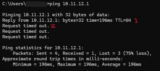

Here’s an example of how VPN failed for D6 in those cases.
This can be explained with the tcpdump of the D6 RUTX10:
– Ping request 1
10:45:29.674344 tun_c_rms_tv3AU In IP 192.168.255.10 > 10.11.12.1: ICMP echo request, id 1, seq 107, length 40
10:45:29.674628 tun_c_rms_tv3AU Out IP 10.11.12.1 > 192.168.255.10: ICMP echo reply, id 1, seq 107, length 40
– Ping request 2
10:45:30.696021 tun_c_rms_tv3AU In IP 192.168.255.10 > 10.11.12.1: ICMP echo request, id 1, seq 108, length 40
10:45:30.696236 tun_c_rms_KhymH Out IP 10.11.12.1 > 192.168.255.10: ICMP echo reply, id 1, seq 108, length 40
As you can see the failed ‘ping request 2’ tries to respond over the wrong VPN tunnel (KhymH instead of tv3AU). This is because D6 has 2 VPN client configurations, the one from D5 (KhymH) and the one from D6 (tv3AU).
