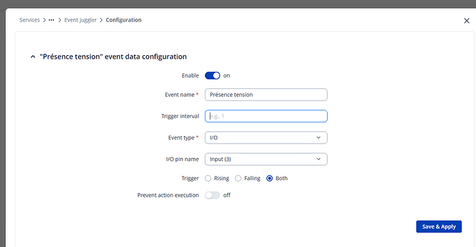

Thank you for your reply. Here is the information used:

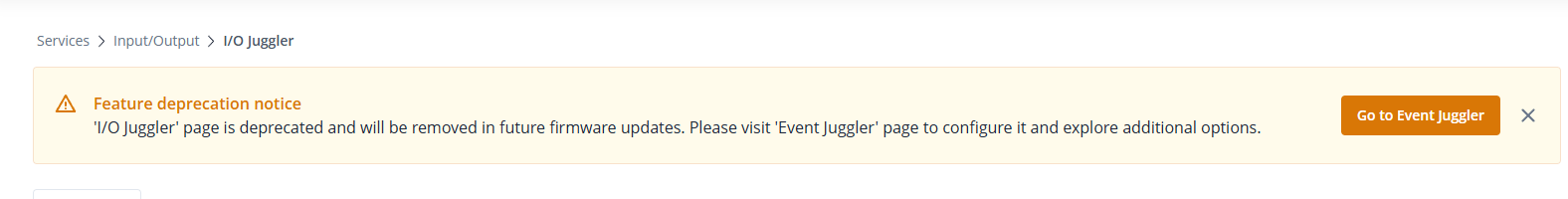

I am using Event Juggler (I/O Juggler will be removed in upcoming firmware versions).
In the Trigger interval field, I did not enter anything; the field is left blank.
Thank you for your message.
Have you tried configuring a trigger interval, for example, setting it to 5 seconds? In this case, the condition must remain met for the full 5 seconds before the SMS is triggered.
Please let me know whether this helps or if the issue persists.
