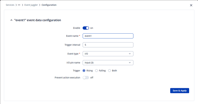

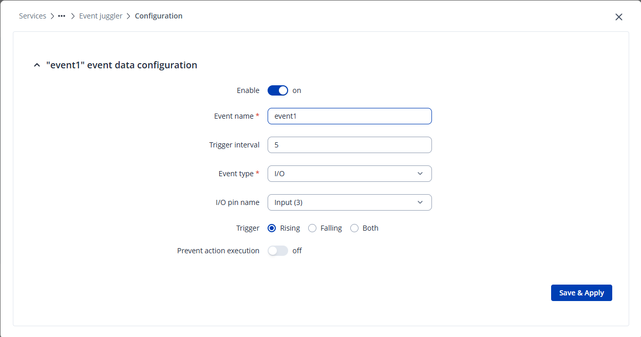

a)My first improvement was to add a “Trigger Interval” of 5s. This leads to one SMS will be sent when applying 24V to the input and also one SMS when removing the 24V from the input. Still i have the one SMS on the falling edge which is not my intention.
I also tried several approaches with conditions and delays, but nothing fullfilled my original desire: Just one SMS on rising edge.

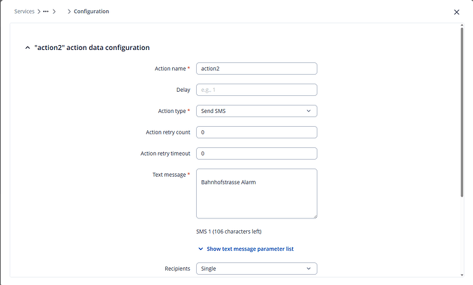

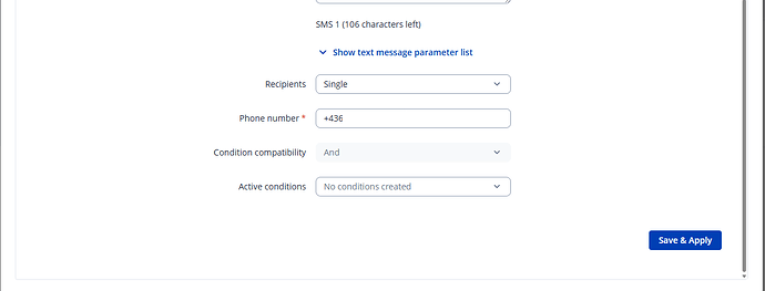

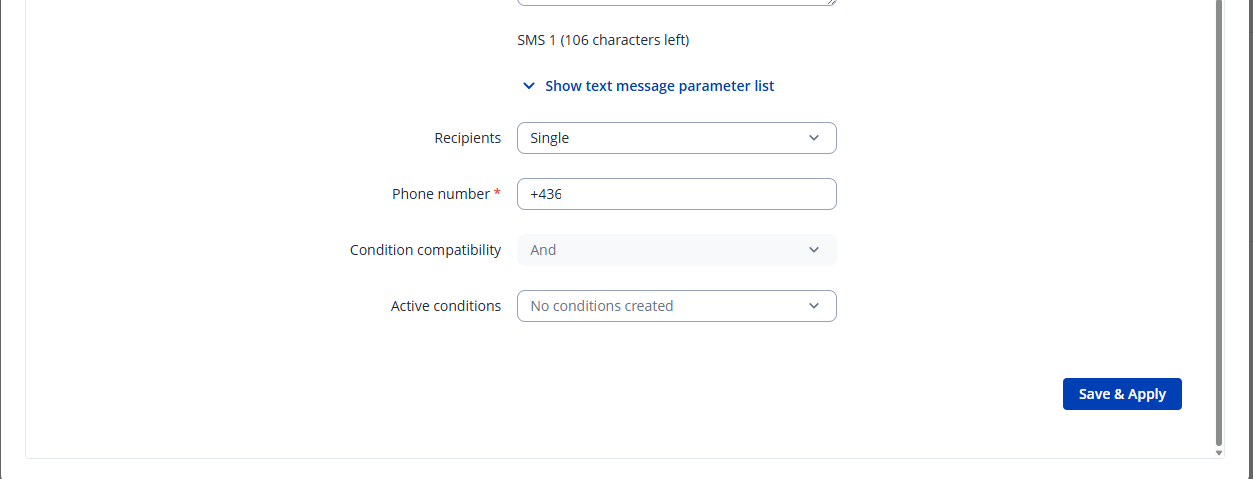

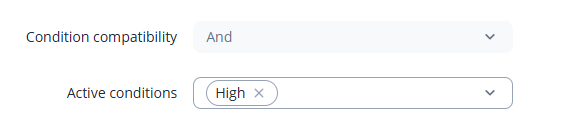

My settings:
event1:
action

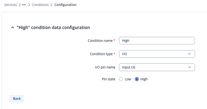

Have you tried adding a condition to check whether the pin state is high when the event is triggered?
You can then link this condition to the SMS action
I have tried also the combination that you have mentioned. Did not work as expected.
If I want to detect a positive edge, from my point of view, I should check if the status is “low” and in this state check if there is a positive edge? I have read several threads which describe in state “high” check for positive edge. But in my logical understanding this would not work if I just get one positive edge?
But I tried both, in state “low” and also in state “high”, to check for the rising edge. No try fullfilled the original requirement. Like I wrote, the best workaround solution is to get 1 SMS on rising edge and also 1 SMS on falling edge.
