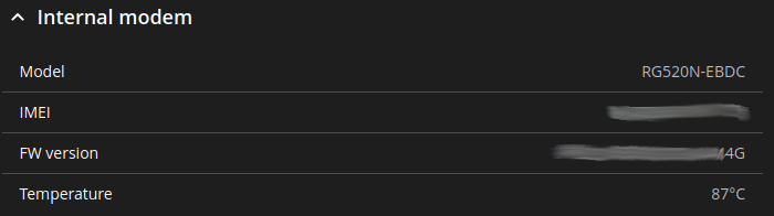

While investigating slow speeds that started about 2-3 weeks ago, I noticed that carrier aggregation is also marked as “inactive” and my modem temperature was quite high.
I’m using an OTD500 and I’m located in Athens Greece.
More details in my thread here:
At least temperature seems normal on RUTX50. I am also in Athens.
