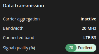

Another weird thing, carrier aggregation is not working…
(yes, it was working before I flashed the latest firmware)

I tried the new firmware OTD5_R_00.07.23.7 which corrected the carrier aggregation problem.
Unfortunately, it did not correct the modem high temperature, today its at 95 °C :hot_face:
